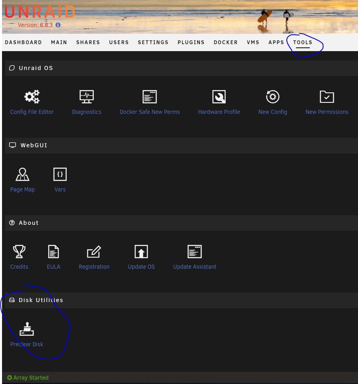

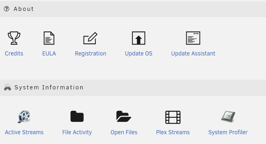

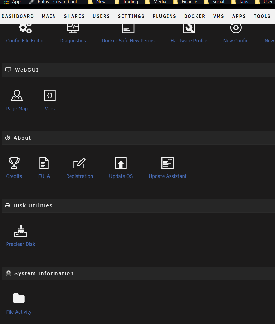

Is there a way to get this to show up in the Unraid GUI?  I'm assuming it should show up under Tools/Disk Utilities but there is no icon there.
I can get to it through the plugins section or by going directly to http://*.*.*.*./Tools/FileActivity so it's not such a huge issue, just would like it to be there to easily click on when needed.  Thanks for any info.
There is no Disk Utilities under Tools. Where are you seeing that?
File Activity is under Tools - System Information just as it says in the first post of this thread.
This is what I'm seeing, thanks.
Interesting.
I don't have preclear installed so I guess it creates that category. Maybe some other plugin you don't have installed creates the System Information category.
yea interesting.  I'll try installing one of the plugins you have and see what happens :)
I just released an update to fix this issue.
Awesome!  Success :)
