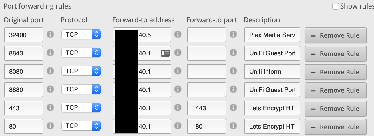

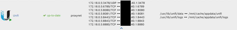

Hello, im really struggling to get a Remote / Central Unifi set up. I have a controller which I have connected to my local AP's and this works fine.
Im trying to use the same controller with remote AP's at a client location but the AP's can't seem to connect to the controller - I am using LetsEncrypt with Nginx for SSL on the controller front end and this works no problem.
I have a Ubiquiti edge router X and I have forwarded port 8080 onto my Unraid server port 8080 - but it doesn't seem to be getting through?
 Here is a screenshot of my EdgeRouter X Port Forwarding:
And here is a screenshot of my UNRAID Docker Configuration:
I also have the same issue with the guest portal. If I want to use a specified host name (my DDNS) it doesn't connect. - but using ip (when on the same network) will.
