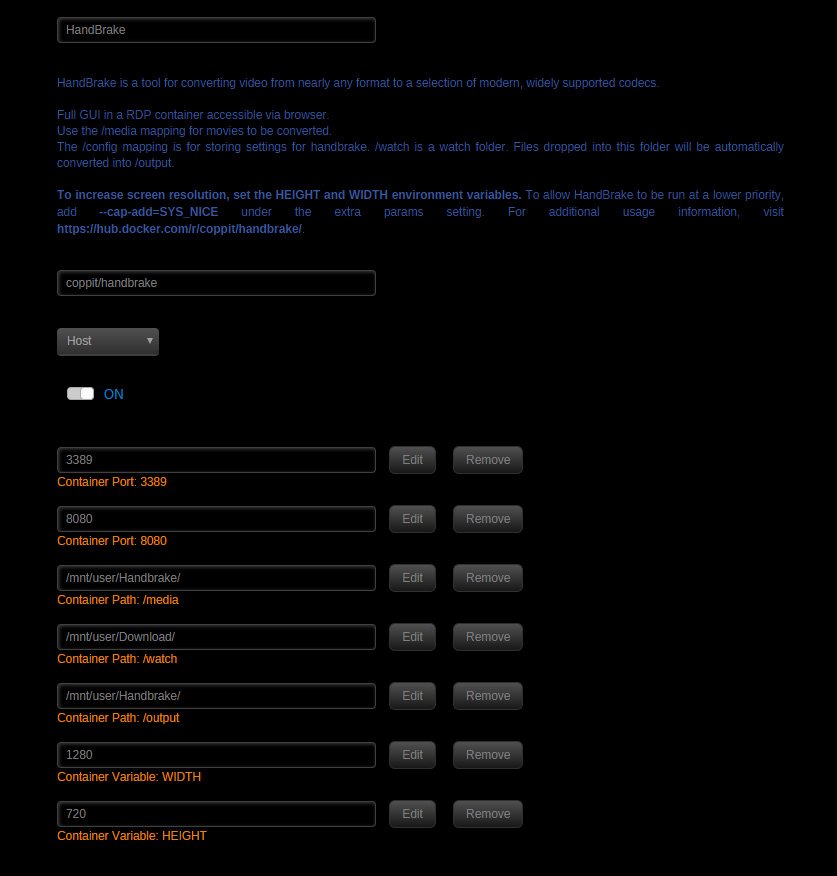

after an update, the container don't want to launch the ui: ERR_CONNECTION_REFUSED
unraid 6.5.2

docker inspect add8b5d689fc
        "Id": "add8b5d689fcac026f7b48211fd0ad1007febf7e6acd8052342ad7ae7aab6fff",
        "Created": "2018-06-03T16:43:45.439020761Z",
        "Path": "/sbin/my_init",
        "Args": [],
        "State": {
            "Status": "running",
            "Running": true,
            "Paused": false,
            "Restarting": false,
            "OOMKilled": false,
            "Dead": false,
            "Pid": 3779,
            "ExitCode": 0,
            "Error": "",
            "StartedAt": "2018-06-03T16:43:45.774233784Z",
            "FinishedAt": "0001-01-01T00:00:00Z"
        "Image": "sha256:6ee72cef2e05a4daf299b491f90602241cd45e3c099e4b45e0291e7f4bd35fbb",
        "ResolvConfPath": "/var/lib/docker/containers/add8b5d689fcac026f7b48211fd0ad1007febf7e6acd8052342ad7ae7aab6fff/resolv.conf",
        "HostnamePath": "/var/lib/docker/containers/add8b5d689fcac026f7b48211fd0ad1007febf7e6acd8052342ad7ae7aab6fff/hostname",
        "HostsPath": "/var/lib/docker/containers/add8b5d689fcac026f7b48211fd0ad1007febf7e6acd8052342ad7ae7aab6fff/hosts",
        "LogPath": "/var/lib/docker/containers/add8b5d689fcac026f7b48211fd0ad1007febf7e6acd8052342ad7ae7aab6fff/add8b5d689fcac026f7b48211fd0ad1007febf7e6acd8052342ad7ae7aab6fff-json.log",
        "Name": "/HandBrake",
        "RestartCount": 0,
        "Driver": "btrfs",
        "Platform": "linux",
        "MountLabel": "",
        "ProcessLabel": "",
        "AppArmorProfile": "",
        "ExecIDs": [
            "31f88215922aaa5528bd91f207a6e090c0f7833a51e52278bedfe7024241e8e3"
        "HostConfig": {
            "Binds": [
                "/mnt/user/Download/:/watch:ro",
                "/mnt/user/Handbrake/:/output:rw",
                "/mnt/user/appdata/HandBrake:/config:rw",
                "/mnt/user/Handbrake/:/media:rw"
            "ContainerIDFile": "",
            "LogConfig": {
                "Type": "json-file",
                "Config": {}
            "NetworkMode": "host",
            "PortBindings": {},
            "RestartPolicy": {
                "Name": "no",
                "MaximumRetryCount": 0
            "AutoRemove": false,
            "VolumeDriver": "",
            "VolumesFrom": null,
            "CapAdd": [
                "SYS_NICE"
            "CapDrop": null,
            "Dns": [],
            "DnsOptions": [],
            "DnsSearch": [],
            "ExtraHosts": null,
            "GroupAdd": null,
            "IpcMode": "shareable",
            "Cgroup": "",
            "Links": null,
            "OomScoreAdj": 0,
            "PidMode": "",
            "Privileged": true,
            "PublishAllPorts": false,
            "ReadonlyRootfs": false,
            "SecurityOpt": [
                "label=disable"
            "UTSMode": "",
            "UsernsMode": "",
            "ShmSize": 67108864,
            "Runtime": "runc",
            "ConsoleSize": [
                0,
                0
            "Isolation": "",
            "CpuShares": 0,
            "Memory": 0,
            "NanoCpus": 0,
            "CgroupParent": "",
            "BlkioWeight": 0,
            "BlkioWeightDevice": [],
            "BlkioDeviceReadBps": null,
            "BlkioDeviceWriteBps": null,
            "BlkioDeviceReadIOps": null,
            "BlkioDeviceWriteIOps": null,
            "CpuPeriod": 0,
            "CpuQuota": 0,
            "CpuRealtimePeriod": 0,
            "CpuRealtimeRuntime": 0,
            "CpusetCpus": "",
            "CpusetMems": "",
            "Devices": [],
            "DeviceCgroupRules": null,
            "DiskQuota": 0,
            "KernelMemory": 0,
            "MemoryReservation": 0,
            "MemorySwap": 0,
            "MemorySwappiness": null,
            "OomKillDisable": false,
            "PidsLimit": 0,
            "Ulimits": null,
            "CpuCount": 0,
            "CpuPercent": 0,
            "IOMaximumIOps": 0,
            "IOMaximumBandwidth": 0
        "GraphDriver": {
            "Data": null,
            "Name": "btrfs"
        "Mounts": [
                "Type": "bind",
                "Source": "/mnt/user/Download",
                "Destination": "/watch",
                "Mode": "ro",
                "RW": false,
                "Propagation": "rprivate"
                "Type": "bind",
                "Source": "/mnt/user/Handbrake",
                "Destination": "/output",
                "Mode": "rw",
                "RW": true,
                "Type": "bind",
                "Source": "/mnt/user/appdata/HandBrake",
                "Destination": "/config",
                "Mode": "rw",
                "RW": true,
                "Type": "bind",
                "Destination": "/media",
                "Mode": "rw",
                "RW": true,
        "Config": {
            "Hostname": "THE-BEAST",
            "Domainname": "",
            "User": "",
            "AttachStdin": false,
            "AttachStdout": false,
            "AttachStderr": false,
            "ExposedPorts": {
                "3389/tcp": {},
                "8080/tcp": {}
            "Tty": false,
            "OpenStdin": false,
            "StdinOnce": false,
            "Env": [
                "WIDTH=1280",
                "HEIGHT=720",
                "TZ=America/New_York",
                "HOST_OS=unRAID",
                "TCP_PORT_3389=3389",
                "TCP_PORT_8080=8080",
                "PATH=/usr/local/sbin:/usr/local/bin:/usr/sbin:/usr/bin:/sbin:/bin",
                "HOME=/root",
                "LC_ALL=en_US.UTF-8",
                "LANG=en_US.UTF-8",
                "LANGUAGE=en_US:en",
                "TERM=xterm",
                "APP_NAME=HandBrake",
                "DEBIAN_FRONTEND=noninteractive"
            "Cmd": [
                "/sbin/my_init"
            "ArgsEscaped": true,
            "Image": "coppit/handbrake",
            "Volumes": {
                "/config": {},
                "/media": {},
                "/output": {},
                "/watch": {}
            "WorkingDir": "",
            "Entrypoint": null,
            "OnBuild": null,
            "Labels": {}
        "NetworkSettings": {
            "Bridge": "",
            "SandboxID": "79f571f34911c73876126a536b568ae602bb5b5f94c5792be3ebc3598b959298",
            "HairpinMode": false,
            "LinkLocalIPv6Address": "",
            "LinkLocalIPv6PrefixLen": 0,
            "Ports": {},
            "SandboxKey": "/var/run/docker/netns/default",
            "SecondaryIPAddresses": null,
            "SecondaryIPv6Addresses": null,
            "EndpointID": "",
            "Gateway": "",
            "GlobalIPv6Address": "",
            "GlobalIPv6PrefixLen": 0,
            "IPAddress": "",
            "IPPrefixLen": 0,
            "IPv6Gateway": "",
            "MacAddress": "",
            "Networks": {
                "host": {
                    "IPAMConfig": null,
                    "Links": null,
                    "Aliases": null,
                    "NetworkID": "46a4352196162a476e06defc47c5d336e8231129ffe2639fa987618d8ca16776",
                    "EndpointID": "2c5e58b5334457bdf8f6fae7afbcfcd90bf17db357b0ffa40b899dbd9a817dba",
                    "Gateway": "",
                    "IPAddress": "",
                    "IPPrefixLen": 0,
                    "IPv6Gateway": "",
                    "MacAddress": "",
                    "DriverOpts": null
Edited by ibasaw

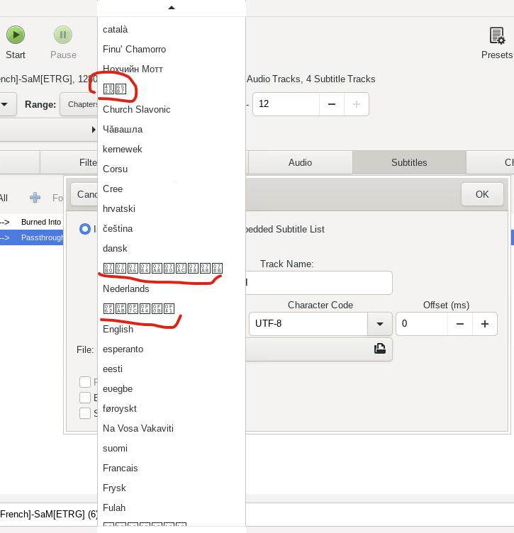

My subtitle language select option is not displayed properly. What am I missing?
