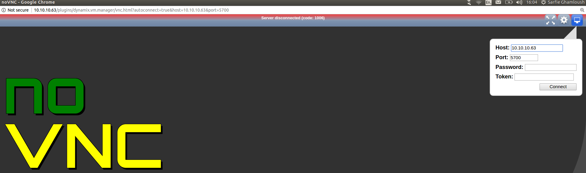

Doesn't seem to work for me at all, any recommendations/advice. screen shot added...5936c540ddfb7_Screenshotfrom2017-06-0616-04-27.thumb.png.1b93f5b6be304b90ea6aa62e477f7e4c.png
Same problem. Tried Server name, ip, http, https etc... no change.
I don't think you are accessing the UI on the http or https://tower links as in my tests it redirects correctly.
Take a look at my last post on the following thread, as I give examples of how accessing the UI over http or https with and without the hostname gave me different results. Also if you take the URL that is failing from your address bar in the screen shot and replace the IP with tower VNC should connect as long as tower resolves on your network.
Just added a host name to IP address on my ubuntu box for my unraid server and it does indeed now work using the dns name! However, I have a lot of machines on my internal home network and no internal dns server as I simply do not need internal dns at home. For me personally I would 100% prefer it work with IP address first and foremost with internal dns as a nice to have but certainly not necessary to use web vnc functionality, Thanks for your reply and info Tuft :)
@sarf so you get the same results from http and https?
I did not test prior to updating my hostname but afterwards I did notice that HTTPS was still working with WebVNC even though it did not show tower in the URL, maybe it was using it under the hood I've not verified.
Generally most home routers have the option to give a DNS name to systems locally on the lan. Do you use a router of some sort as your DNS or use Public DNS servers?
I've not tried this, but could register a FQDN pointing at your local LAN address. I could setup a subdomain for you to test with if you tell me the LAN IP of your server.
I just ran a few test's with the following results. All from my ubuntu workstation that now has name to IP entry for my local Unraid server.
http://(internal ip)/dashboard [click vm link fails]
http://(dns name)/dashboard [click vm link works]
https://(internal ip)/dashboard [click vm link works]
https://(dns name)/dashboard [click vm link fails]
Hopefully there will be a fix at some point so that the webvnc works in all scenarios.
