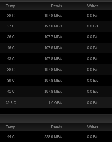

There are bottleneck on R/W, the disk array will ceiling at ~700MB/s, those can't overcome by reconstructive write mode.
Anyway, today just try 6.4rc2.
The 1st image show still have bottleneck, a parity protected array will max at 733MB, 4 data disks already reach the max, last disk got ~4.5MB/s).
With this limitation, the array write speed will also affect, it worse if more more data disks.
The 2nd image just show all disk / system could run in their max speed. ( 1.6GB/s + 224MB/s, parity check+cache disk read)
Never came across such bottleneck, but not quite sure I follow what's happening when you're hitting it, can you better explain what you're doing on the 1st screenshot?
