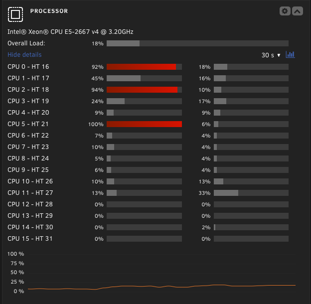

56 minutes ago, spl147 said:
this issue still persists in the latest release.
Do you see an increase in CPU usage (or do you see a high CPU usage while MakeMKV read the file) ?
Do you reproduce the issue with all kind of images ? I tried on my side with a standard DVD image and I didn't see a problem.
  • Replies 966
  • Views 215.6k
  • Note that there is currently an issue with the automatic disc ripper for people using the beta key (MakeMKV version is expired). A Docker image update will be available soon to address this.
  • Same thing as an internal drive.  In my case, the device is /dev/sr0, so I just add --device /dev/sr0 in extra parameters.
  • So maybe one solution is to add support for simultaneous disc ripping within the same container
not really no.
i have only tested it with .mkv remux of bluray and UHD bluray and bluray and UHD bluray folder rips
Edited by spl147
v.24.07.1 works as expected, issue starts with v.24.11.1 update to FFMPEG 5 and MakeMKV 1.17.8.
perhaps a ffmpeg issue or a MakeMKV issue
can we try building a MakeMKV 1.17.9 with FFMPEG 4 and a MakeMKV 1.17.7 with FFMPEG 5 for testing

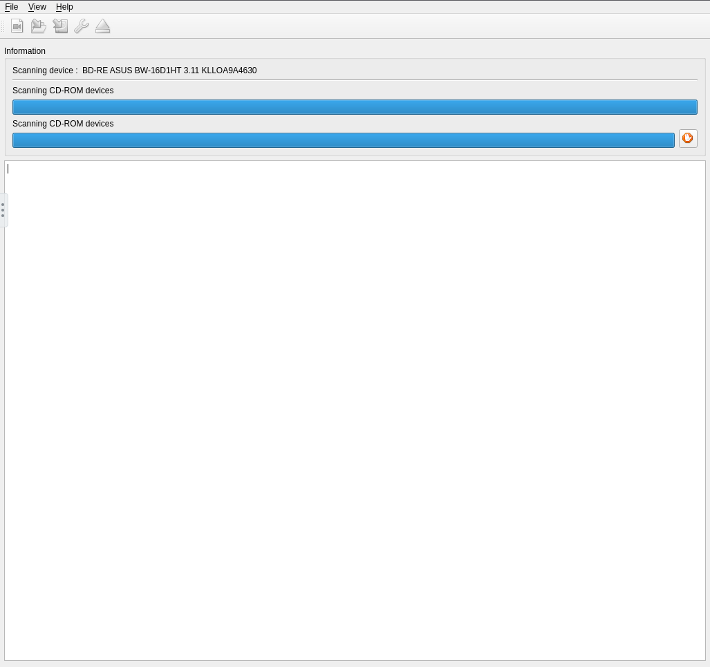

Can't seem to get this container to work, i've queried the drive info and added them to the setup as shown in the guide. So it can see the drive without a disc in it, but as soon as a disc is inserted it won't do anything more than loading. Using the web gui, can click stop, still loading, restart container still loading. Just seems to hang on this screen.
Drive/disk worked fine on windows, internal drive connected via sata
Drive not mounted and used in anything else to my knowledge, i.e no vms running, no other dockers running that would use it etc
Seems to be this known issue: https://forum.makemkv.com/forum/viewtopic.php?f=3&t=35897
Yep, there are a few posts about the later versions and linux on the forums so i had surmised as much. I pulled an older docker image and it worked perfectly. So it's seems an issue with Linux and the latest versions of MakeMKV. Nice to know it wasn't something i did in the setup.
MakeMKV 1.17.7 is the version that works for anyone that has the same issue

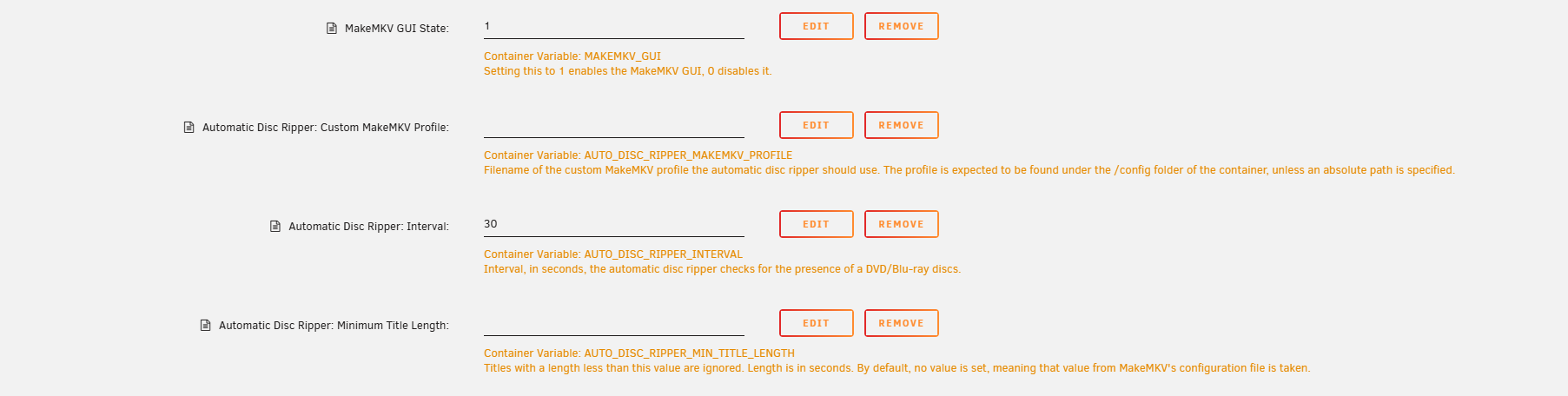

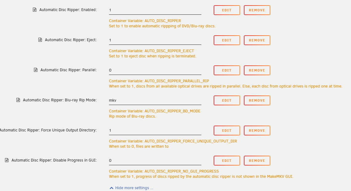

Quick question, did anyone manage to add a custom profile for auto ripping? I created one and uploaded it but when trying to create the variable for the container it doesn't do anything. I edit the Container and set AUTO_DISC_RIPPER_MAKEMKV_PROFILE to /config/profile.xml but when I run the container and run env I see it is still unset
I never manually made the profile not touched the .xml.
this works for me and my needs for auto ripping...
You may need to set other tempate options via the advance toggle and set settings...
as explainmed earlier in the forum...
jlesage/makemkv
I'm using the lattest repository and running 1.18
Somewhere in 1.17 there was a auto rip bug... as noted and fixed by adding the nobody home folder to the same path as the config folder.
This has been fixed int eh lattest release
auto rip is working for me
That's what I did, I set the variable for the config that I want the autoripper to use but within the container it still uses the standard config. Otherwise autoripping works fine but I'd like it to use my custom Config file
Can you check the output of "docker inspect MakeMKV" to confirm that the variable is properly set ?
Do you see any related message when ripping a disc ?
While ripping a disc, could your share the output of "ps" inside the container ?
Nevermind, my mistake was, that I didn't see the variable existed under the advanced settings so I added a new one. But apparently my custom variable was overwritten by the default one. If I add the config file to the already present entry for the variable it works.
