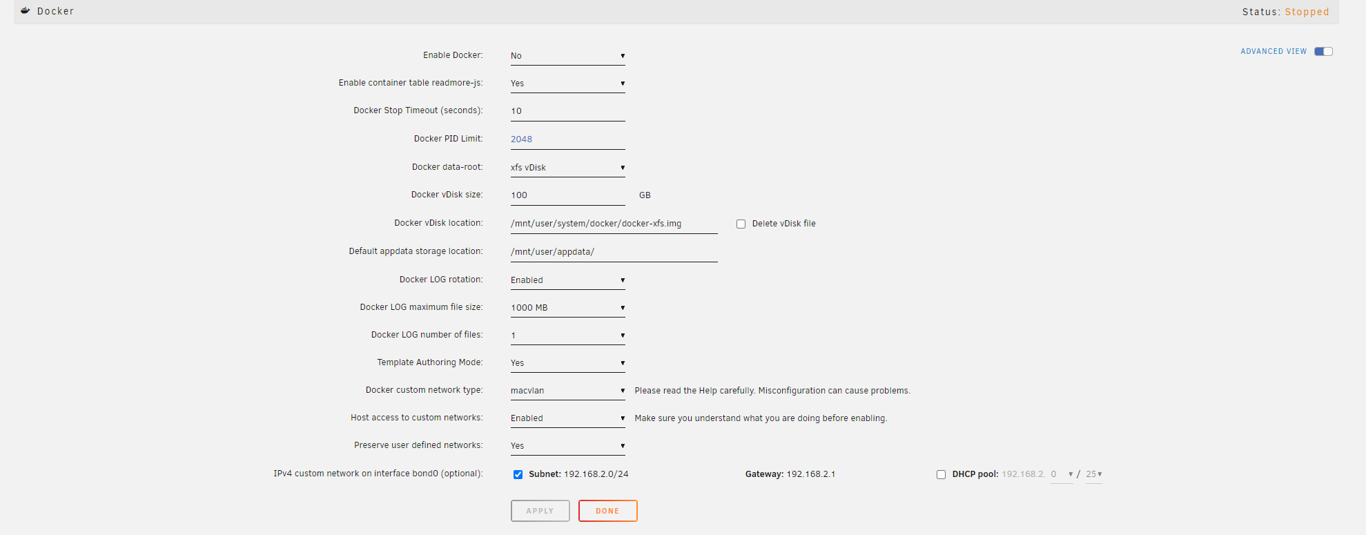

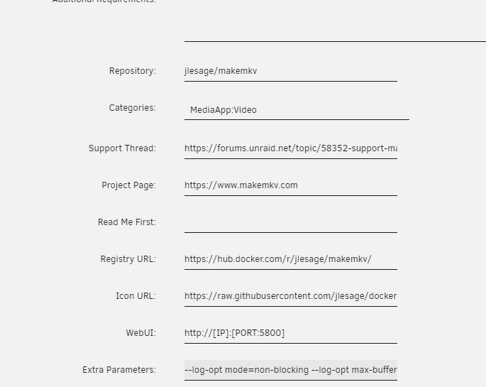

Is there a way to increase the amount of log lines displayed when selecting the Logs docker option of MakeMKV? Right now, it seems to only show the last 90 log lines. I know I can go view the full log under /var/lib/docker/containers/, but I was hoping to just increase the amount of viewable log lines from the Logs option. The reason I want to increase the number of displayed log lines is because the log is quickly rolling over when I start the container, and I lose the information regarding what optical drives it found so that I can determine the device IDs. I am planning to add a few more optical drives to my server and just want the process of looking up the device IDs to be a bit simpler vs. having to go look at the full log.
stop all dockers > then go to settings dockers disable docker >
With docker stopped. You now have accesses to the docker log settings. Increase docker log size. Apply and enable docker.
https://docs.docker.com/engine/logging/configure/
you may need to add extra parameters to add more logging options to the docker...
--log-opt mode=non-blocking --log-opt max-buffer-size=4m
It also sounds like you have log rotation on and the size set low.

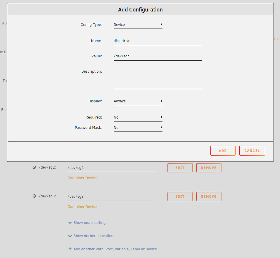

It best to jsut add the devices at the end to capture you optical disk drive:
click add at the bottom
you need 2 min sr0 and sg1
you can also look at unraid host and get the path to your disk drive.
root@BMM-Unraid:~# ls /dev/{cdrom,sr*,sg*}
/dev/cdrom@  /dev/sg0  /dev/sg1  /dev/sg2  /dev/sg3  /dev/sg4  /dev/sg5  /dev/sg6  /dev/sr0  /dev/sr1
root@BMM-Unraid:~#

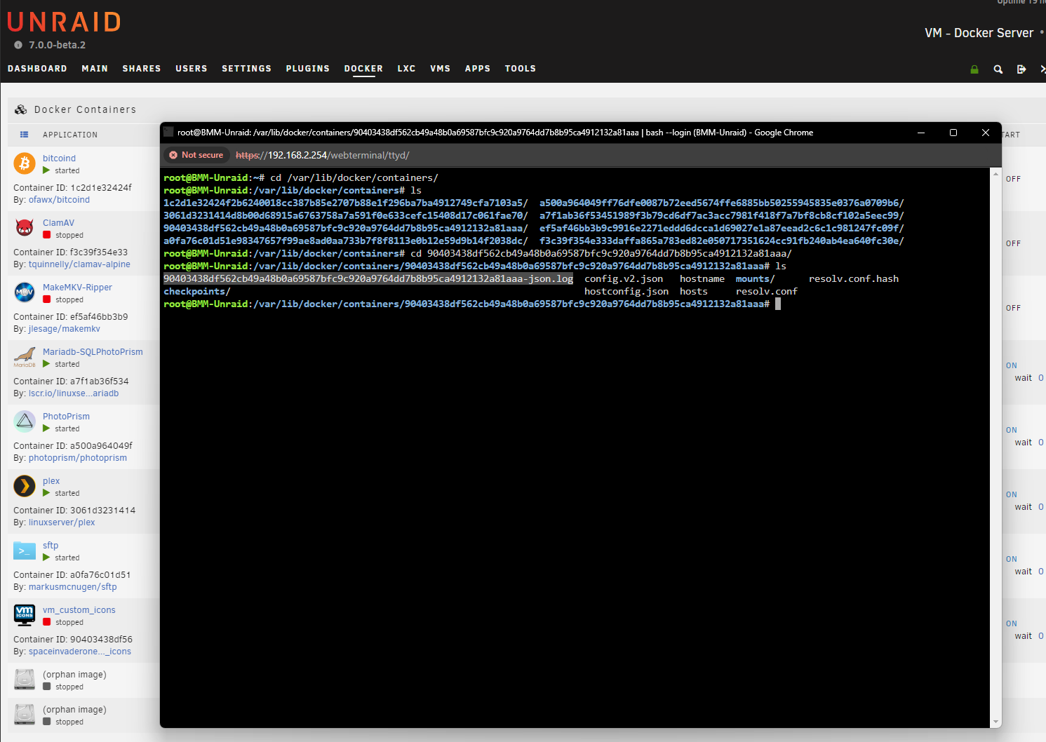

Thanks for the response. However, I think you misunderstood my problem. My log file sizes are fine. If I view them directly from /var/lib/docker/containers/, I can see the full log and all of the history. However, if view the log file by selecting MakeMKV from the Docker tab and selecting Logs, I can only see the last 90 files from the log. My problem is the amount of VIEWABLE log lines, not the total number of log lines in the log. With that said, this really isn't an issue for me anymore. Instead of looking at the log, I discovered I can view all of the optical drive info by just running the lsscsi -g command from the command line.
Edited by Rojma
The option doesn't really exist in the web ui... one could make a user script to accomplish this...
as you can see unraid devs chose 90 lines....
your probably fighting the unraid web ui default tail command and log number, then... php emhttp code some where. better asked as a separate topic.
https://www.papertrail.com/solution/tips/how-to-live-tail-docker-logs/
docker ps
docker logs --tail 100 <container ID>
Is the best I have for you, then. Other setting mentioned before play a role in how your previous docker log and lines it creates is stored and what to view within it...
Since you already know where the actual log data is stored. I would just tail that log file....
Edited by bmartino1

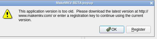

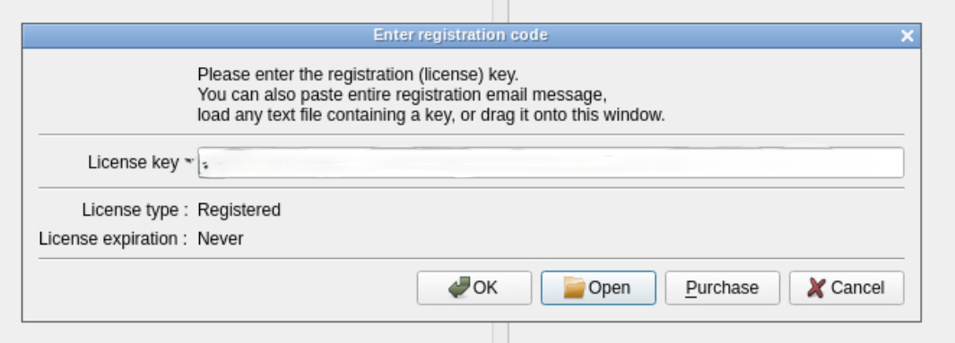

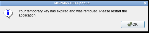

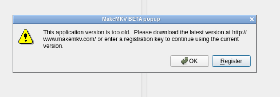

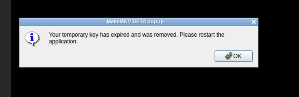

On 1/1/2024 at 5:54 PM, doctortt said:
Hi, it's the new year and the MakeMKV docker has stopped working. It was working a few days ago. Please see screenshot below.

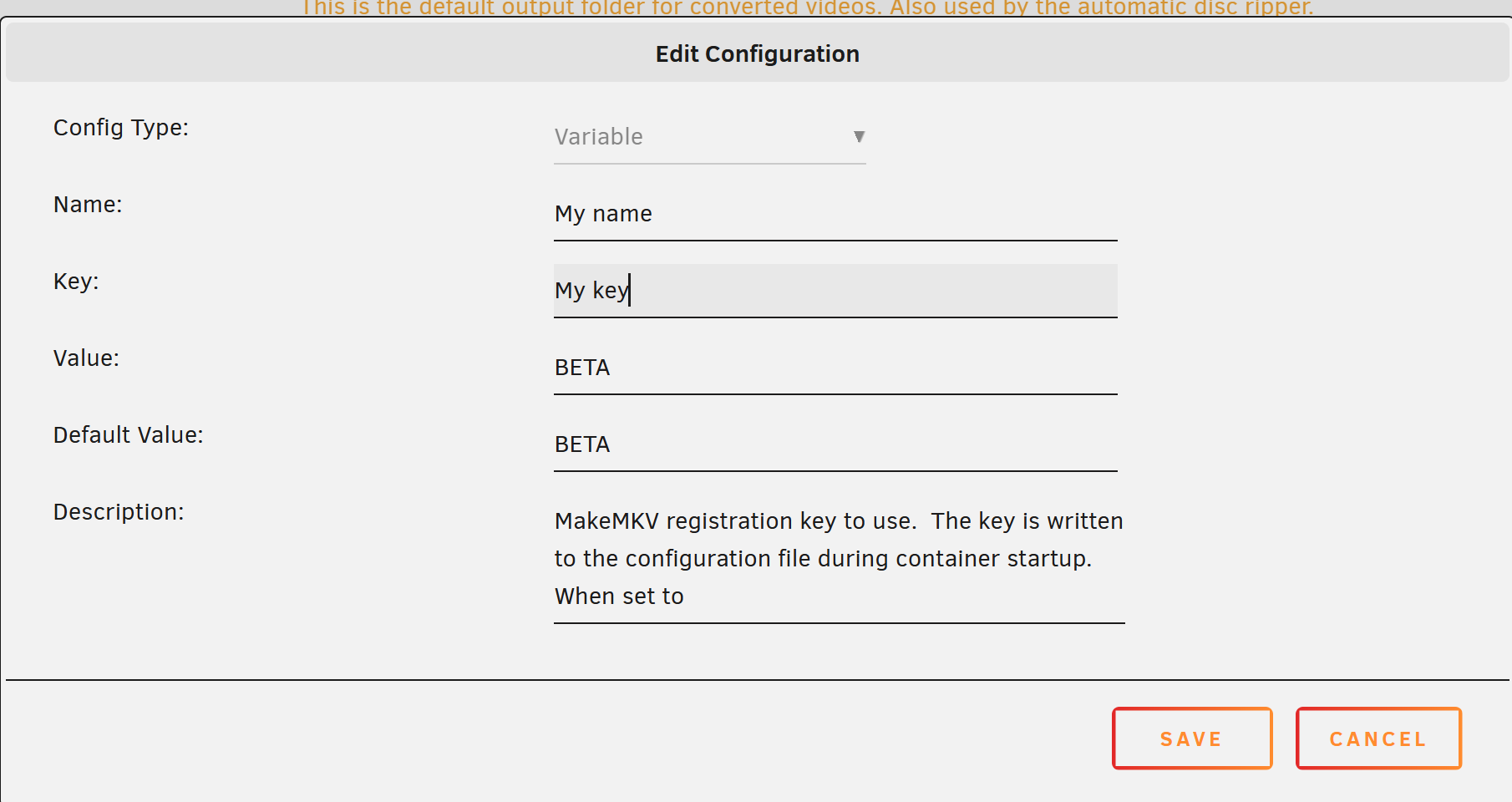

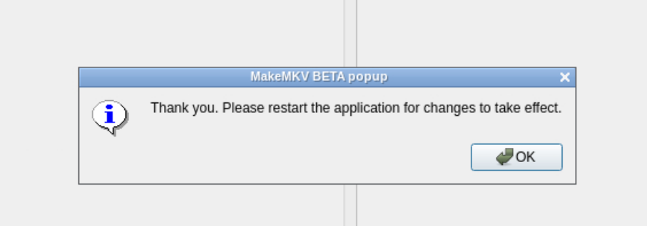

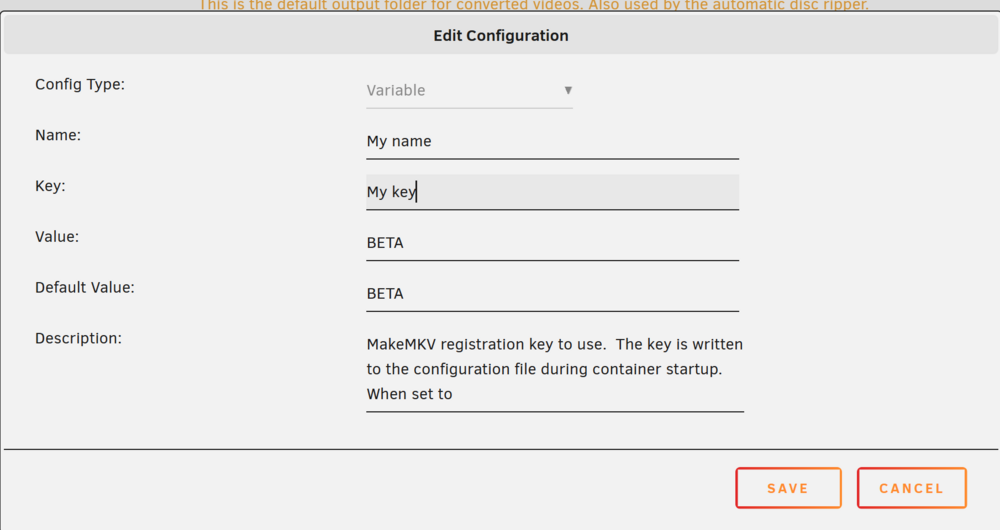

I get this to and makemkv simply stop working, even though I have lifetime key that I put in and it accepts it, but when I restart I get the same message my temporary key has expired and that the version is to old. Any ideas ?

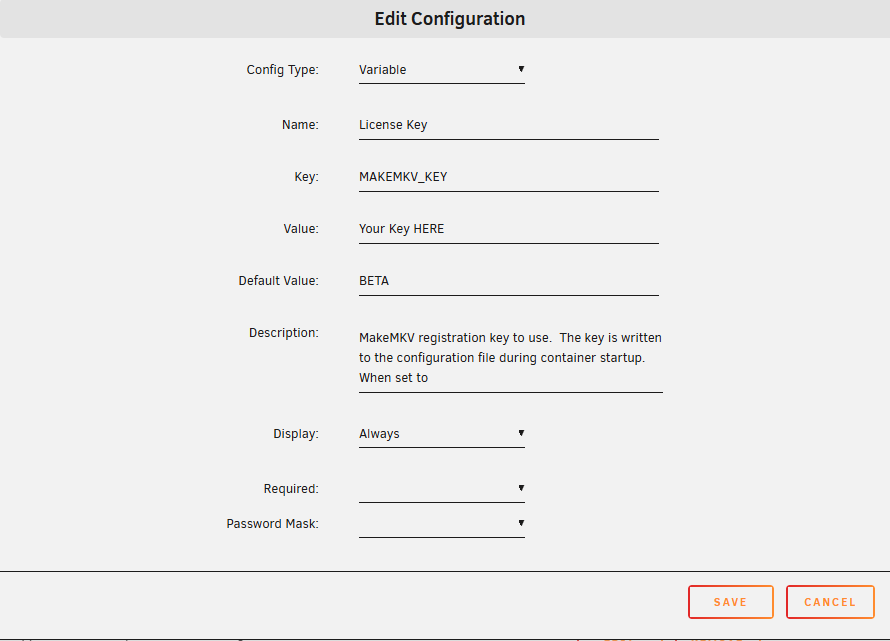

Did you add you license key to the "Licence Key:" field in container settings ^
Yes, I've added it to the field in the container settings and registered with my key in the app as well, and it accepts the key, but when I restart it, it does the same thing all over again.
Remove the docker and make sure you remove the makemkv image
you may need to also delete any existing appdata folder
then go to the docker tab. add container in the top drop down select makemkv(this has all of your settings and the key...) then apply to bring the docker back.
This sounds like a corruption issues within the docker image affecting the application. or that you adjusted setting in the app and didn't close it within the docker then docker stop start the container to bring it back....
Thank you for the suggestion, did it step by step, but made no difference. same exact messages pops up regardless. 😞
Doh, I used the incorrect field when pasting in my key... now it recognize my key and it works. I also got my optical drive recognized by adding the device in the container /dev/sr0 and /dev/sg0 and checking the privileged mode in the container.  Very happy, thank you!
root@BMM-Unraid:~#
Have more then 1 disk drive you can also run:
lshw -C disk
There is a much more simple way to figure this out, simply enter 'lsscsi -g' and get the following:
lsscsi -g
[9:0:0:0]    cd/dvd  HL-DT-ST BD-RE BU40N      1.03  /dev/sr0   /dev/sg6

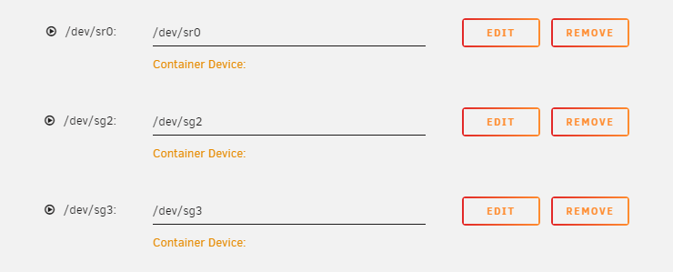

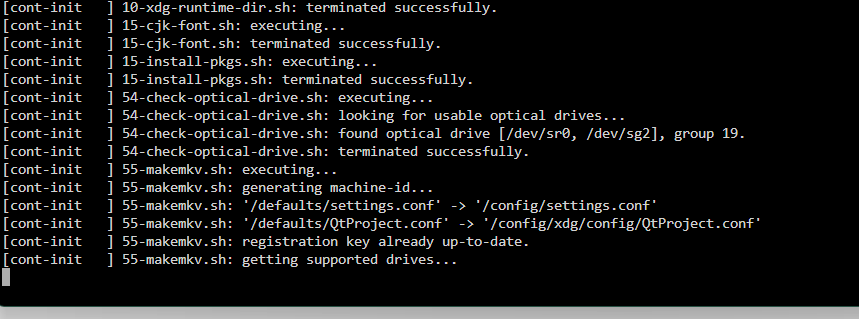

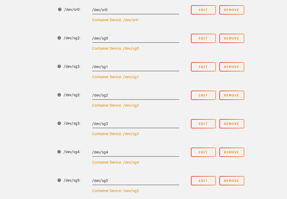

Hello! I recently swapped out my old CD/DVD drive fort a brand new Asus Blu-Ray drive for use with MakeMKV. However, when I try to load into docker container, I'm running into MakeMKV hanging on this line.
I've double-checked my routings, and they are correct (the default /sr0, /sg2), I'm running the latest version of the container, and I know the drive works, because I hooked it up to my Windows machine and it worked just fine there. Any ideas why this might be just sitting on this step?
Sorry if this has been answered before, but the only answers I've seen so far is to do with multiple BD drives which doesn't apply to me. I had my entire movie collection ripped to disk using anydvd many years ago - with file structure all intact. I'm slowly working my way through converting them all to mkv. Is there a way to run multiple instances of makemkv but converting disk to disk, not BD-ROM to disk. Thanks
there may be more then 3 /dev of sg# sr# you need to pass all of them...
in my case for 1 blue ray dirve i had to pass allof theses:
Just to give the followup, I needed to flash the firmware of my drive before it could be fully read by the system. I thought that was only if I was intending to do UHD discs but myh drive required it regardless. Just FYI for people in the future!
