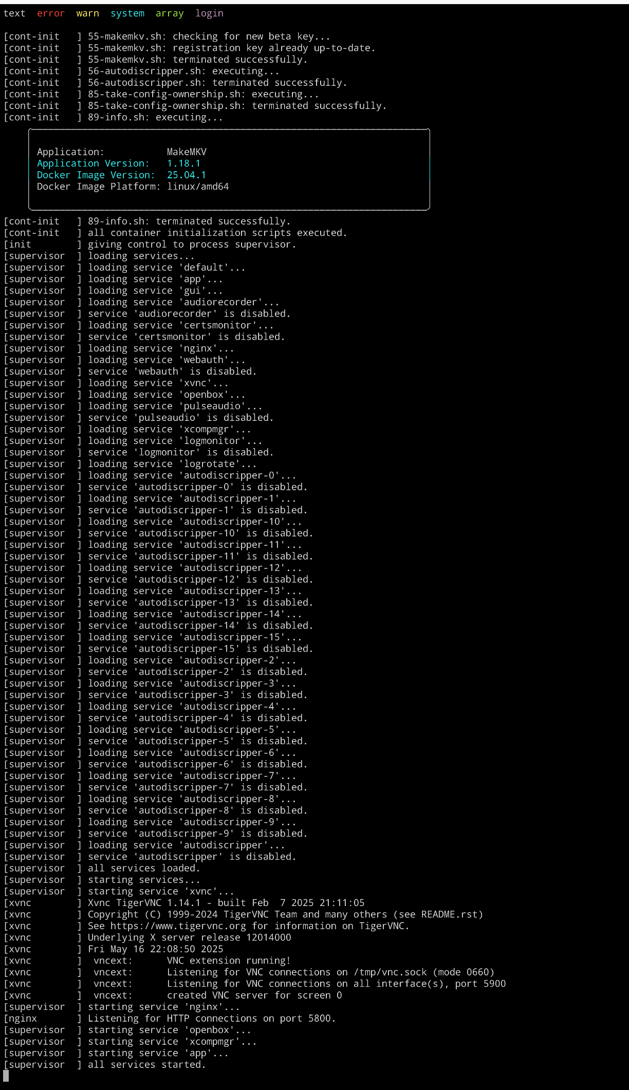

Can you share the container log ?
Sorry I am from mobile phone
We need the full log from the beginning. If you can't scroll up, you can get the log from the terminal by executing the command "docker logs MakeMKV".
Thanks to your advice I found in the full log the second device....thank you very much now it's working

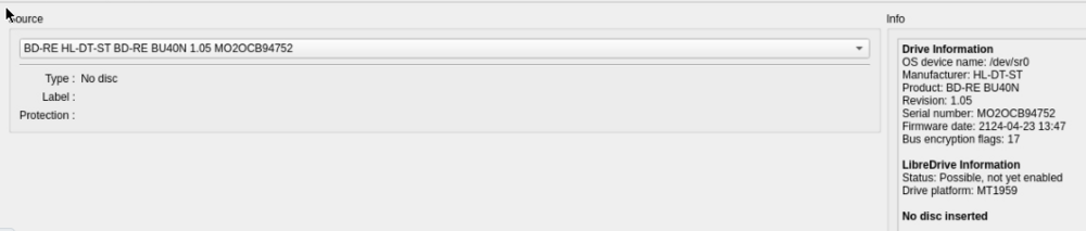

I have a weird issue that when I insert a disc I receive an error message that no disc has been inserted. The disc looks alsmost flawless and works perfectly on my windows computer. The drive also gets detected inside the container ...
Anyone got an idea what might be the issue ?

i tested one audio cd and one dvd so far.

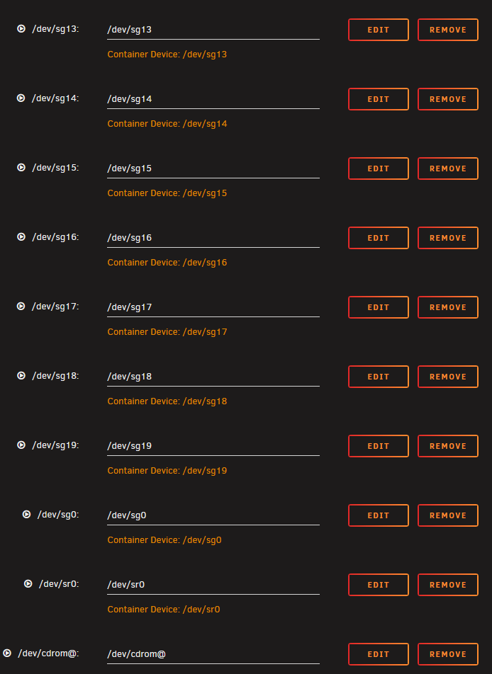

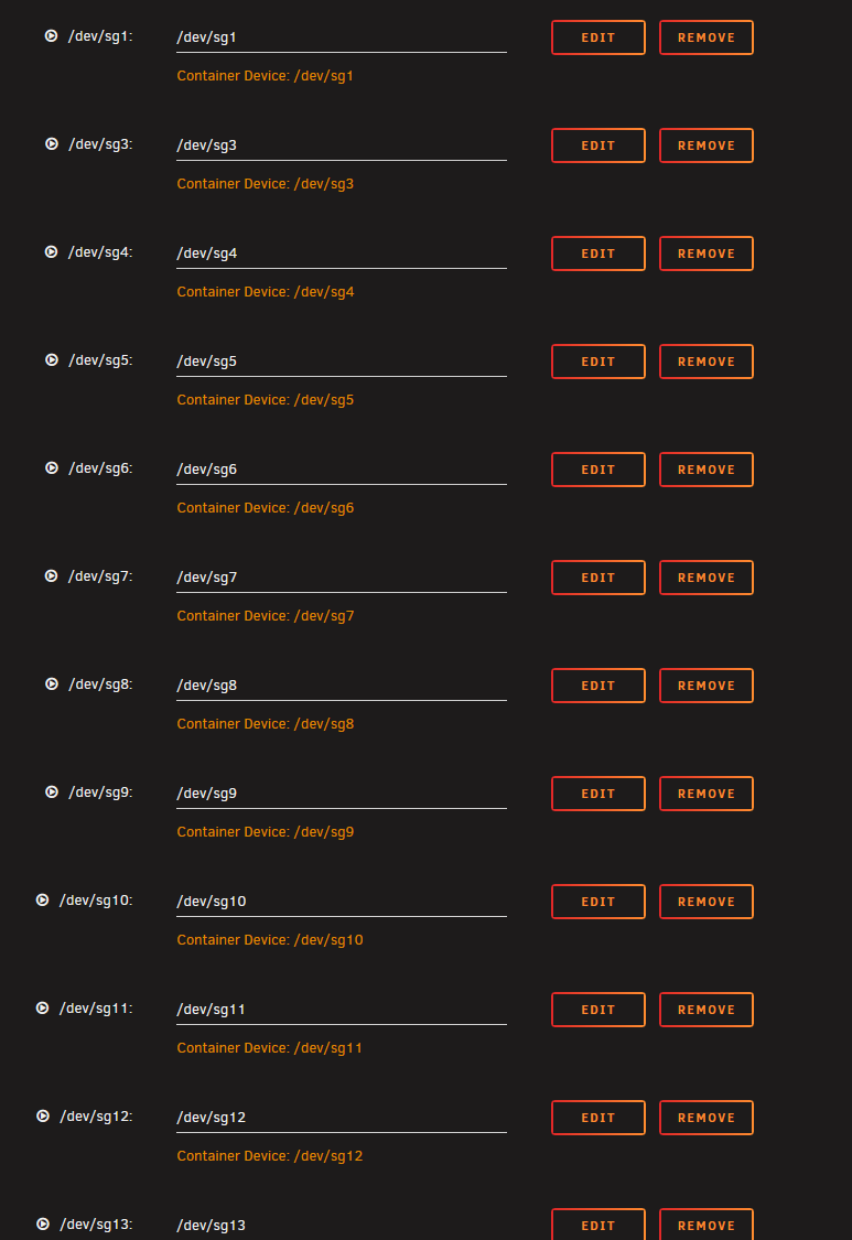

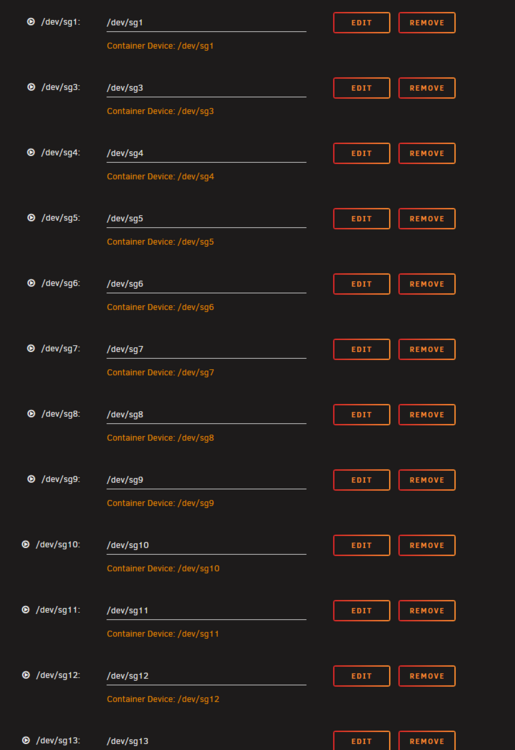

As a test I put the drive into a windows vm by "iommu grouping" the SATA controller and pass it to the VM. Inside the windows vm both discs were detected flawlessly.
I have a suspicion that I might made a mistake by forwarding the drive to the container.
I used this method I saw in youtube: (see screenshot)
grafik.png.1d3e6eb42486167a39ffd77ccfc4a869.pnggrafik.png.db9586be9d33dbd45f3c405be62d2cf3.png
it seems the number behind SG has changed since the last reboot. I test again.
Still... no disc ...
In the log I can find this:
Debug log started at Sun May 18 11:31:27 2025 , written by MakeMKV v1.18.1 linux(x64-release)
001005:0000 MakeMKV v1.18.1 linux(x64-release) gestartet
001004:0000 Debug-Aufzeichnung eingeschaltet. Aufzeichnung wird gespeichert als file:///config/MakeMKV_log.txt
Using 6144KB for read cache.
Network access is ENABLED, CURL version 7.88.1/OpenSSL/3.0.15/1.52.0 (x86_64-pc-linux-gnu) , proxy server not set.
001003:0020 DEBUG: Code 0 at *s,+4m-r">yFd&'k/Y<sa&:29393631
No  SDF v098: HL-DT-ST_BD-RE_BU40N_1.05_212404231347_MO2OCB94752
SDF id v098: HL-DT-ST_BD-RE_BU40N_1.05_212404231347_MO2OCB94752
001003:0020 DEBUG: Code 1 at [U=QLy!_;2fC'+t^1R>#<:121265062
005010:0000 Das Öffnen der Disk schlug fehl
Application exited at Sun May 18 11:31:27 2025
Opening the disc failed:

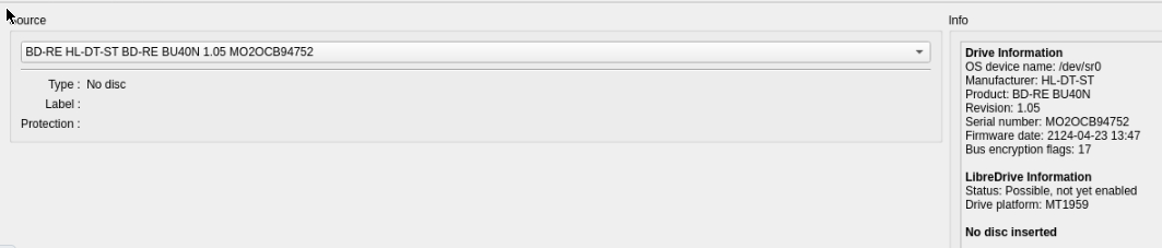

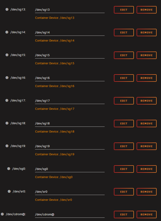

Review the full container log (docker logs MakeMKV) and make sure everything is fine for the detected drive.
Also, I would recommend that you temporarily switch MakeMKV to English so that we can have a better understanding of the log it provides.

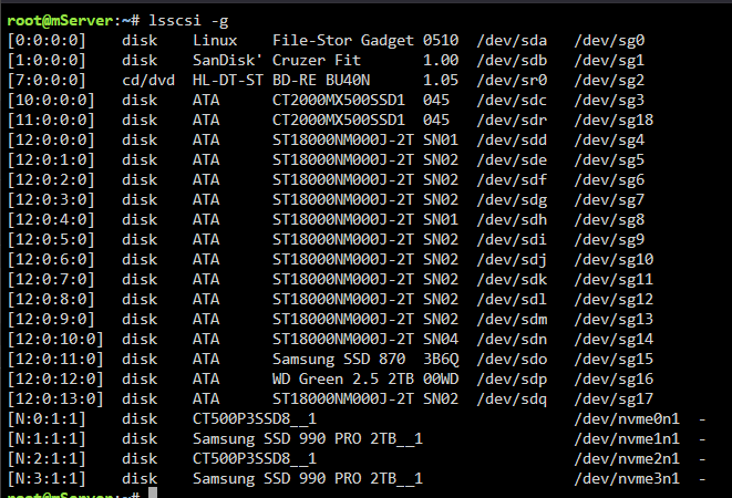

Well first of all iam not very experienced with how linux is handling stuff like this.
I have a Hitachi-LG BU40N drive which is a blu ray drive that also can read DVDs and normal Audio CDs.
Maybe you overlooked it but the drive was reading the discs I tried without any issues when I passed the drive to a Windows VM.
I executed the commands I saw in your post so here are the outputs:
root@mServer:~# ls /dev/{cdrom,sr*,sg*}
/dev/cdrom@ /dev/sg1 /dev/sg11 /dev/sg13 /dev/sg15 /dev/sg17 /dev/sg19 /dev/sg4 /dev/sg6 /dev/sg8 /dev/sr0
/dev/sg0 /dev/sg10 /dev/sg12 /dev/sg14 /dev/sg16 /dev/sg18 /dev/sg3 /dev/sg5 /dev/sg7 /dev/sg9

I put all the devices from the first output into the container like this: (see screenshot)
here is the MakeMKV_log.txt file:
Debug log started at Fri May 23 16:30:30 2025 , written by MakeMKV v1.18.1 linux(x64-release)
001005:0000 MakeMKV v1.18.1 linux(x64-release) started
001004:0000 Debug logging enabled, log will be saved as file:///config/MakeMKV_log.txt
005010:0000 Failed to open disc
Application exited at Fri May 23 16:30:31 2025
I hope this somehow helps. Let me know if you need any informations. Iam also on the discord if you guys want me to share my screen or dm me
old Discord ID matuopm#8951
Edited by matuopm
Note that there is no need to pass all these devices to the container. In your case, according to a previous screenshot, only /dev/sr0 and /dev/sg2 are needed (the ones associated your drive).
You said that the drive was reading the discs under Windows. I assume you also used MakeMKV ?
Could you share the output of "docker logs MakeMKV" ?
I have multiple optical drives connected to my UnRaid server. Right now, I have separate instances of MakeMKV dockers set up, one for each optical drive. This works with no issues. However, is there a way to get one docker instance of MakeMKV to see multiple optical drives? I could then select the drive I want to use via the drop-down menu in MakeMKV, similar to how the Windows version of MakeMKV works when I have multiple optical drives connected to my Windows device. I tried adding additional device parameters for the additional optical drives to the docker container settings (the same ones I use in my separate instances of MakeMKV), but that didn't seem to work. Any help would be appreciated.
Thanks!
