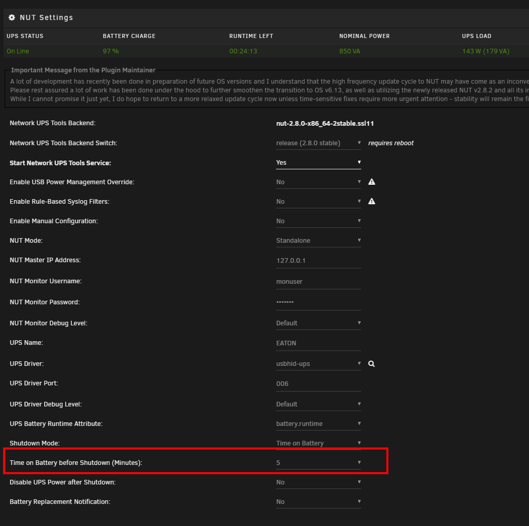

Sorry for weird question, but how can I change "Time on Battery before Shutdown " ? There is 5 minutes and all item are disabled.image.thumb.png.9ac96c7f8964cd986990859edc1c10ba.png
You need to stop NUT, change the setting and then start NUT again - it cannot be changed when it's running.
