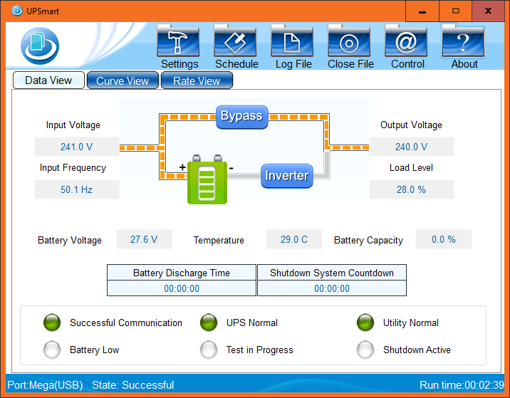

looks like the power cut has revealed other issues as when i cut the power to the UPS, the UPS just goes off.
so i've directly connected to the UPS with a laptop via USB and the battery is 0%. i don't know if its just because it has been flattened and needs time to re-charge or if its f##ked. its only as old as my posts on here asking if NUT could get it!
i've disabled sleep/shutdown on the server as it won't finish a Parity check by midnight. when i get back home from work tonight i will have a look at battery % again.
worrying part is the SOC on NUT is dictated by the battery voltages i've manually entered. seems i need to do some further investigation on this as NUT won't know the battery is flat either.
will update this evening. thanks again.

Good morning!
i have now replaced the 2no batteries within the Powercool UPS and it is now functioning correctly.
running the UPS directly connected to my laptop via USB and running the software that came with the Powercool doesn't tell me anything about the battery health. As far as it is concerned, the batteries within the unit are fine.
now that i have replaced the batteries, the 2 minute process is working fine.
What do i need to do [besides remove my custom battery voltages] to enable NUT to accurately read from the UPS?
edit to add - the "battery capacity" doesn't change even with new batteries. i think the software is a bit "universal" as it has options to do tests that do not do anything.
Edited by Jammy B
21 hours ago, Jammy B said:
Good morning!
Nothing. NUT will by default show all the variables it can read from the UPS, but there's nothing more that can be done to increase the amount of those variables if the UPS driver does not support reading more. I'd just remove the custom voltage settings if they are not needed anymore and I think you're good. 🙂
