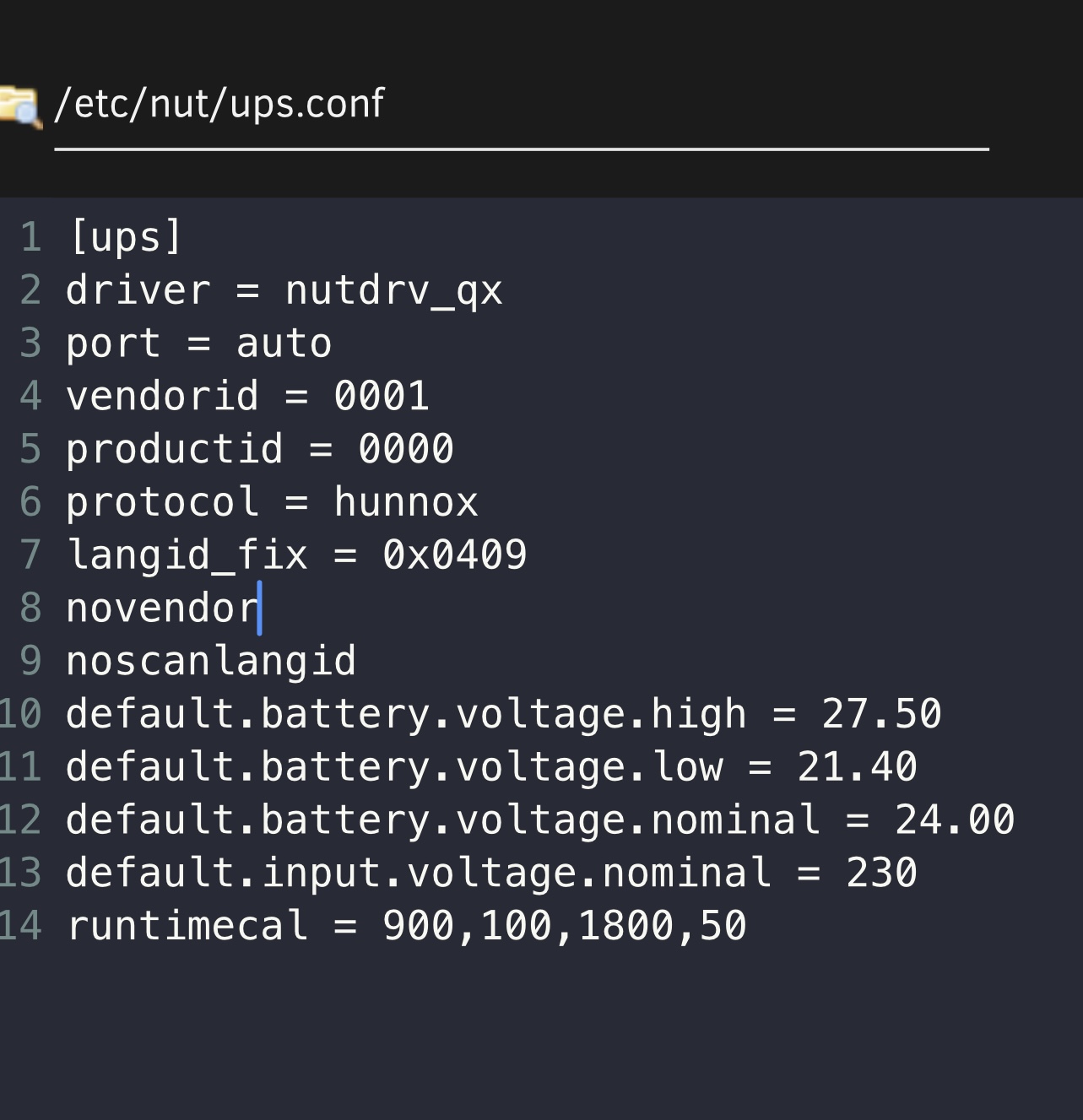

i've had NUT running a couple years now and one thing it does i still cannot solve.
the UPS runs 24/7.
my Unraid server does not, its on from 6am to midnight each day. When Unraid first boots, the battery % is at 0%. some point this afternoon, it have steadily "charged" itself up and got to 100%. i don't understand why it does this when it is 100% already as it is fully charged and on 24/7!
any suggestions on what i need to check/alter to make it display correctly? or am i totally misinterpreting something?

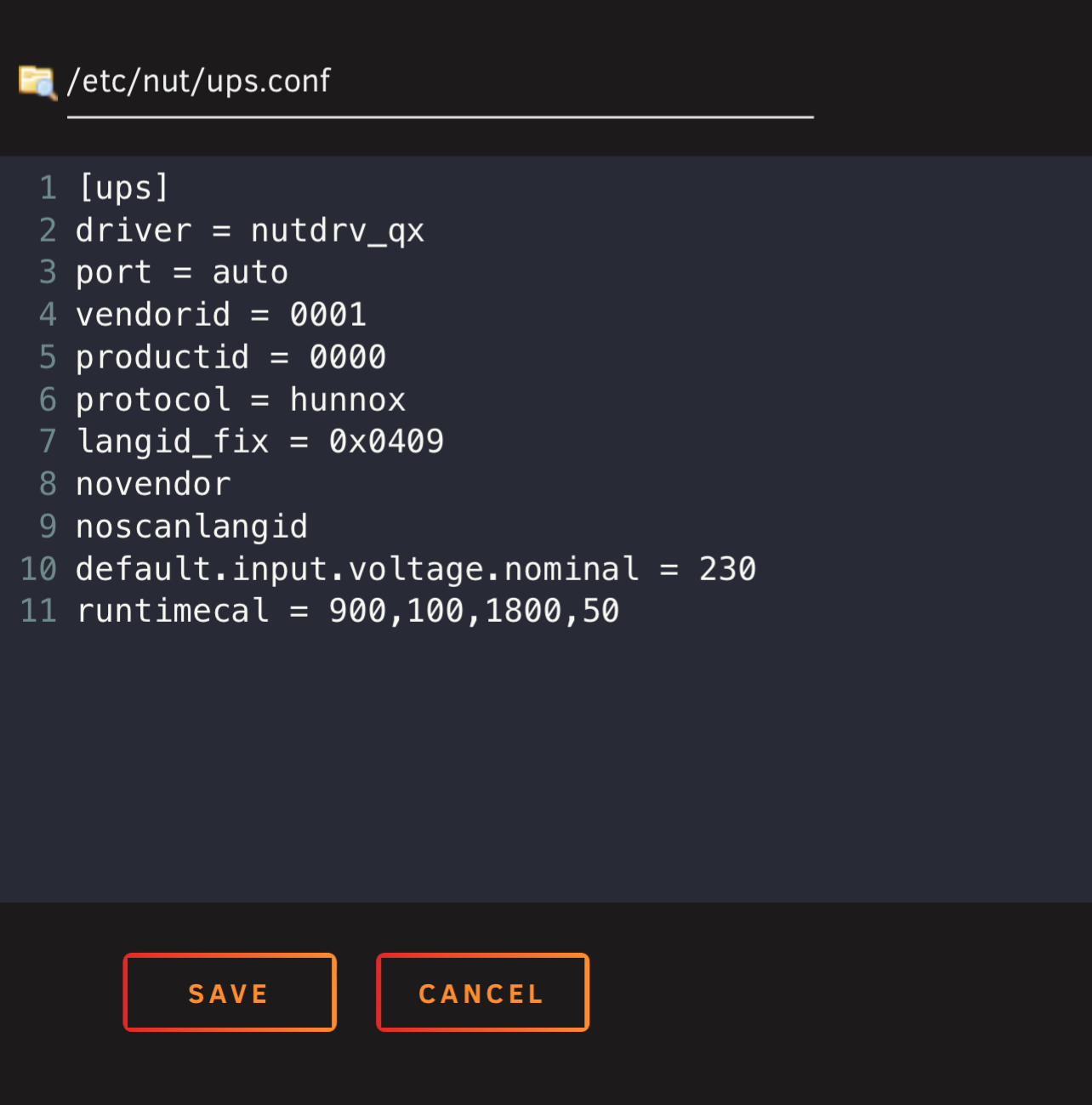

I see you're using these UPS.CONF settings in your old post:
default.battery.voltage.high = 27.50
default.battery.voltage.low = 21.40
default.battery.voltage.nominal = 24.00
If you do this then the driver will guess the battery charge based on the battery voltage. Particularly older batteries cannot hold their maximum voltage well anymore and have sags in voltage (possibly causing frequent re-charges). It's possible this mechanism causes your battery to look as "charging" when fluctuations or changes in voltage occur.
It's also possible that when the UPS sees an increased load when you start up your server it'll start topping up the battery from a lower voltage to a higher voltage (to ensure providing as much battery time as possible), as opposed to times when the UPS load is minimal and the battery can rest with a lower voltage.
Normally the UPS itself provides information about the battery charge, so these settings are not needed and the charge provided is an estimation at best. Please try removing these settings from the UPS.CONF and see if the UPS then provides the actual and not voltage-based estimation of the UPS battery charge.
This is in part related to what this user was warning about here in the old topic:
Edited by Rysz
removing those 3 lines of code causes NUT to not function.
whilst they aren’t necessarily correct, the config works enough that when on battery it then powers off after 2 minutes.
what do you recommend I do next?
Hmm, I'm afraid I'm out of my depth with this now. In this case it's probably best to keep those lines then, if the UPS doesn't function otherwise. You could open an issue on GitHub hoping that the NUT driver developers might be able to help you tune your settings some more: https://github.com/networkupstools/nut/issues
I'm sorry that I couldn't be of more help here!

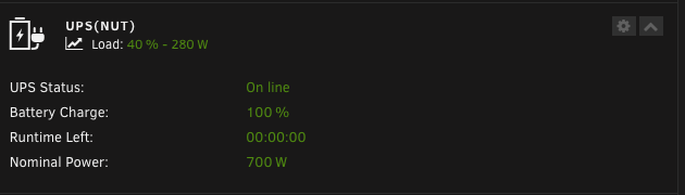

Hi All,
Over the last few weeks, my NUT plugin was displaying a remaining time left of 0:00:00 (in red) instead of the usual 25min.
Since my UPS was 5 years old I changed the battery.
After the battery replacement, it was showing again 28min but few hours later, it came back to 0:00:00 (in green).
Any idea what is going on?
Thanks!

Did you change anything before this stopped working (UPS firmware update, used another USB port or hub, updated from a much older NUT version, changed the NUT backend, ...)? It looks like the UPS either cannot read, estimate or send the runtime information anymore, because NUT itself receives "battery.runtime: 0" from the UPS. Is the battery you changed to new and properly connected inside the UPS, are there any LED indications that something is not working as it should?
Another thing you could try is if the runtime is shown when you disable NUT and use the inbuilt APCUPSD service's "UPS Settings" in UNRAID (just for testing), this way we could better determine if this is a software (NUT/NUT driver) or hardware (UPS/UPS connectivity) problem.
Edited by Rysz

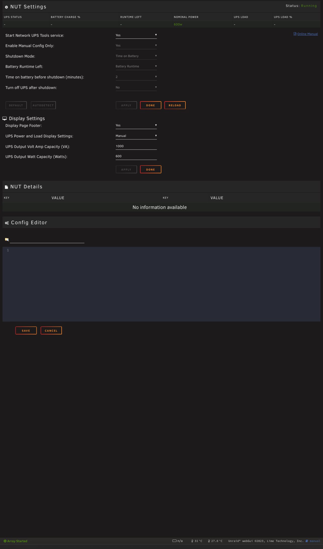

Hello Rysz (and everyone else here),
I seem to be running into a strange issue with NUT. I'm not sure when this started occuring with NUT on my Unraid server, but for some reason, it would not want to run, at least I think it's not running. I enabled the footer and it disappeared. When I go to the NUT settings, and restart NUT, I get an error and it asked me to check syslog.
I also decided to restart unraid to see if that fixed it, and while it did for a the first few minutes where the footer shows up and shows the correct UPS reading, it all of a sudden disappeared and the same issue happened again.
I'm not even sure what to look for or try to do to fix this. I want to avoid rebooting unraid since it takes the server about 4-5 minutes to go through the whole cycle, so if there's any way for me to restart NUT without rebooting, that'll be great. I mean, of course I don't mind rebooting if it's really necessary, I just meant that I don't want to keep rebooting my server.
I'm including some screenshots below, along with diagnostic file and nut debug file. Hopefully they can help.
Thank you.

Did you make any significant changes to the UPS (battery/settings), the physical connection (different USB cable/port) or NUT (changed backend/updated from much older version) recently that could correlate with this issue? If it worked well before then it looks to me like the USB cable or USB port is dying, hopefully not the USB interface on the USB itself. Can you try with another USB cable or USB port and check if the problem resolves? Configuration-wise everything looks good, so I'm thinking it's something with the physical connection that causes these dropouts - especially since the UPS is recognized at first.
Hi Rysz, I figured out what I did wrong, but it seem to not have fixed the issue.
I seemed to have accidentally linked the USB connection for the UPS to one of my VMs, which would explain why NUT can no longer see the UPS. However, even after disassociating the UPS from the VM and rebooted my server, NUT's status still shows as Stopped. I'm not sure what else is preventing it from working properly.
Is there a way to restart the NUT service without having to reboot unraid altogether?
Of course, just set "Start Network UPS Tools Service" to "Yes" and click on "Apply".
If it is currently set to "Yes": Set it to "No" -> Click "Apply" -> Set it to "Yes" -> Click "Apply".
Please let me know if that worked for you 🙂
HAH! How did I completely miss that line? LOL. Thank you so much, and yes it is now working perfectly fine like before :D
