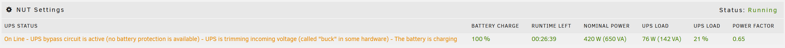

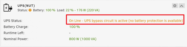

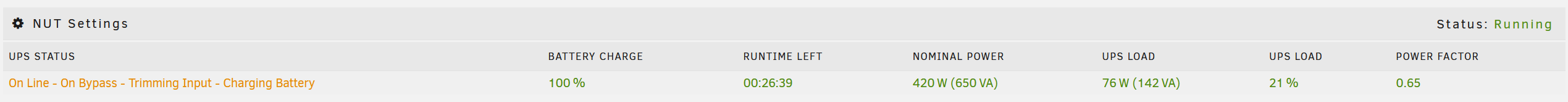

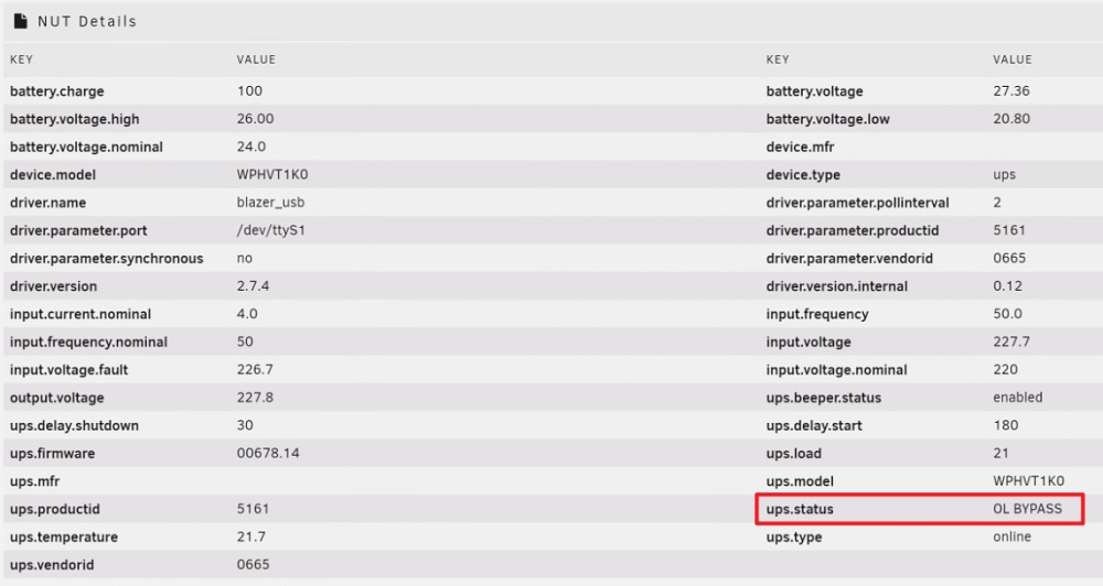

On 10/1/2023 at 3:51 PM, Rysz said:
Please install Network UPS Tools (NUT) for UNRAID by Rysz from Community Applications. The older plugins (including the one in the first post of this topic) are deprecated/now unsupported.
Hello, thanks to the greate plugin, Network UPS Tools (NUT) for UNRAID, works well. And I have a small question to  ask.
My UPS has 6 modes listed here:
Online mode
When the input voltage is within the allowable range, the inverter works to provide stable pure sinusoidal AC power output and charge the battery at the same time. In the event of a power outage, the switching time to battery power is 0ms.
ECO mode
When the input voltage is within the set voltage range, the UPS will switch to bypass mode to achieve energy saving. In the event of a power outage, the switching time to battery power is <4ms.
Frequency Conversion mode
When the input frequency is within the set allowable range, the UPS can set the output frequency to 50Hz or 60Hz, and the UPS will charge the battery at the same time.
Battery mode
When the input voltage is abnormal or there is a power outage, the UPS switches to battery mode and the buzzer sounds once every 4 seconds, and the UPS will be powered by battery power.
Bypass mode
When the UPS is operating in online mode and is overloaded, if the input voltage is within the allowable range, the UPS will automatically enter bypass mode.
Standby mode
When the UPS is plugged into the mains supply and not turned on, the UPS works in standby mode, only charging the battery, and the UPS has no output.
Online mode
ECO mode
Battery mode
Bypass mode
Standby mode
Personally, I use Eco mode, because it saves energy and reduces heat and fan noise.
The UPS works on Eco mode, But the NUT says “On Line - UPS bypass circuit is active (no battery protection is available)”
What can I do to solve the alert? or Could you add an option to set whether to hide this alert?
Thanks a lot.
Yes, this is basically correct information being shown by NUT. The yellow colour is not an alert, it just means that something that is not 100% standard operation is happening for the user to be aware of:
ECO mode: When the input voltage is within the set voltage range, the UPS will switch to bypass mode to achieve energy saving. In the event of a power outage, the switching time to battery power is <4ms.
I agree that "no battery protection is available" is maybe not 100% correct in your case, but the UPS being on BYPASS is correctly reported by NUT. Usually BYPASS does mean that the UPS circuit is completely bypassed (like in datacenters during UPS battery maintenance) so in such cases there really is no battery protection available while the UPS is on BYPASS. It seems in your case they have a smart switching mechanism and not powering the rectifier and battery circuits is saving that energy and thermal heat to be called ECO mode. I'm also not sure if the UPS is able to condition input power (Volts and Hz) in ECO mode, if that's something that matters to you.
By the way, "blazer_usb" is the legacy driver for the newer "nutdrv_qx" driver, you can try setting the UPS Driver to "nutdrv_qx" and see if that will show more or better information (also regarding the BYPASS) - it should work (see this report): https://github.com/networkupstools/nut/issues/1872
Edited by Rysz
I asked the manufacturer.
1, They responded with some instructions for ECO mode, which works like a backup-UPS, but with a little difference. When the input voltage meets the set range (for example 220v±5v), it directly outputs 220v±5v, the rectifier and inverter are not working but are standby, which can save energy and reduce heat generation. When the input voltage exceeds the set range, (for example 230v), the inverter works to provide stable pure sinusoidal 220v AC power output with a conversion time of 0ms. When there is a power outage, the inverter works and is powered by the battery, outputting 220v AC power with a conversion time of 1.8ms (< 4ms).
2, The manufacturer responded with some instructions about ups.status.
ups.status OL           means Online mode
ups.status OL BYPASS    means ECO mode
ups.status OL CHRG      means Online mode, charging
ups.status BYPASS       means Bypass mode
ups.status OVER BYPASS  means Bypass mode, overloaded
ups.status OB           means Battery mode
ups.status LB           means Low battery
Personally, Saves energy reduces heat and fan noise are more important for me than the stable pure sinusoidal AC output. so I choose to use Eco mode.
I was confused why they chose to use "OL BYPASS" for their ECO mode.
Anyway, as long as it works normally, this warning doesn't matter.
Thanks again.
Thanks again.
Thanks for getting back to me and asking the manufacturer too, this is very interesting information to me. I also have an update in the works where I'm generally shortening the UPS statuses, e.g. the currently extremely long BYPASS status will simply be "On Bypass" in the future, which will look better in the dashboards and not exceed the table dimensions even when multiple statuses are present (e.g. OL DISCHRG CAL) as seen with some UPS. I don't think an explanation that long is necessary for most UPS statuses and it looks weird when grouped together in the dashboard like that.
Extreme Example - Before:
Extreme Example - After:
Edited by Rysz

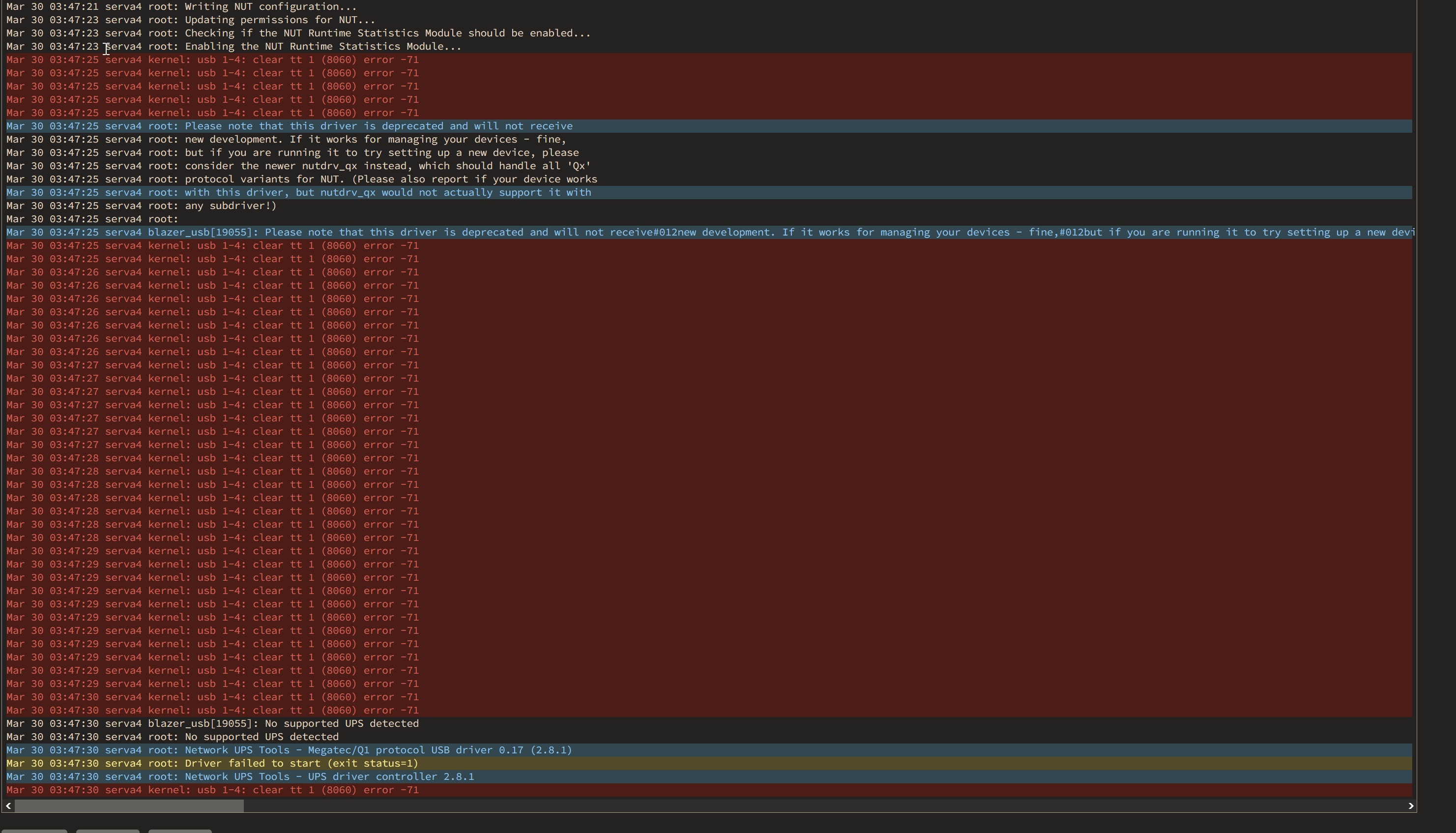

Hey Rysz
I updated today to 2024.03.28. Before the update, my Green Cell UPS 1500VA (900W) could be read.
But now I get these errors:
Mar 30 03:47:20 serva4 ool www[17362]: /usr/local/emhttp/plugins/nut-dw/scripts/start
Mar 30 03:47:21 serva4 root: Writing NUT configuration...
Mar 30 03:47:23 serva4 root: Updating permissions for NUT...
Mar 30 03:47:23 serva4 root: Checking if the NUT Runtime Statistics Module should be enabled...
Mar 30 03:47:23 serva4 root: Enabling the NUT Runtime Statistics Module...
Mar 30 03:47:25 serva4 kernel: usb 1-4: clear tt 1 (8060) error -71
Mar 30 03:47:25 serva4 root: Please note that this driver is deprecated and will not receive
Mar 30 03:47:25 serva4 root: new development. If it works for managing your devices - fine,
Mar 30 03:47:25 serva4 root: but if you are running it to try setting up a new device, please
Mar 30 03:47:25 serva4 root: consider the newer nutdrv_qx instead, which should handle all 'Qx'
Mar 30 03:47:25 serva4 root: protocol variants for NUT. (Please also report if your device works
Mar 30 03:47:25 serva4 root: with this driver, but nutdrv_qx would not actually support it with
Mar 30 03:47:25 serva4 root: any subdriver!)
Mar 30 03:47:25 serva4 blazer_usb[19055]: Please note that this driver is deprecated and will not receive#012new development. If it works for managing your devices - fine,#012but if you are running it to try setting up a new device, please#012consider the newer nutdrv_qx instead, which should handle all 'Qx'#012protocol variants for NUT. (Please also report if your device works#012with this driver, but nutdrv_qx would not actually support it with#012any subdriver!)
Mar 30 03:47:26 serva4 kernel: usb 1-4: clear tt 1 (8060) error -71
Mar 30 03:47:27 serva4 kernel: usb 1-4: clear tt 1 (8060) error -71
Mar 30 03:47:28 serva4 kernel: usb 1-4: clear tt 1 (8060) error -71
Mar 30 03:47:29 serva4 kernel: usb 1-4: clear tt 1 (8060) error -71
Mar 30 03:47:30 serva4 kernel: usb 1-4: clear tt 1 (8060) error -71
Mar 30 03:47:30 serva4 blazer_usb[19055]: No supported UPS detected
Mar 30 03:47:30 serva4 root: No supported UPS detected
Mar 30 03:47:30 serva4 root: Network UPS Tools - Megatec/Q1 protocol USB driver 0.17 (2.8.1)
Mar 30 03:47:30 serva4 root: Driver failed to start (exit status=1)
Mar 30 03:47:30 serva4 root: Network UPS Tools - UPS driver controller 2.8.1
Is there anything I have to change, to get it back working? Thanxs, greetz Stefan
