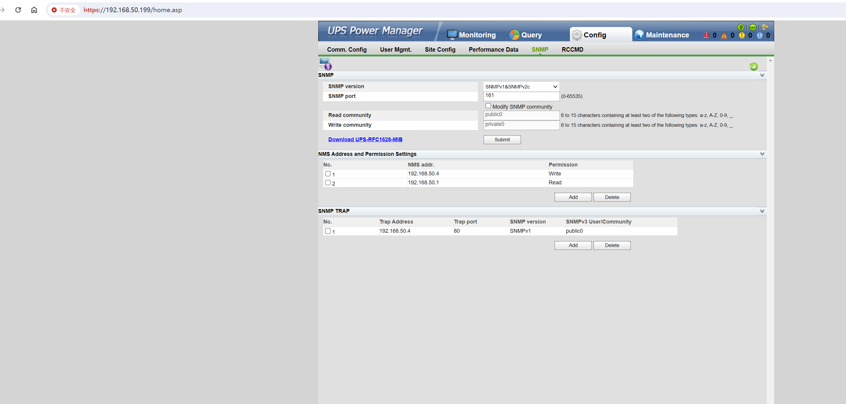

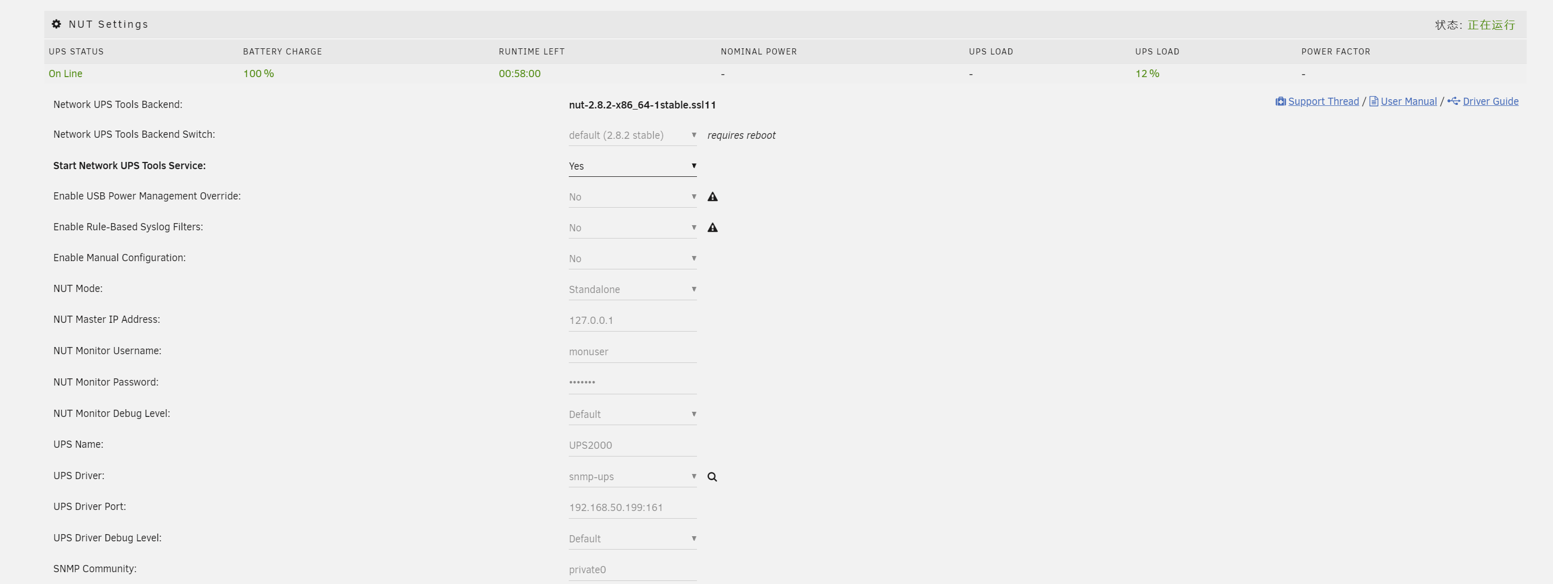

The SNMP address in the image is 192.168.50.199, and SNMP has been configured. However, I can't enable it in Unraid. I suspect it's due to incorrect settings, but I haven't been able to find the reason.
At the same time, I found in the Hardware Compatibility List that the Huawei UPS5000-E supports the SNMP-UPS driver, while my UPS2000-A series only supports the Huawei-UPS2000 driver.

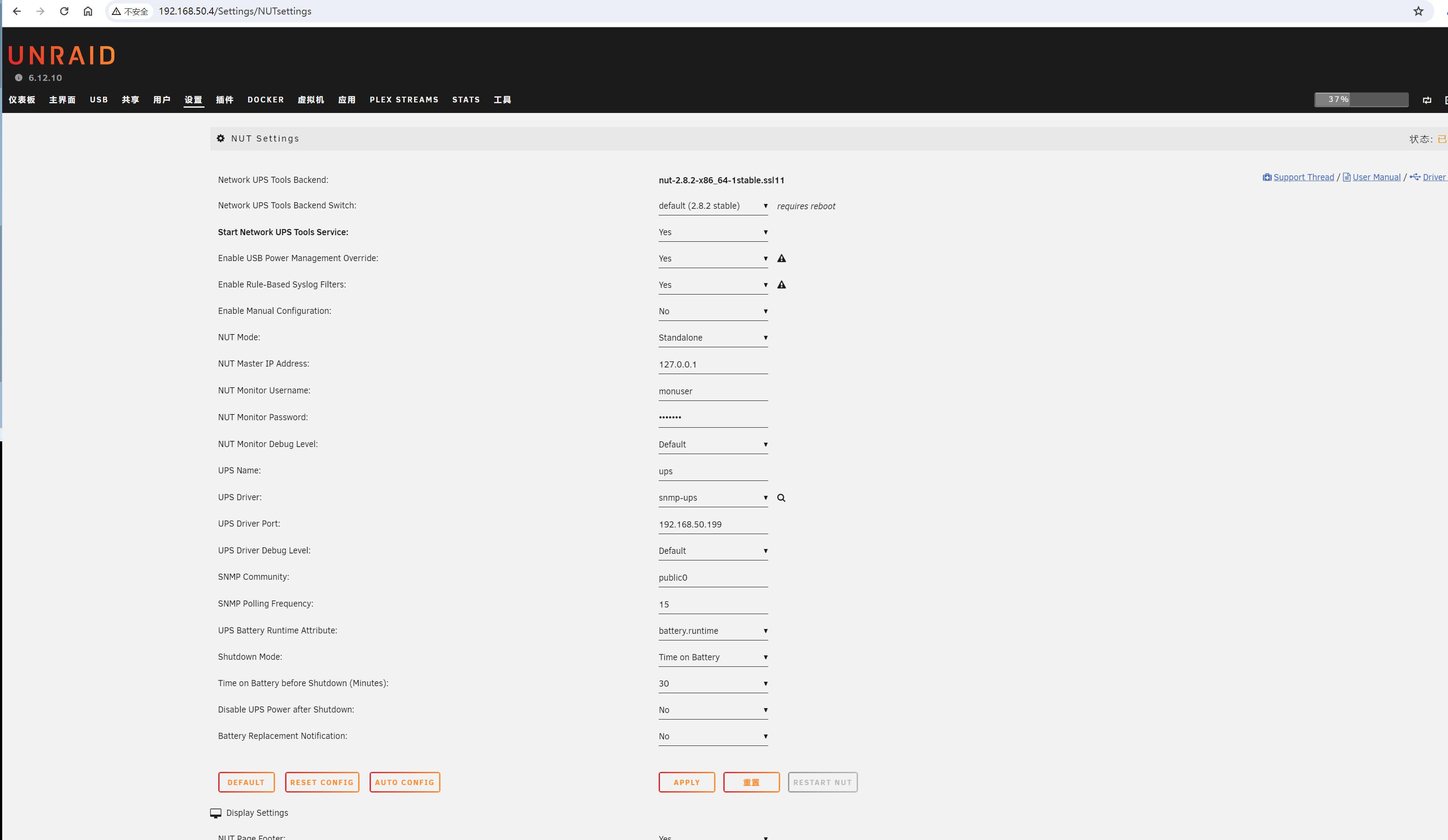

Can you try put the as the UPS Driver Port: 192.168.50.199:161
Then set Start Network UPS Tools Service to No --> Apply --> Yes --> Apply
If it doesn't work then please post the relevant SYSLOG lines so I can see what NUT does... 🙂
Also please download the MIB file from that page and post it here, so I can see if it is NUT compatible!
Edited by Rysz

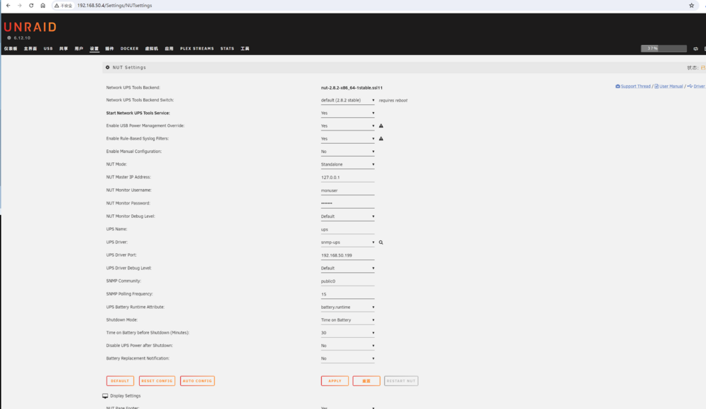

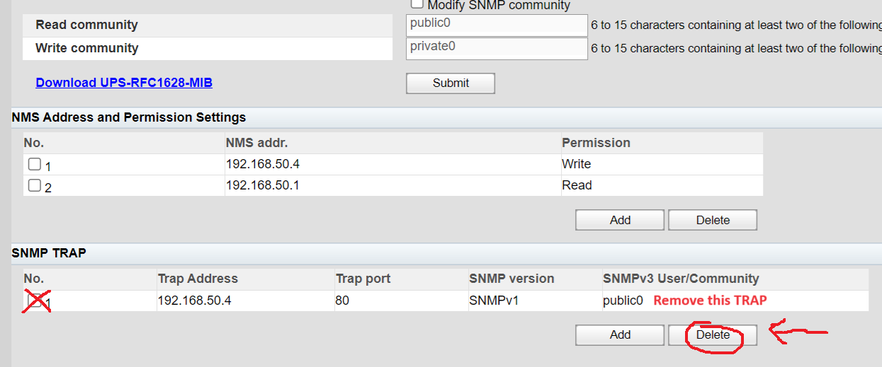

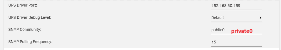

This is a log, and the MIB file is attached for your reference. I am currently using 192.168.50.199:161 but still unable to connect.
UPS-RFC1628-MIB.zip
It should work with your UPS because it uses the RFC standard.
Can you try changing the settings as follows:

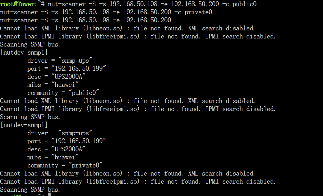

If this doesn't work, please run these commands and post the results:
nut-scanner -S -s 192.168.50.198 -e 192.168.50.200 -c public0
nut-scanner -S -s 192.168.50.198 -e 192.168.50.200 -c private0

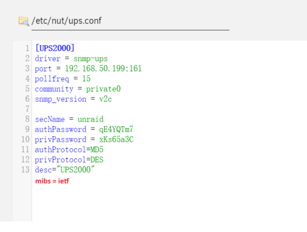

Last resort, check out this Chinese guide I found for your UPS with SNMP:
https://post.smzdm.com/p/adm62dkk/
They got it working with SNMPv3. It should definitely work with SNMPv1/SNMPv2 also, but in the worst case you can try the guide from this post and use SNMPv3 (which is far more complicated, but also more secure).
Please let me know what worked for you in the end!

According to your instructions, it is now running normally, but I cannot see: NOMINAL POWER UPS LOAD UPS LOAD POWER FACTOR information.
At the same time, according to the web page you provided, V3 can also run normally.
But currently only the SNMP method is most suitable for my working style.
Is there any way to improve it?
This is additional information
Hello, glad you got it working with SNMP.
There is not really a way to improve the values being read, as that is hard-coded into the driver.
Can you try adding this setting and see if anything improves?

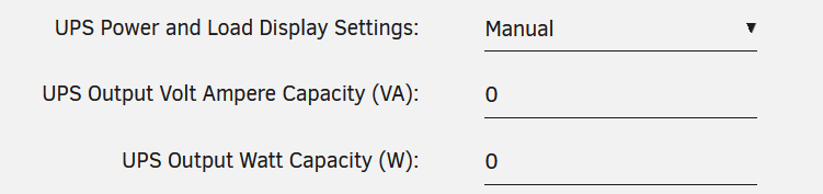

Now I can see UPS LOAD, but it is still incomplete.
That's great, because from UPS Load the other missing variables can be calculated.

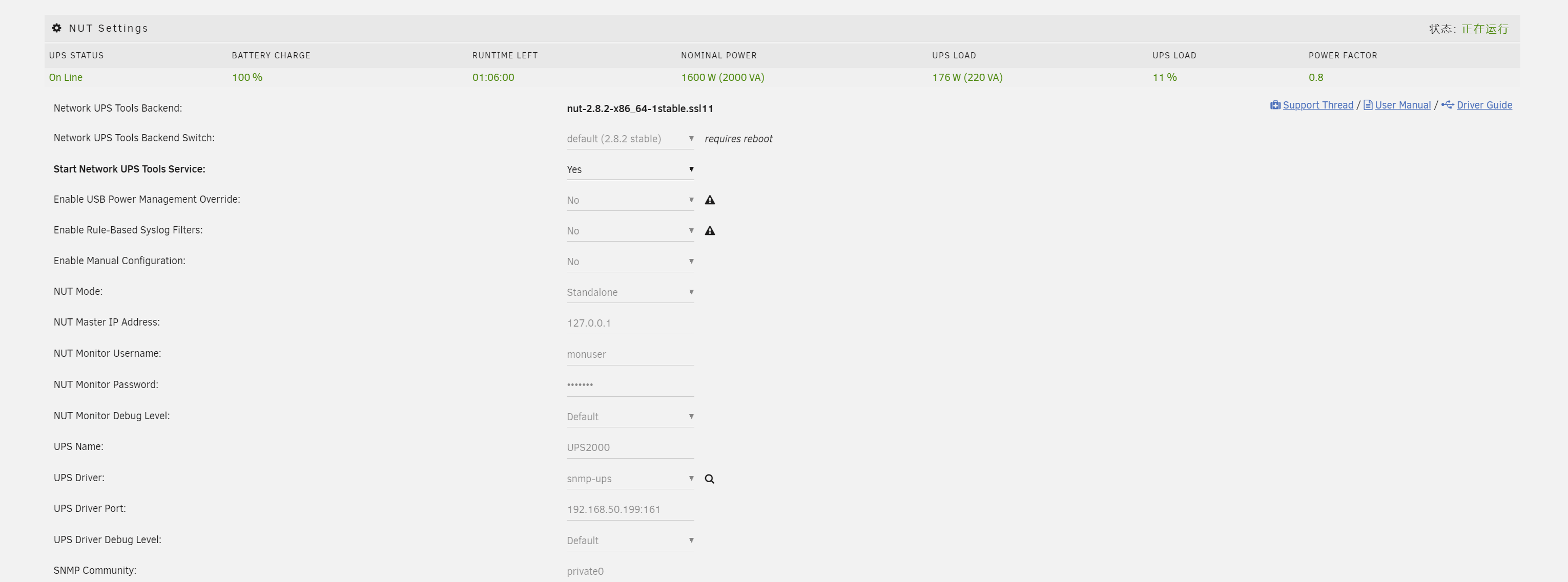

Now set these settings:
Instead of 0 put here the nominal 2000VA and 1600W of your UPS and you should see the other variables now 🙂
Edited by Rysz
Thank you very much, it displays perfectly now.

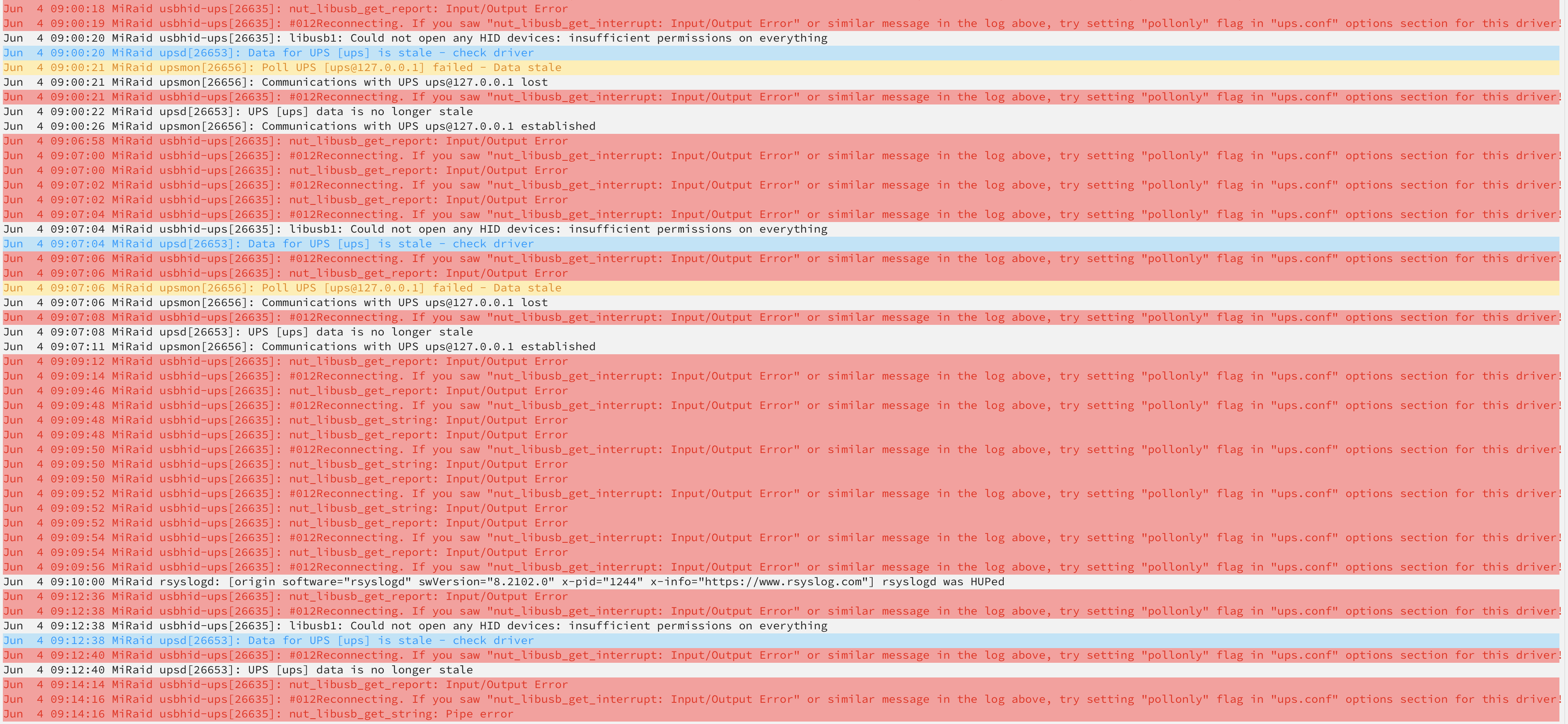

Still struggling with random disconnects of a CYBERPOWER BR700ELCD.
I tried adding the pollonly flag, as suggested on the manual page: https://networkupstools.org/docs/man/usbhid-ups.html, but this did not help.
I realise this is not an Unraid/NUT issue, but wondering if anyone has any other suggestions?
The disconnects are completely random - sometimes it goes weeks, other times only a day. And I have to unplug/replug the USB cable to get it to work again (a restart of NUT does not help).
Jun  3 16:14:43 SM1 usbhid-ups[19008]: nut_libusb_get_report: Input/Output Error
Jun  3 16:14:43 SM1 kernel: usb 2-2.1: USB disconnect, device number 41
Jun  3 16:14:45 SM1 kernel: usb 2-2.1: new low-speed USB device number 42 using uhci_hcd
Jun  3 16:14:46 SM1 kernel: hid-generic 0003:0764:0501.0028: hiddev96,hidraw1: USB HID v1.10 Device [CPS BR700ELCD] on usb-0000:02:00.0-2.1/
input0
Jun  3 16:14:53 SM1 kernel: usb 2-2.1: USB disconnect, device number 42
Jun  3 16:14:56 SM1 usbhid-ups[19008]: libusb1: Could not open any HID devices: insufficient permissions on everything
Jun  3 16:14:56 SM1 upsd[19125]: Data for UPS [ups] is stale - check driver
Jun  3 16:14:57 SM1 kernel: usb 2-2.1: new low-speed USB device number 43 using uhci_hcd
Jun  3 16:14:58 SM1 kernel: hid-generic 0003:0764:0501.0029: hiddev96,hidraw1: USB HID v1.10 Device [CPS BR700ELCD] on usb-0000:02:00.0-2.1/
input0
Jun  3 16:14:59 SM1 upsmon[19129]: Poll UPS [[email protected]] failed - Data stale
Jun  3 16:14:59 SM1 upsmon[19129]: Communications with UPS [email protected] lost
Jun  3 16:15:04 SM1 upsmon[19129]: Poll UPS [[email protected]] failed - Data stale

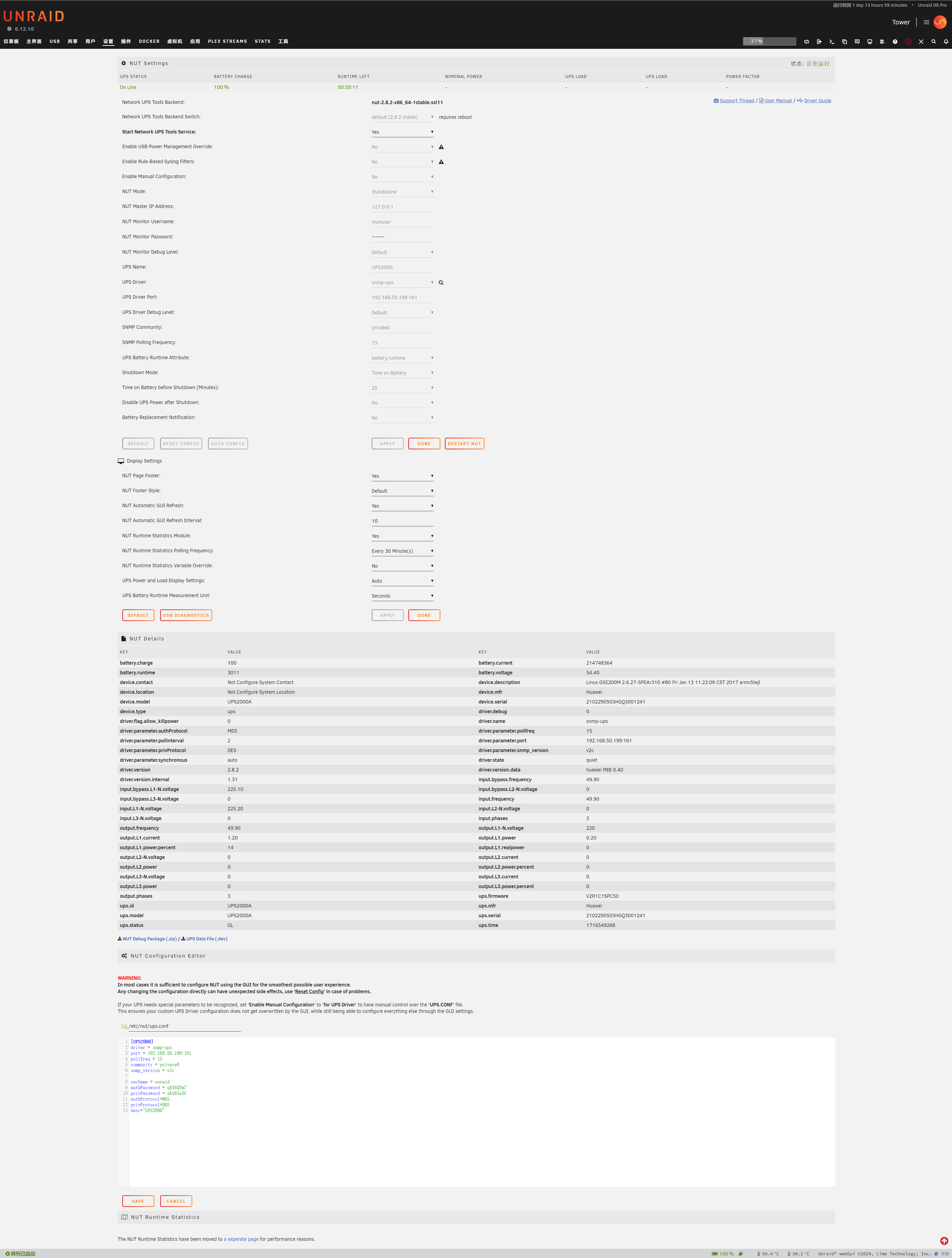

Hi all, seems I'm having a similar issue. I only happened to randomly look at system logs to even notice it to begin with, but after noticing and scanning back through it seems ever since I first implemented the NUT app a couple days ago the same thing has been occurring regularly. Screenshot of the system log page attached below. I'm using the USB cable that was included with the UPS (CyberPower 1350VA - CST135UC2) and it is plugged in to a 2.0 port on the back of my NAS. Any advice? NUT Debug also attached.
nut-debug-20240604091516.zip
This is regular data staleness, as is unfortunately a problem with some UPS.
Does your UPS work normally and this is primarily a log spamming issue, or are there also problems with the UPS itself (e.g. being unavailable, no data in dashboards, ...)?
Edited by Rysz
