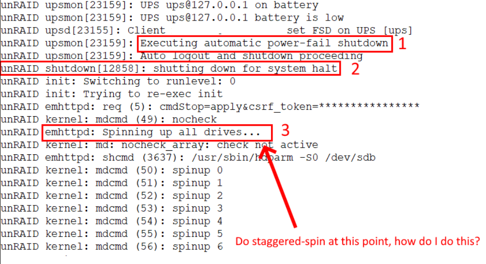

Can we have a setting to spin up drives 1 by 1 rather than the whole array?
In a way do a "simulated" staggered spinup by reading each disk when UPS battery powered is activated. Like how plex only spins up the video file on that 1 particular disk and not the whole array.
Current problem,
  1. 12 drives spun DOWN
  2. Power goes out
  3. UPS Online and now array uses battery powered
  4. Shutdown initiated
  5. [PROBLEM HERE!!] All 12 disk spins up all AT THE SAME TIME
  6. UPS chokes due to high power spike and shuts down the server prematurely RIP
  7. A mini heart attack followed by praying my data is all fine
As you can see this can be avoided by spinning up the disks 1 by 1, it doesn't take long at all probably 30 seconds per drive to be safe WHEN SHUTDOWN IS INITIATED. Please incorporate this!!

Sorry this is outside of the scope of NUT (and UPS software in general). All NUT does is invoke the operating system's shutdown command when the respective shutdown conditions are met. How the OS chooses the handle the shutdown procedure itself is up to the operating system. In any case, one should always dimension the UPS to be able to sustain the target system at least under maximum load, if it cannot sustain the system under maximum load then it will likely also not provide much "on battery" time under regular load - which is a problem in itself. The solution you are asking for is a band-aid for the problem of a too small UPS for a too large system and not something that I want to add as it masks that actual problem - it would be better to purchase a sufficiently dimensioned UPS.
You need a larger UPS, I would also check the batteries, when they are at end of life the UPS will not hold it full load capacity.
I don't see any other solution that will work as you can't control what is on and what is not. Power failure can happen during parity check which has all the disks running anyhow.
Spinning the disks at shutdown is how all OSes works.

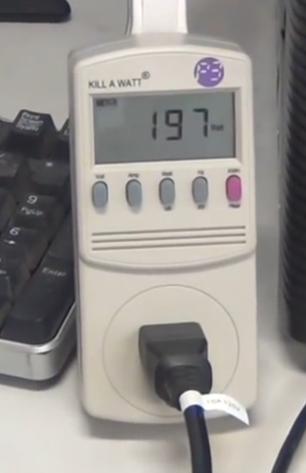

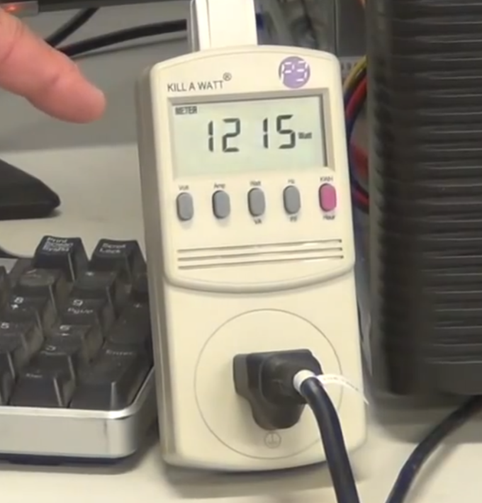

Hmm, let me help you make some sense to it.
When HDD spins up it takes 2A each for about 30 seconds.
After spinning, it runs 0.1A-0.3A. That 30 seconds is the main problem.
This video sums it up,
All drives spin up at THE SAME TIME 1215W for a split second.
Staggered spin up doesn't exceed 200W
As you can see, my UPS can't handle that much current even for a split second. BUT it can sustain loads for long periods.
I.e like this example, the 200W "staggered" spin up can sustain 20 mins for 50% no problems.
But when there's large current draw for a split second, UPS says NOPE and just dies.

I understand what you are saying: Your UPS is not able to sustain the peak load of all drives spinning up, but is able to sustain the load of all drives already spinning. But this is exactly the problem I was talking about, the maximum load you need to scale your UPS for is the actual maximum load that is theoretically possible on the target system and not anything below that.
Let's take the example you have given: If you must spin down your disks, you need a UPS to support 1215W and not 197W, even if it only reaches the 1215W during spin-ups. You simply cannot rely on your drives not spinning up all at once randomly and for whatever reason during battery operation.
Even if I were to implement the feature you are asking for, your UPS would still crash if literally anything else caused a spin-up of all disks while it is on battery power - there's just no point to only implement this in NUT. If you really want that, you better ask for a OS feature that allows staggered spin-ups if anything causes a spin-up of all disks during runtime, and not just NUT shutting down the server (which is in fact the OS shutting down the server, as NUT just sends the regular shutdown command).
No offence, you need a UPS that can support what you are calling a "surge" but is actually just the maximum load that you should have scaled your UPS for. You are running 12 disks and you are already running into this problem, how do you think some of the users with up to 60 disks are using their UPS and NUT without this feature you're asking for? This literally is the first time I'm hearing about this problem.
P.S.: A staggered spin-up only makes sense like that (as in the video above) if you set it up in your BIOS or HBA BIOS and keep the drives always spinning afterwards. Then you'd theoretically be able to run with a smaller UPS, but it's still bad practice in my opinion. This should only be for cases where the PSUs are not able to support the peak load of all drives spinning up at boot time and then keep spinning afterwards, as spin-ups are just not a well controllable situation within the OS (unless the drives are always spinning).

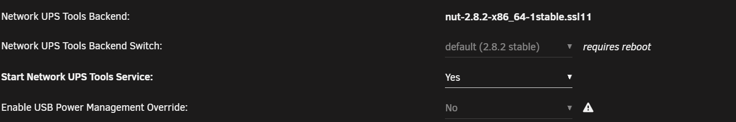

Here is the pull request #2562 compiled into a package:
nut-2.8.2-x86_64-1eapr.txz
1) Stop NUT in NUT Settings
2) Run this command:
removepkg nut-2.8.2-x86_64-1stable.ssl11.txz
3) Put the testing file onto the system somewhere
4) Run this command in the folder where you put the testing file:
installpkg nut-2.8.2-x86_64-1eapr.txz
5) Start NUT in NUT Settings
6) Confirm backend now shows as "nut-2.8.2-x86_64-1eapr" in NUT Settings
Wow thanks a lot, it seems fixed the issues i had :) will report to NUT devs, if something i will let you know ...

On another note, just because I won't add this to NUT, doesn't mean you can't do it with NUT yourself.
You can always modify the SHUTDOWNCMD or better NOTIFYCMD to point to a custom script that does this.
https://networkupstools.org/docs/man/ups.conf.html
18 hours ago, Kilrah said:
But say you lose power, before NUT initiates shutdown something else fires up all drives, you're toast. As mentioned several things can make drives spin up.
I don't see how this is possible, when power goes out, unraid instantly does these 3 processes. So there's no "unexpected spin up". Its all expected.
How do i change "emttpd: Spinning up all drives" to "emttpd: Spinning drives 1 by 1".
Or better yet have Unraid kernel mdcmd spinup with a 30 second delay.
I think I know what's the issue here, GEL BATTERY. My UPS uses Gel battery instead of lead-acid. It has long shelf life, 10-20 years vs 5 years (lead-acid) but with the cost of having low "SURGE" current.
Please do an option (staggered spinup) for us that uses Gel batteries!!
Edited by killua
3 hours ago, Rysz said:
2) Run this command
(if you still have the testing package installed):
removepkg nut-2.8.2-x86_64-1eapr.txz
or (if you don't have the testing package installed anymore):
installpkg nut-2.8.2-x86_64-2eapr.txz
6) Confirm backend now shows as "nut-2.8.2-x86_64-2eapr" in NUT Settings
Many Times Thanks
