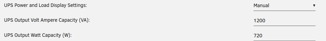

If it's not showing the power draw already, you can set these settings up with your UPS rated capacities:
And it'll calculate the power draw from those settings in combination with the reported load percentage of the UPS. Other variables are not possible to be shown in the footer (yet), but I'll put that on the TO-DO list for the future. However you can already monitor/have charts for other variables with the NUT Runtime Statistics Module.
The footer itself should look like this when everything's working as designed:
Oh yah. that's exactly what I needed to do! I have the wattage showing in the footer. I also updated a few of the variables for the Stats Module since this UPS seems to play by its own rules and that is fully populated now, too. Thanks so much for the help! I'm very happy to have all of this back reporting again. I'll have to do a load test with my UNRAID array off-line to make sure it all works now.

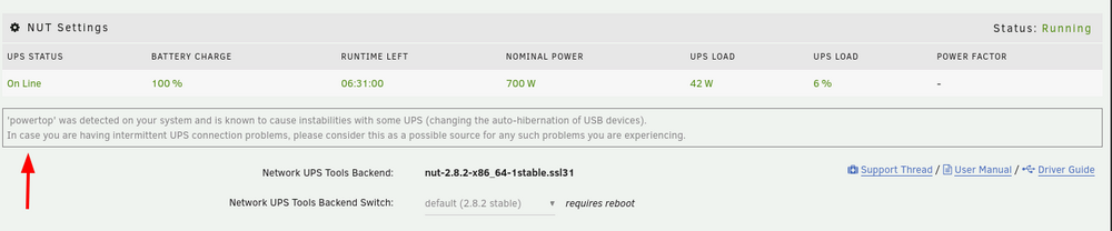

Would it be possible to make this message also Dismiss-able:
Another idea from my side would be to make the plugin use tabs and to put the Controll Center in another tab (don't know if you like that but I think that would be super cool and would make the plugin page more accessible) :
Sure, I will add both (valid and good) suggestions in the next update.

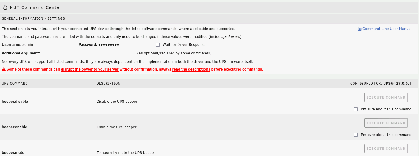

To be honest on the machine I developed the command center on, the connected UPS had only like 4 or so commands available. After updating NUT on my production server, I saw that my Eaton UPS had around 15... and now it does seem a bit too much to have all that on on page. 😄
Same over here, the page is now reeaaaaaally long... :)

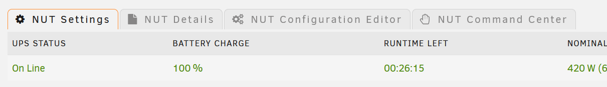

Don't know if you want to do that and not how much work that would be but split all into tabs because with that you have a really good overview.
NUT Settings | Display Settings | NUT Details | NUT Configuration Editor | NUT Command Center
...again, just an idea and not sure if it makes sense to split everything into it's own tab.
This is already kind of implemented and depends on the user's "Display Settings" (Unraid-wide ones):
... which (now that I remember) was I think also the reason I put the command center on this page.
... or do you mean a setting to override the Unraid-wide tabbing settings just for this (long) plugin? 🙂
Not sure how easy that would be because the tabbing seems to happen before the page building...
Yes that's true, I'm also not sure how hard that would be for your plugin.
In my opinion it looks better organized when not everything is on one page.
Not sure how much work that would be because you would have to split everything onto it's own dedicated page but since you have Apply and Save buttons for every page I assume it would be not too hard.
I don't have a Ultra wide, just a big montior. :D
There are plenty of plugins (e.g appdata backup) that have tabs, should be possible :)

I mean it is already possible to switch NUT to tabbed mode, the behaviour just follows the OS settings and system-wide user preference. If you set Settings => Display Settings => Page view: Tabbed, then you will have NUT tabbed as well. 🙂 If not, then you will have it all on one page... I don't really want to override the OS setting because everyone has a different taste and this way the user can decide (for all the OS). So NUT already has separate *.page files for all the pages, it's the OS (and that setting) which decide how to show everything to the user.
2 minutes ago, Rysz said:
If you set Settings => Display Settings => Page view: Tabbed then you will have NUT tabbed as well. 🙂
Thanks for the hint, didn't know that this is a thing... :D
NUT already has every *.page set out for both settings, the OS decides (and that setting) decides how to show everything.
Okay, then it should be pretty easy to change that but since the tabbed view is already there I don't know if that's necessary... That's up to you. :)
I prefer a non tabbed view and change via display settings if required so I think this is the correct approach

Yes, I think it's best we leave this to the user preference via the system-wide "Display Settings".
In any case, both tabbed/non-tabbed are already supported by the plugin depending on the OS setting.
But will put the "NUT Command Center" on a separate page for logical separation (and sheer length). 🙂
14 minutes ago, Owerrride said:
Hello everyone, please tell me how to fix the problem with the UPS (ups.model Back-UPS BX750MI) not remembering the setting to turn off the beeper. In the NUT settings, I press the button to run the script to turn off the beeper, go and disconnect the UPS from the network, the first time it turns off the server and turns off itself without sound, but after power is supplied to the UPS, the sound returns.
As this is a very entry-level UPS series (with limited firmware compatibility), it probably doesn't store the setting somewhere on a chip when it's turned off - this is unfortunately outside of NUT's control.
I apologize if this has already been asked but I cant find it anywhere.  I want to use NUT to send a shutdown command to my UDM Pro but I cant figure out how to go about doing it.  I figure that I have to write a script to ssh into the router and send a shutdown command at a given power state but I have no idea how make that work in the plugin.  Does anyone know how to make this work?
Can I make user script and when unraid start always use script to turn off the beeper? Can you write this command and I make script. Thank you
Yes, which command do you use on your UPS - beeper.disable or beeper.mute?
