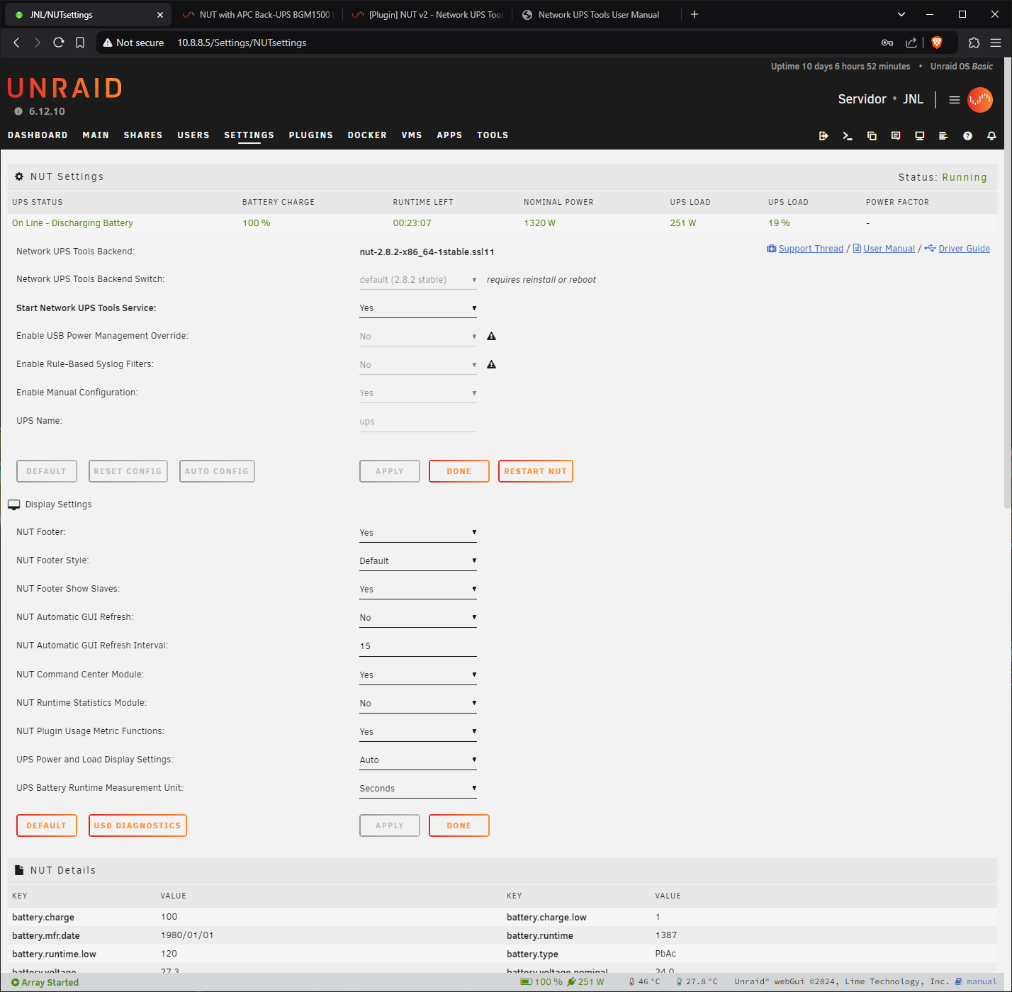

Need your help guys.
Where can i find the option to set the shutdown mode? I wanted to set it to shutdown at 20% battery left but i'm not finding the option.
These options are not available in manual configuration mode (which is just "bare NUT" without extras). If you are in manual configuration mode because your UPS needs special settings within UPS.CONF, you can switch to "Enable Manual Configuration": "For UPS Driver", where you can keep a custom UPS.CONF, but still have the rest controlled via the GUI (and those options also available).
Thanks! Didn't noticed the manual configuration was on.
