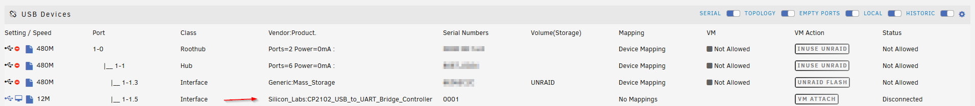

For UPS Port, put the path to the serial device.
I'm not sure about how can I do this. How do I know the path (sorry for that dumb question).
I installed the USB Manager Plugin with the USB Manager Serial Options addon but there is also no option to show the path.
Can you help me out?
From the log of the device:
USB to Serial cable are always confusing :(

4 minutes ago, Rysz said:
NUT didn't detect the UPS, but you can try setting "UPS Port" to "/dev/ttyUSB0".
Please let me know if you had any luck with that. 🙂

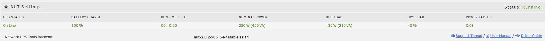

5 minutes ago, kitharo said:
Hi Rysz,
you saved my sunday! Thank you very much!

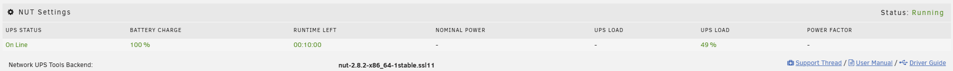

No problem, I'm glad that it works for you - can you do me a favour and post a screenshot of the GUI dashboard? I mean this part, at least how it looks for you:
I just saw your UPS reports some values as floating point, so I might need to fix the display for the next NUT version. Ideally, if you can - please also attach the NUT Debug Package (fetch a new one from the NUT Settings). 🙂

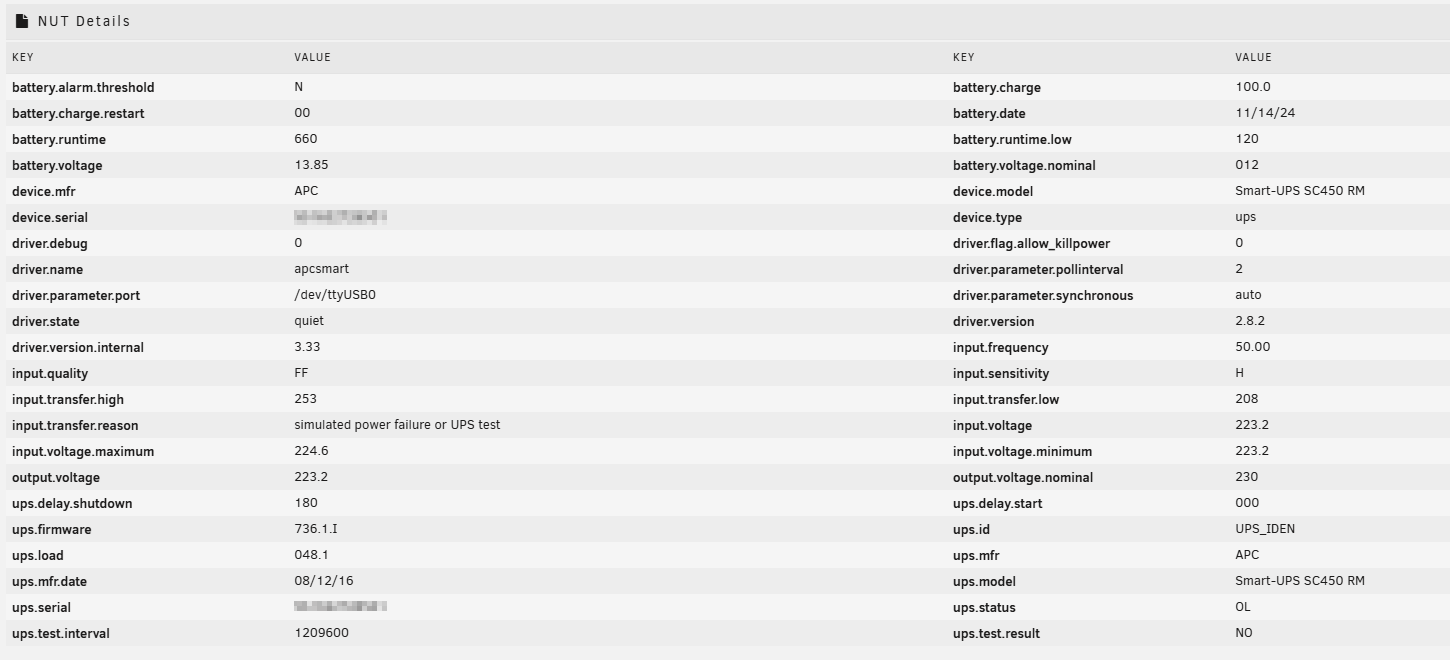

This part, at least how it looks for you:
Here it is:

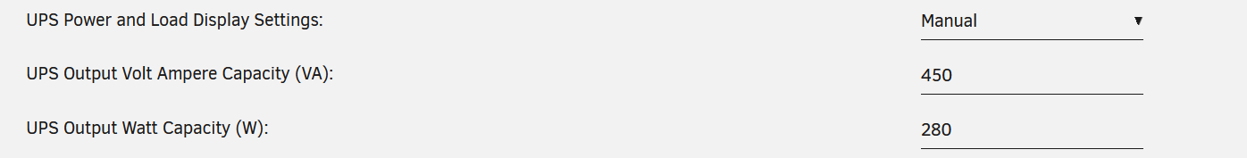

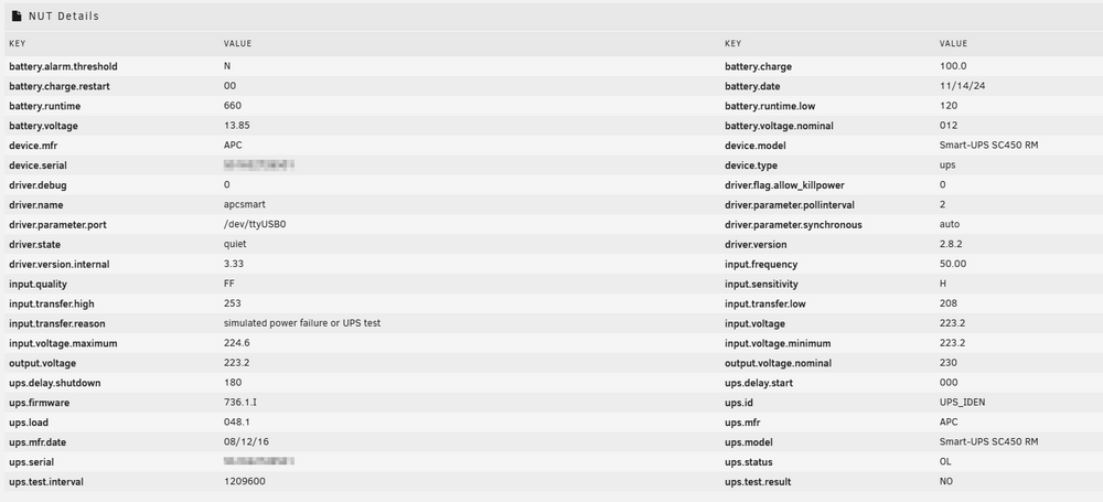

1 minute ago, kitharo said:
Here it is:
Great, I can help you fill the missing variables - set your settings like this:
Please let me know if that worked for you and filled in the rest of the fields 🙂
It does! Thank you very much!

Do you happen to have any other recommendations?
Realistically, it seems to work as intended minus randomly giving a bunch of those errors, so I'm not extraordinarily concerned, but still would like to fix it if I could
