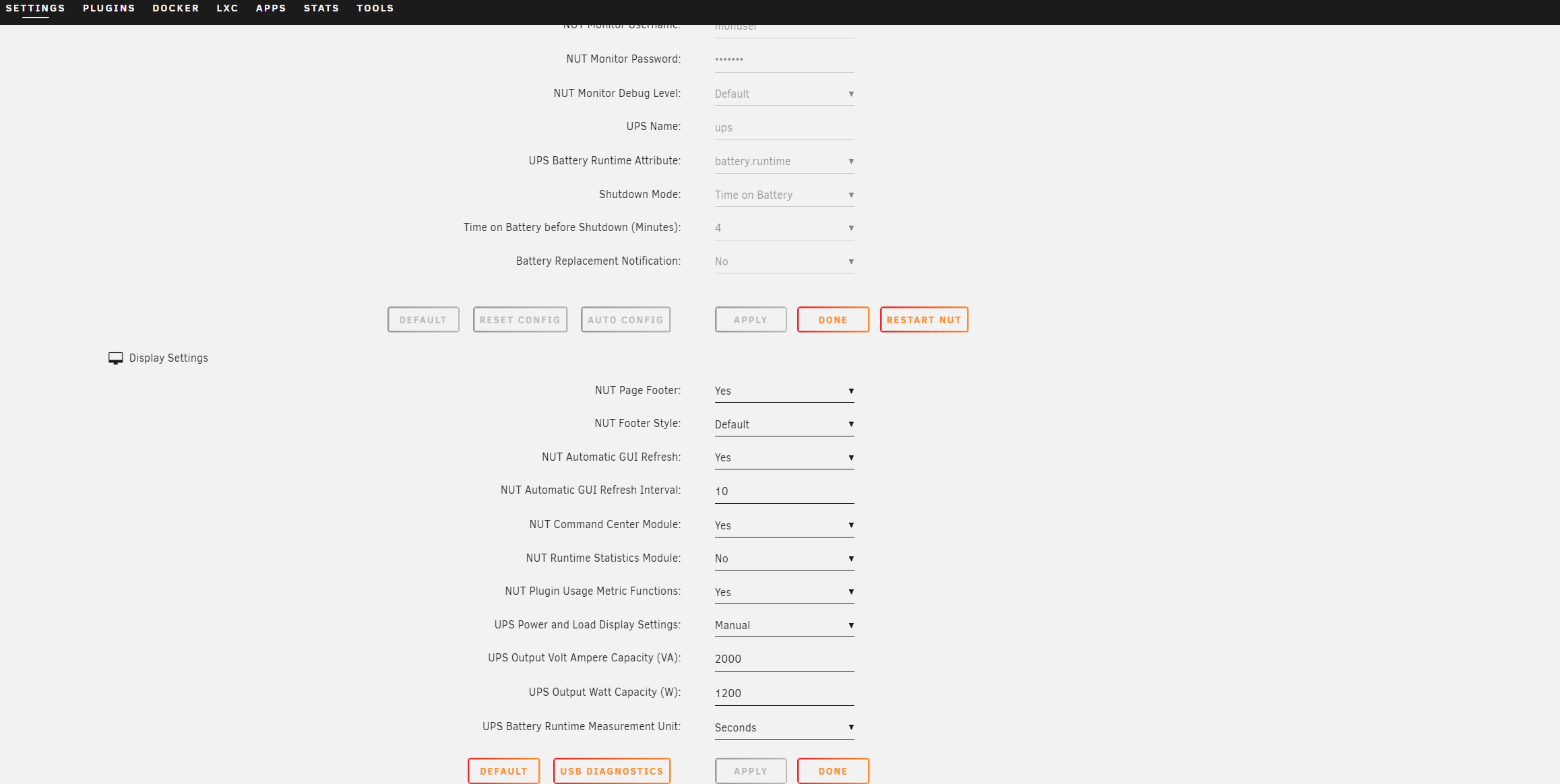

On 9/28/2024 at 11:09 AM, SimonF said:
Can the UPS commands be made optional via a setting. Also I think should be in User tools at the bottom rather than System Settings part.
Done (included in today's update). 🙂
