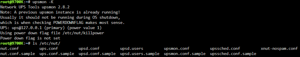

Does upsmon -k have meaningful message ? There are no "no_killpower" or "killpower" file in /etc/nut/
And FSD just got message and actually won't shutdown UPS.
EDIT : Actually it would shutdown UPS but also shutdown Unraid first.
Edited by Vr2Io
20 minutes ago, Vr2Io said:
Try "allow_killpower = 1" or "allow_killpower = yes", "driver.flag.allow_killpower" still "0" and submit command also no action.
I think this is a bug, I've opened an issue on GitHub - you can follow it here:
https://github.com/networkupstools/nut/issues/2605
The upsmon -k command has a different function, it won't help us here, I'm afraid.

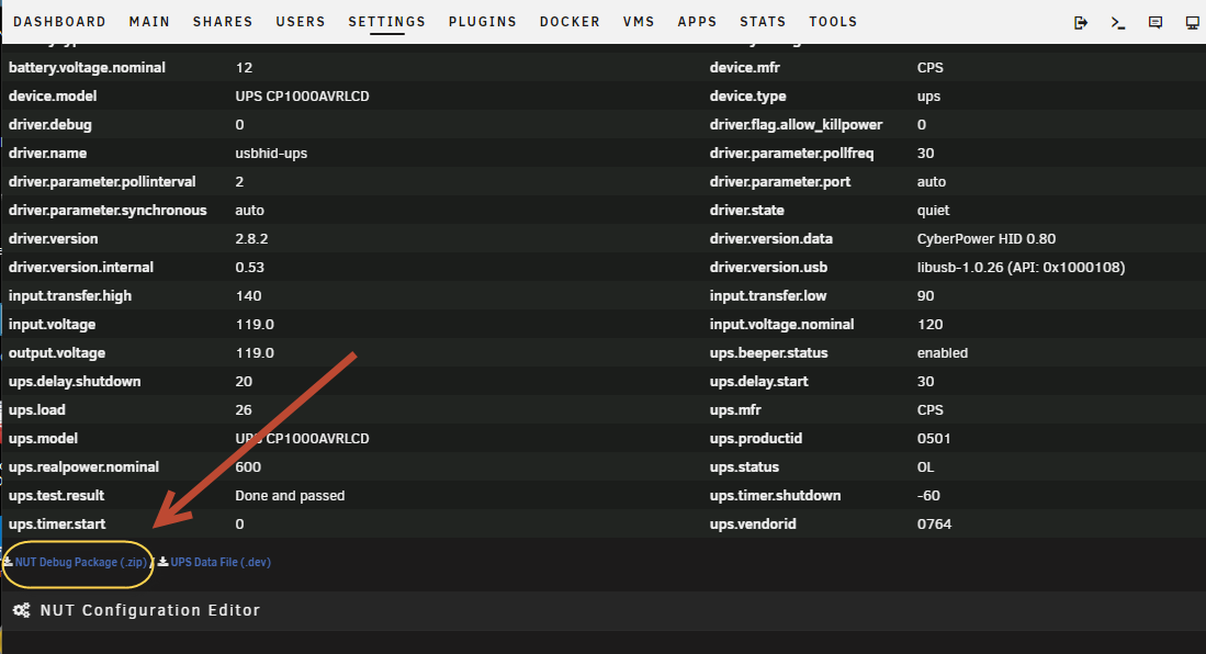

Please post the NUT Debug Package that can be found in NUT Settings.
from Rysz ...
Great, glad you got it working. If it fails again, please don't uninstall the plugin, but download the "NUT Debug Package" from "NUT Settings" and post here again before doing anything else. 🙂
Foe those who don't know I founD what Rysz was referring to for "NUT Debug Package" from "NUT Settings" ...
I had to look hard for it ...  😁
thought I'd share as I did not see it right away.
thanks,
E
