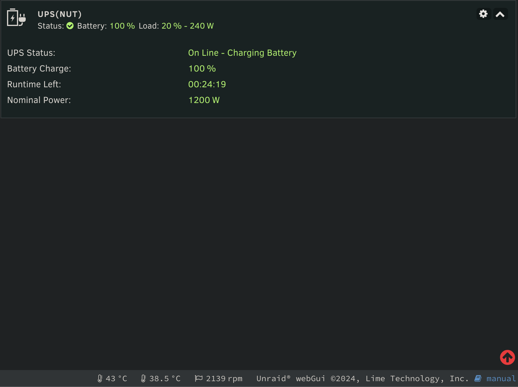

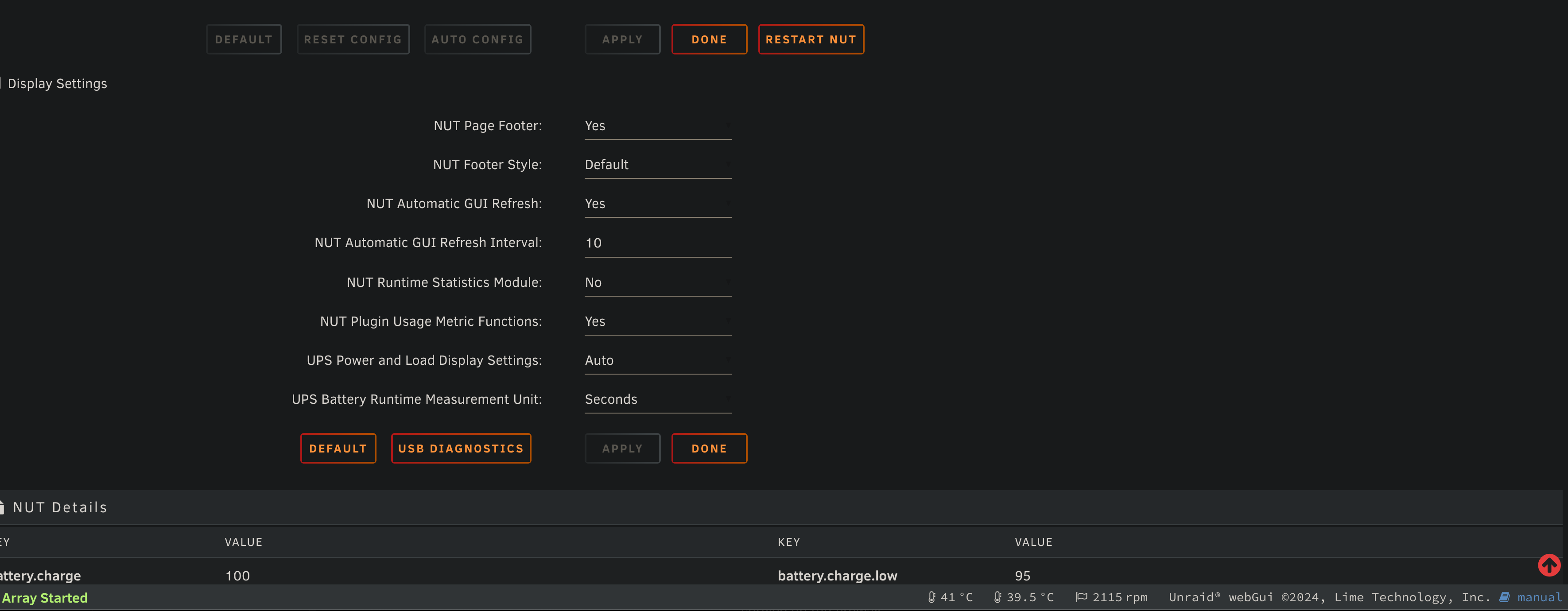

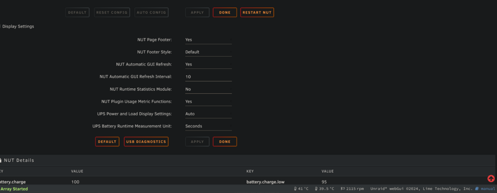

The footer is no longer displaying battery percentages anymore. Is this a bug? The feature is enabled so I don't know why this is happening. The dashboard shows the status just fine.
It works for me, what OS version are you on?
Did you try turning "NUT Page Footer" to "No" => Apply => "Yes"?
Did you try with another browser or after clearing your browser cache?
... or reinstalling the plugin (doesn't affect configuration), to see if that solves the problem for you?
