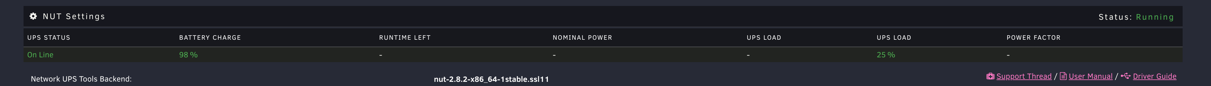

I have a intellipower UPS (IHT1500RM-DI-Isol-FC-399) connected to my network I'm trying to connect to my server. I can't seem to figure out how to point NUT to the UPS's IP 10.10.111.112.

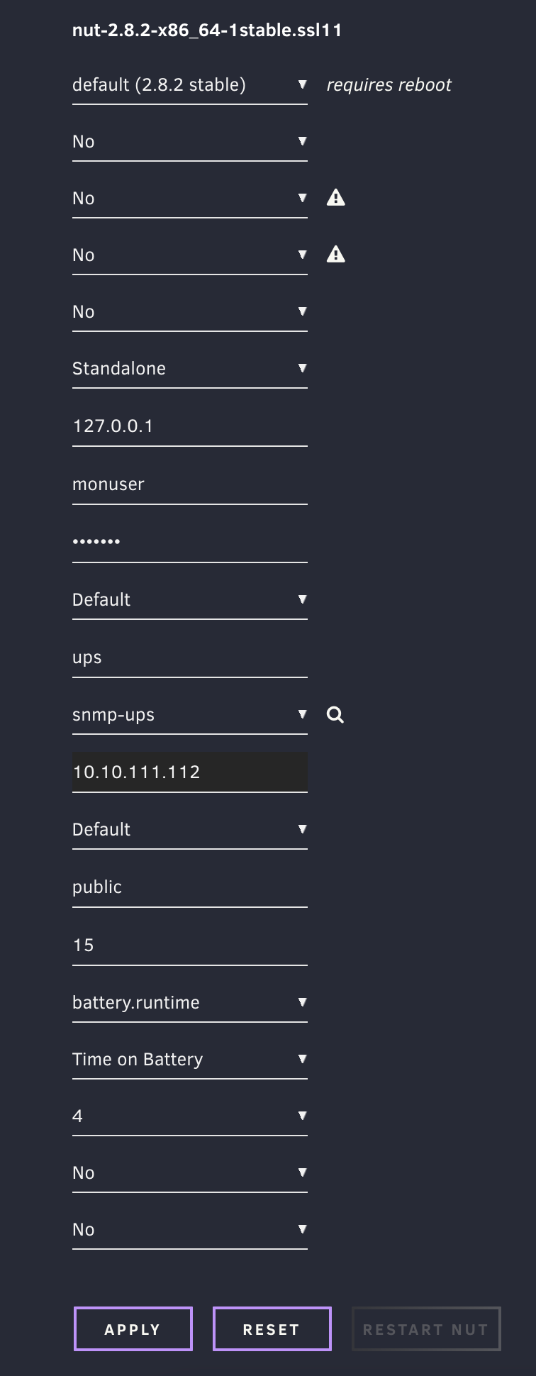

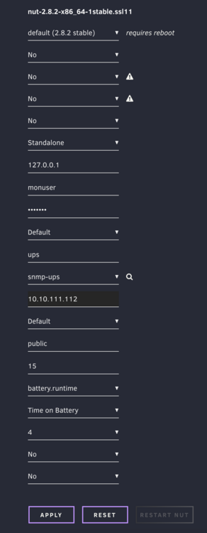

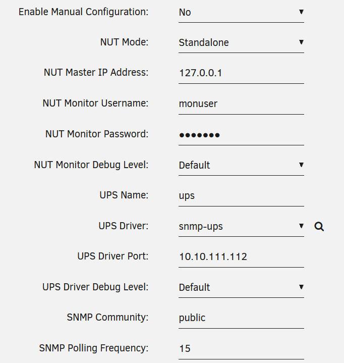

Usually you would set up the SNMP network connection like this:
Note that if that doesn't work, SNMP might need to be enabled on the UPS.
It should say in the manual how to do that via the web interface exposed by the UPS.

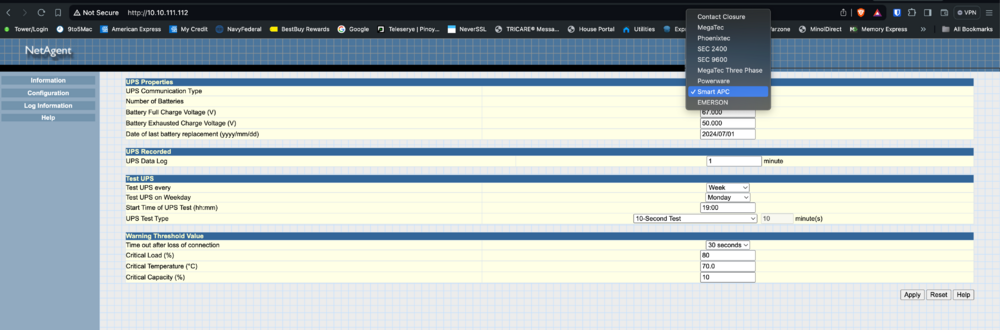

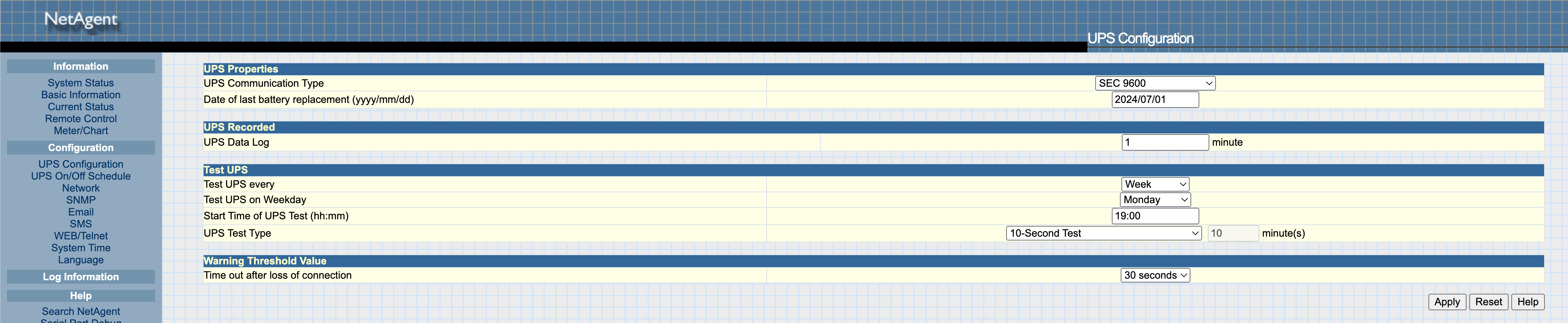

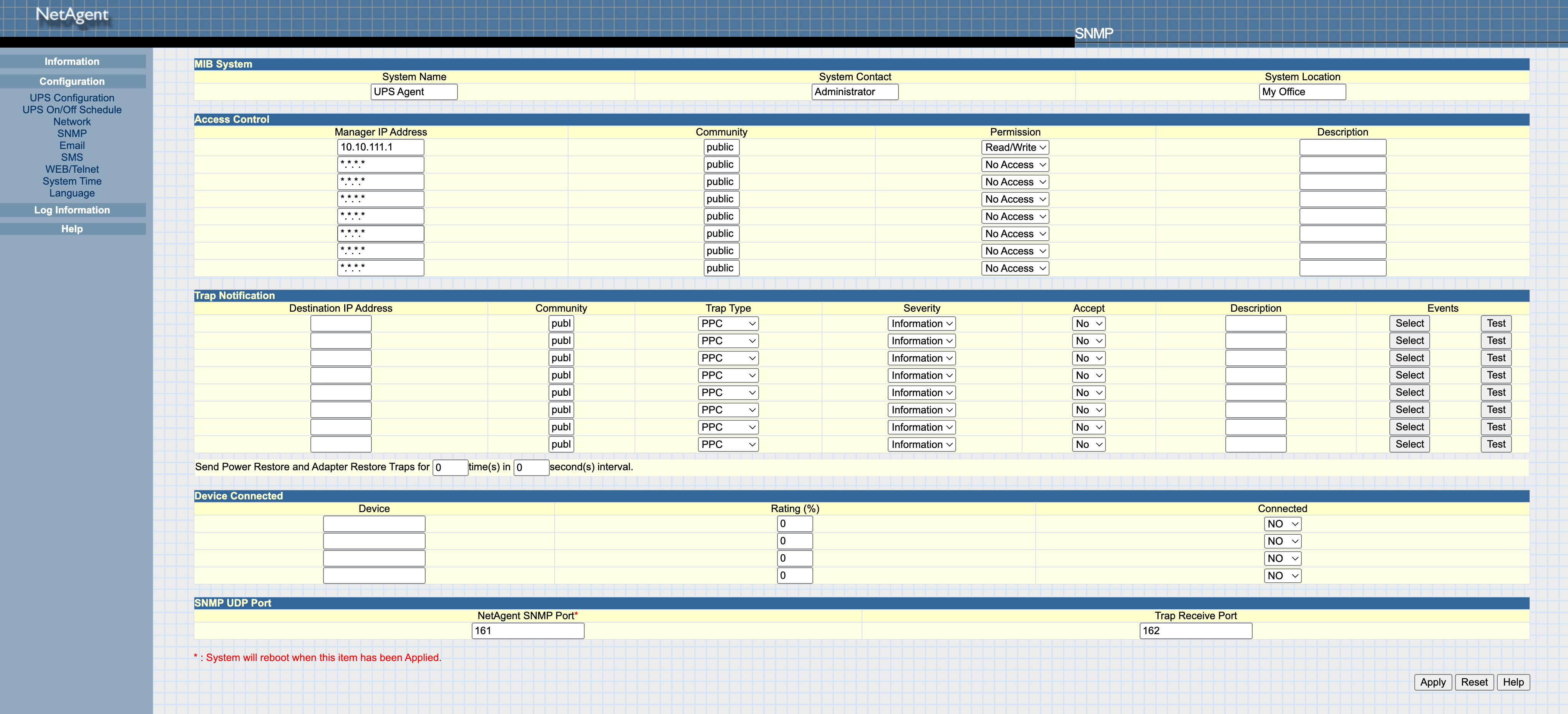

When you click on "Configuration" in the UPS web interface, are there any settings related to SNMP?

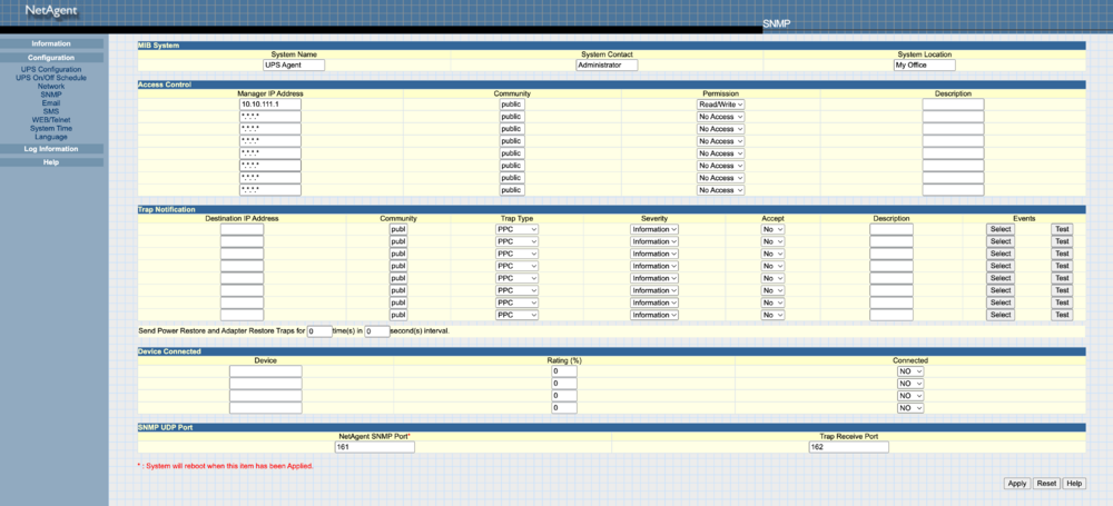

6 minutes ago, peace-keeping-villa8590 said:
In the second field under "Access Control" (for *.*.*.*) change the Permission to "Read/Write".

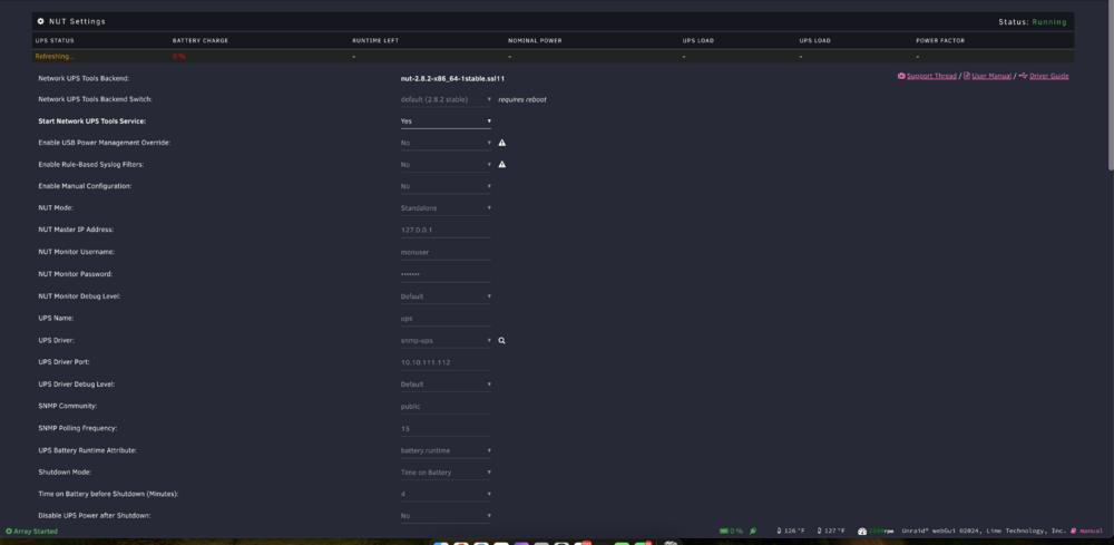

Then click "Apply" and then try again with the settings for NUT that I posted above - let me know.
Note that in NUT you need to set "Start Network UPS Tools Service:" to "Yes" and click "Apply" after.
Edited by Rysz
I changed the "Manager IP Address" to the IP of Unraid and it was already set to read/write, clicked apply. In Nut Settings, I just changed "Start Network UPS Tools Service:" to yes and clicked apply. It is showing some details but not much.
That's not enough information for NUT to operate.

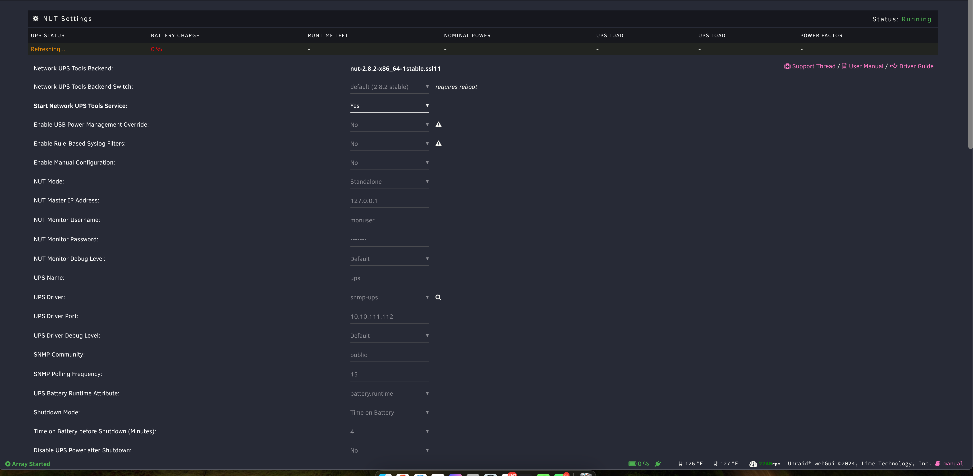

1 hour ago, peace-keeping-villa8590 said:

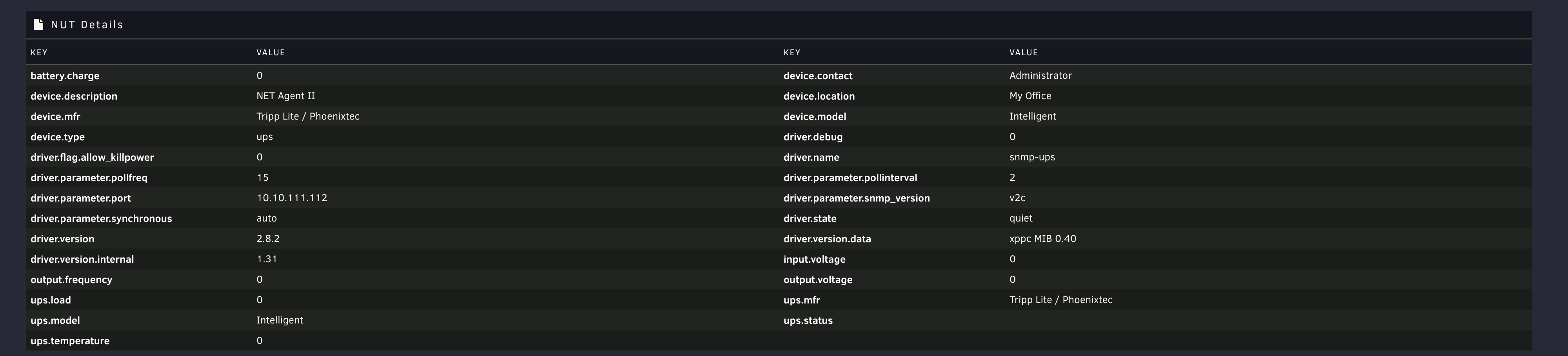

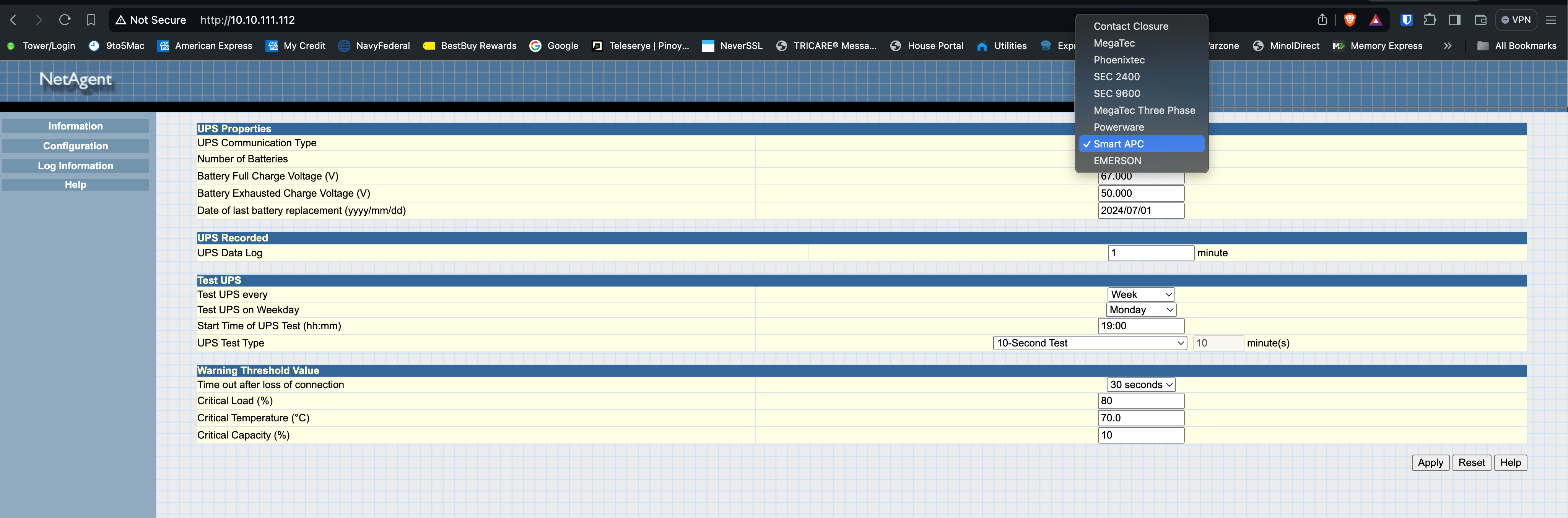

Did you change anything for "UPS Communication Type" ?

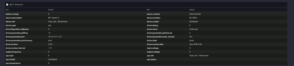

Seems the UPS network card can't read the values from the UPS.
I tried changing it to Phoenixtek and restarted NUT since it's listed in the NUT Details but it didn't change anything.
You'll have to try all the "UPS Communication Type" until you find one that provides more details.
The problem is not between NUT and the UPS network card, but the UPS network card and UPS itself.
Please let us know if you found a setting that has worked for you.
I was able to make more progress. When I first used these setting, it said "calculating" for a while but the this morning, it went away and now says "on-line". SEC 9600 gave me the most information.
How does one determine the health of the battery using NUT? I don't think my UPS displays battery health on the LCD screen and I don't want to do the ol' pull the plug from the wall trick to test.
Great, those values will be enough for shutdown modes "Time on Battery" (recommended) and "Battery Level".
If you set these settings in NUT Settings, you will also see the now missing power consumption in the dashboard:

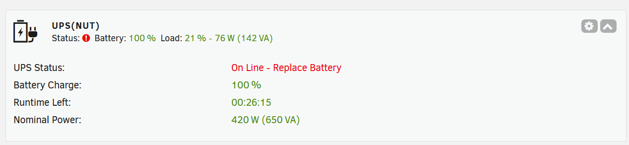

No, I'm saying there's no way to measure the battery health, just if the UPS considers it to be replaced or not.
You can check and trigger commands for your UPS with upscmd (via command line):
https://networkupstools.org/docs/man/upscmd.html

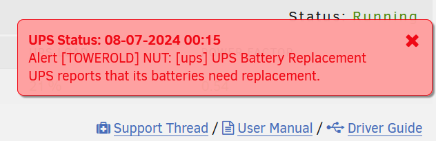

But the UPS should always report a to be replaced battery via emitting a respective status and alert, at least as part of their periodic self-tests (and most do), which require no user interaction and need not be triggered manually. A to be replaced battery would hence be permanently visible in the GUI with a "RB" status, e.g. "OL RB", "OB RB":
If you have battery replacement notifications enabled, you'll also receive this notification:

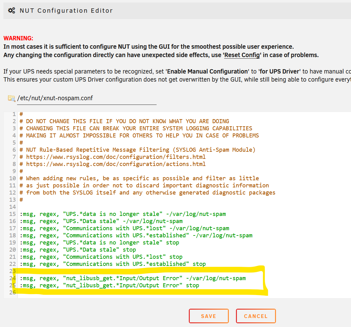

My syslog is absolutely FULL of nut errors:
Jul 14 20:10:06 PurpleCloud usbhid-ups[30087]: nut_libusb_get_report: Input/Output Error
Jul 14 20:10:08 PurpleCloud usbhid-ups[30087]: nut_libusb_get_string: Input/Output Error
Over and over again, has anyone encountered this/know a fix?  Googling hasn't turned up anything conclusive unfortunately, nut is working perfectly fine otherwise just a ton of these errors continuously
Edited by MTerracciano
Hello!
This is unfortunately the result of minor driver connection instabilities, nothing we can do about it.
It's good that everything else works normally though, so you can just filter out these SYSLOG messages.
1) Put these lines at the end of xnut-nospam.conf using NUT Configuration Editor in GUI:
:msg, regex, "nut_libusb_get.*Input/Output Error" -/var/log/nut-spam
:msg, regex, "nut_libusb_get.*Input/Output Error" stop
2) So it will look like this - click "Save":
3) Set "Enable Rule-Based Syslog Filters:" to "Yes" in NUT Settings:
4) Click "Apply" and these messages should now no longer appear in your SYSLOG.
Please note this will only be applied to new messages, the old ones will still be visible in SYSLOG.
Please let me know if that worked for you! 🙂

9 hours ago, Rysz said:
Hello!
Can't thank you enough, that fixed it for me!
