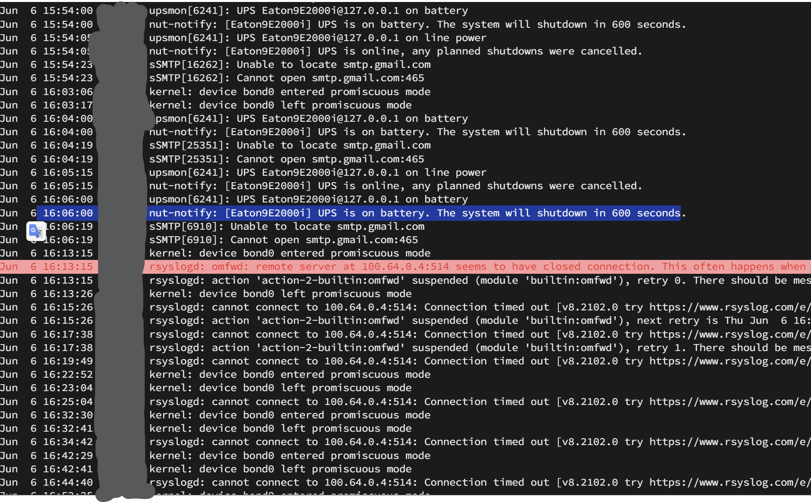

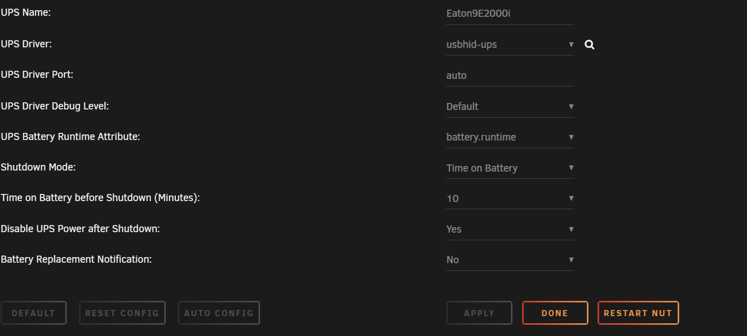

@Rysz Today i had a lot of time power off/on at home and found my server with NUT not goes to power off + disable ups power  after 10min as in settings:

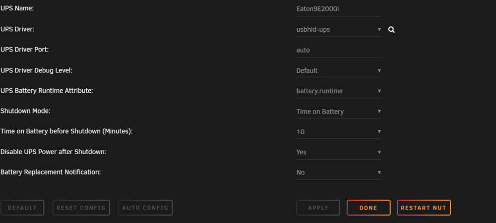

Here is a screen cap of the settings in the UI:
I just tested a 10 minute timeout on my server, it shut down just fine... not sure what happened there.
7 hours ago, drwatson said:
I am having a problem starting the NUT service for my UPS. I am not quite sure what I'm missing, but I've tried to follow other's advice and try different drivers other than usbhid-ups, but none seem to work.
Can someone help me figure out what I need to change to get this working?
I am running nut-2.8.0-x86_64-2stable.ssl11 on Unraid Version 6.11.5. I have a USB connected CyberPower UPS (cp1500 AVR LCD) only servicing the Unraid server (no master/slave required).

Please post the NUT Debug Package found in NUT Settings.

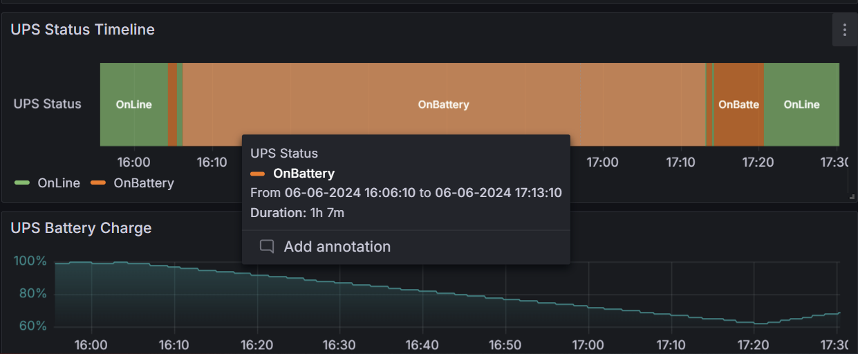

I'm also tested befor it was working fine. But if power off/on many time and timer counter on/off then somehow it's broked
Shouldn't happen even with lots of power cycling going on, but hard to diagnose after the fact. In any case I couldn't reproduce this on my testing machines, so hopefully an isolated incident not to be repeated.
just in case i will want to simulate this incident ( i can switch power off/on in computers space by switches on the power wall )
i need UPS Driver Debug Level = debug and maybe set 5 min to power off for test or something else  ?

21 minutes ago, fezster said:
@Rysz Different question here to above. I had NUT restarting every hour, as I said in my post a few days ago, to see if that would resolve the staleness/disconnects. This restart has been working fine for the past few days.
However - this morning, I realised my UPS had reported on battery and the server had shutdown. I did not have any power outage. Looking at the previous syslog (which is helpfully saved on the flash), it looks like after NUT restarted, the UPS reported on battery for some reason. Have you ever come across this?
Jun  9 08:47:01 SM1 root: Stopping the NUT services...
Jun  9 08:47:01 SM1 upsmon[2921]: Signal 15: exiting
Jun  9 08:47:01 SM1 root: Network UPS Tools upsmon 2.8.2
Jun  9 08:47:01 SM1 upsd[2918]: User [email protected] logged out from UPS [ups]
Jun  9 08:47:02 SM1 upsd[2918]: mainloop: Interrupted system call
Jun  9 08:47:02 SM1 upsd[2918]: Signal 15: exiting
Jun  9 08:47:02 SM1 root: Network UPS Tools upsd 2.8.2
Jun  9 08:47:04 SM1 usbhid-ups[2912]: Signal 15: exiting
Jun  9 08:47:04 SM1 usbhid-ups[2912]: WARNING: send_to_all: write 38 bytes to socket 13 failed (ret=-1), disconnecting: Broken pipe
Jun  9 08:47:05 SM1 root: fopen /var/run/nut/usbhid-ups-ups.pid: No such file or directory
Jun  9 08:47:05 SM1 root: Network UPS Tools - UPS driver controller 2.8.2
Jun  9 08:47:08 SM1 root: WARNING: NUT was user-configured to disable power management for all USB devices.
Jun  9 08:47:08 SM1 root: WARNING: NUT is now forcing all USB devices to permanent [on] power state as requested...
Jun  9 08:47:09 SM1 root: Writing NUT configuration...
Jun  9 08:47:11 SM1 root: Updating permissions for NUT...
Jun  9 08:47:11 SM1 root: Checking if the NUT Runtime Statistics Module should be enabled...
Jun  9 08:47:11 SM1 root: Disabling the NUT Runtime Statistics Module...
Jun  9 08:47:12 SM1 root: Using subdriver: CyberPower HID 0.80
Jun  9 08:47:12 SM1 root: Network UPS Tools - Generic HID driver 0.53 (2.8.2)
Jun  9 08:47:12 SM1 root: USB communication driver (libusb 1.0) 0.47
Jun  9 08:47:14 SM1 root: using 'battery.charge' to set battery low state
Jun  9 08:47:14 SM1 usbhid-ups[19996]: using 'battery.charge' to set battery low state
Jun  9 08:47:14 SM1 usbhid-ups[19996]: using 'battery.runtime' to set battery low state
Jun  9 08:47:14 SM1 root: using 'battery.runtime' to set battery low state
Jun  9 08:47:14 SM1 usbhid-ups[20002]: Startup successful
Jun  9 08:47:14 SM1 root: Network UPS Tools - UPS driver controller 2.8.2
Jun  9 08:47:15 SM1 root: fopen /var/run/nut/upsd.pid: No such file or directory
Jun  9 08:47:15 SM1 root: Could not find PID file '/var/run/nut/upsd.pid' to see if previous upsd instance is already running!
Jun  9 08:47:15 SM1 root: listening on 0.0.0.0 port 3493
Jun  9 08:47:15 SM1 upsd[20007]: listening on 0.0.0.0 port 3493
Jun  9 08:47:15 SM1 upsd[20007]: Connected to UPS [ups]: usbhid-ups-ups
Jun  9 08:47:15 SM1 root: Connected to UPS [ups]: usbhid-ups-ups
Jun  9 08:47:15 SM1 usbhid-ups[20002]: sock_connect: enabling asynchronous mode (auto)
Jun  9 08:47:15 SM1 upsd[20007]: Found 1 UPS defined in ups.conf
Jun  9 08:47:15 SM1 root: Found 1 UPS defined in ups.conf
Jun  9 08:47:15 SM1 upsd[20008]: Startup successful
Jun  9 08:47:15 SM1 root: fopen /var/run/nut/upsmon.pid: No such file or directory
Jun  9 08:47:15 SM1 root: Could not find PID file to see if previous upsmon instance is already running!
Jun  9 08:47:15 SM1 root: UPS: [email protected] (primary) (power value 1)
Jun  9 08:47:15 SM1 root: Using power down flag file /etc/nut/killpower
Jun  9 08:47:15 SM1 upsmon[20011]: Startup successful
Jun  9 08:47:15 SM1 upsmon[20011]: Warning: running as one big root process by request (upsmon -p)
Jun  9 08:47:15 SM1 upsd[20008]: User [email protected] logged into UPS [ups]
Jun  9 08:47:15 SM1 upsmon[20011]: UPS [email protected] on battery
Jun  9 08:47:15 SM1 nut-notify: [ups] UPS is on battery. The system will shutdown in 180 seconds.
I'm not sure why your UPS would report that if the mains power was not gone, perhaps the input power quality (voltage/frequency) was degraded (e.g. as seen in a brownout situation) and the UPS considered it necessary to switch to battery power because of that.
The state seems to have persisted long enough (180 seconds) to cause the shutdown, but this is something that the UPS will have continuously reported to NUT (so it shouldn't have anything to do with the driver start).
Edited by Rysz
