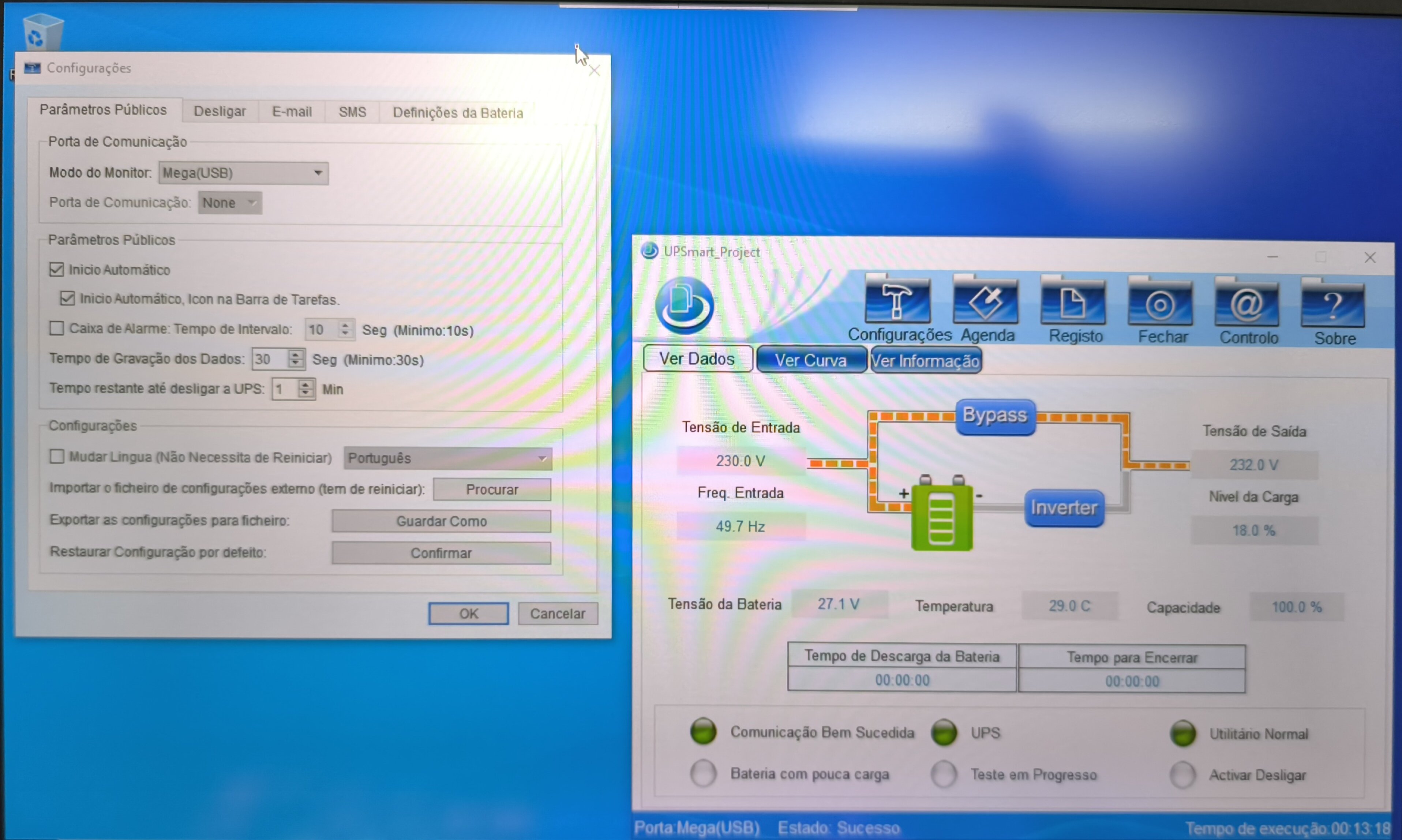

some one uses a UPS from EuroTech?
EuroTech UPS2000VA
[nutdev1]
driver = "nutdrv_qx"
port = "auto"
vendorid = "0001"
productid = "0000"
bus = "001"
May  4 15:19:59 PCPAI-HOME ool www[28452]: /usr/local/emhttp/plugins/nut-dw/scripts/start
May  4 15:20:00 PCPAI-HOME rc.nut: Writing NUT configuration...
May  4 15:20:02 PCPAI-HOME rc.nut: Updating permissions for NUT...
May  4 15:20:02 PCPAI-HOME rc.nut: Checking if the NUT Runtime Statistics Module should be enabled...
May  4 15:20:02 PCPAI-HOME rc.nut: Disabling the NUT Runtime Statistics Module...
May  4 15:20:09 PCPAI-HOME rc.nut: Device not supported!

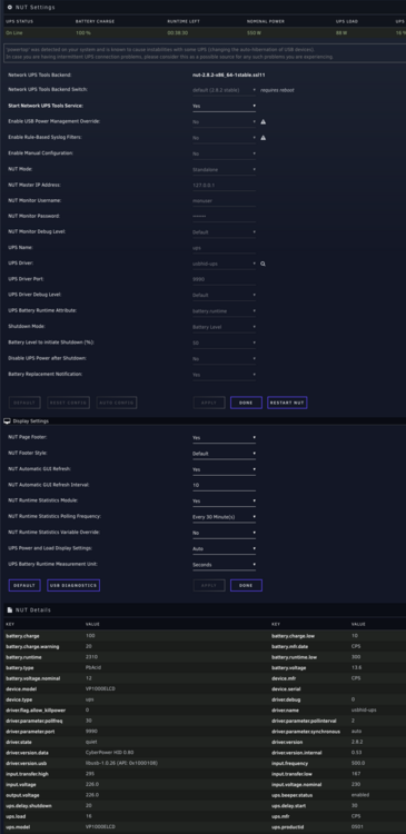

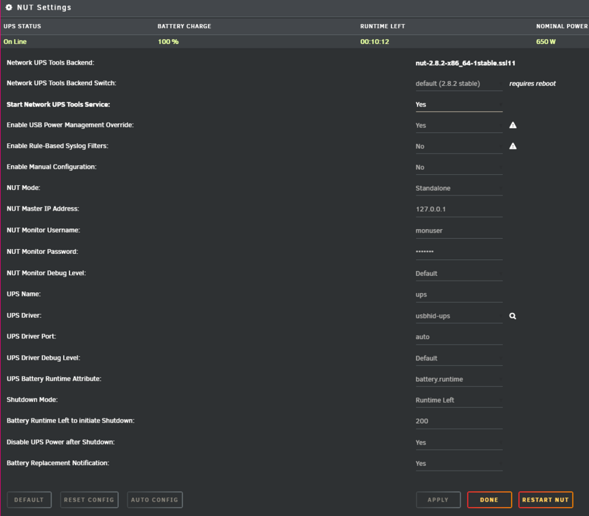

Hi Everyone,
I have question about Back-UPS XS 1300G Battery upgrades. My original batteries died and i replaced them with lead acid batteries different capacity ( much higher ) and same voltage. Is it possible to " explain" to UPS that need s to calculate estimated times for battery life time? It reports 1:15 minutes on 24V 130AH batteries. Also, what is the format of command in upc.conf that i can change battery manufacture date? i tried "battery.mfr.date : 2023/06/10" , battery.mfr.date = 2023/06/10 but that just disables plugin.
Sorry, im new in all this and my programming skils are limited with copy and paste. However, i would like to extend UPS backup time .
Any help is appreciated,
Best Regards,
Tim
itjtower-diagnostics-20240508-1107.zip
15 hours ago, Tim_J said:
Hi Everyone,
Best Regards,
Tim
Sorry, I can't provide support for usage cases outside of manufacturer's specifications. For safety reasons and from experience I'd also strongly advise against using any different battery capacity than those your UPS was rated for by the UPS manufacturer. The electrical mechanisms in the UPS may not safely be able to charge and/or discharge the higher capacity battery you are using, which may be hazardous for several reasons (fire, electrical shock, ...)
Edited by Rysz
Understood.
Thank you for responding,
Best Regards
Depending on how the UPS calculates level you might want to just go based on battery charge % instead of estimated time. Gonna need experimentation to find the right values obviously.
Also monitor your UPS' temperature, it might not have adequate cooling for operating that much longer than designed. Often unless it's designed to take additional external batteries the fact it can't be running longer than X time at Y load is kinda factored in the thermals.
Edited by Kilrah

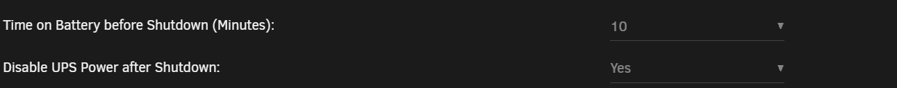

What the right command for fsd (shutdown) the ups and server and all connected pc ,if i dont want to wait 10 min
as i have in setting Time on Battery before Shutdown (Minutes): 10 ?
/etc/rc.d/rc.nut shutdown 2>&1 | logger -t "rc.nut"
Use this command to start the NUT shutdown routine now:
upsmon -c fsd
The command you posted would result in an unclean shutdown because it would kill the power instantly.
upsmon -c fsd
OK, i just tryed to find in code what command running in plugin for : image.thumb.png.b4c76c7cba6dadd73dec4859ecbcdeda.png
is also good ?
upscmd shutdown.return - Turn off the load and return when power is back
is also good ?
No, because this will also kill the power of the UPS instantly and result in an unclean shutdown on all your clients and server. Always use only this command to trigger the NUT shutdown routine: It ensures a clean shutdown of your clients and your server, will also disable the UPS power (if that is configured in the GUI) after the clean shutdown and start the UPS again when the power is back.
upsmon -c fsd
Edited by Rysz

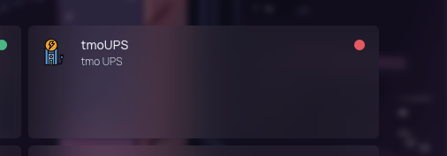

Hello guys,
Does anyone of you run NetworkUPS Tools with the PeaNUT Homepage integration?  I had it working in the past when i was trying out an ACP UPS. However, with my Cyberpower UPS (way lower idle draw from the UPS itself) I cannot get this widget to work.
Any ideas what i might have configured wrong?
https://gethomepage.dev/latest/widgets/services/peanut/
      - tmoUPS:
            icon: https://cdn-icons-png.flaticon.com/512/2138/2138730.png
            description: tmo UPS
            siteMonitor: http://192.168.178.200:9990
            statusStyle: "dot"
            widget:
                type: peanut
                url: http://192.168.178.200:9990
                key: ups
                fields: ["battery_charge", "ups_load", "ups_status"]

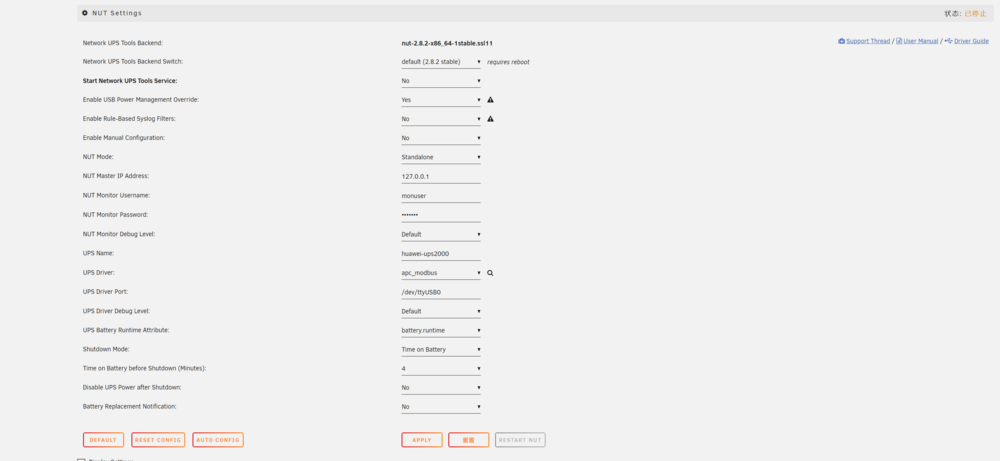

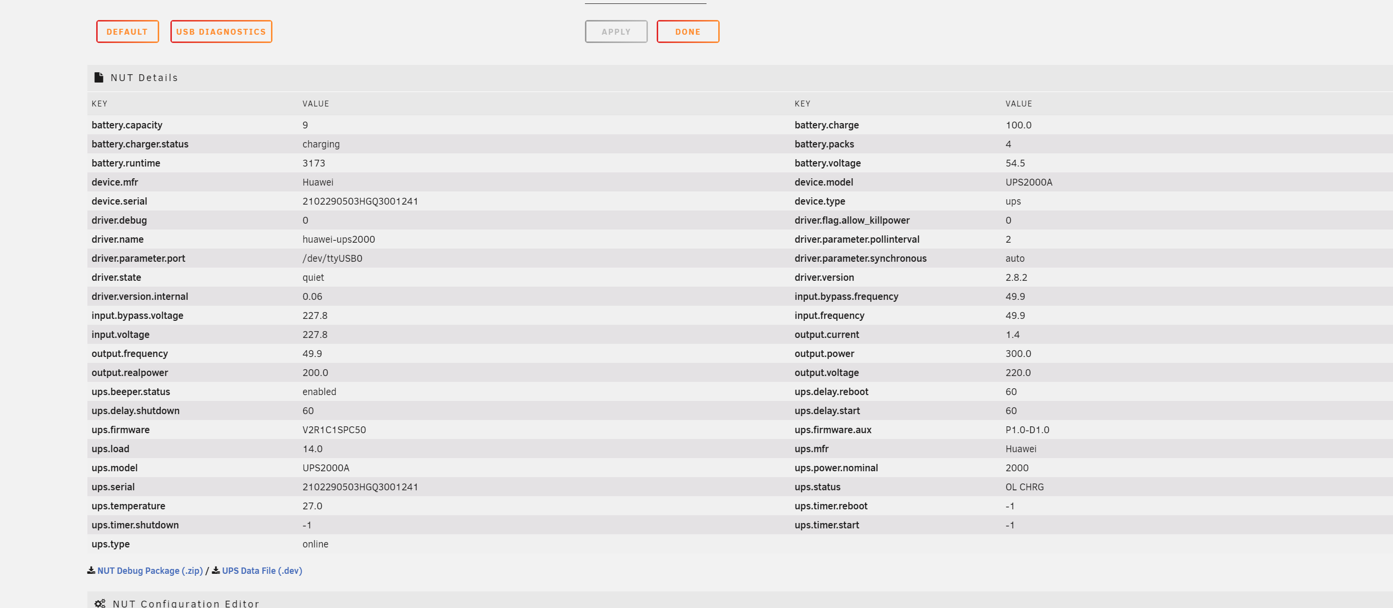

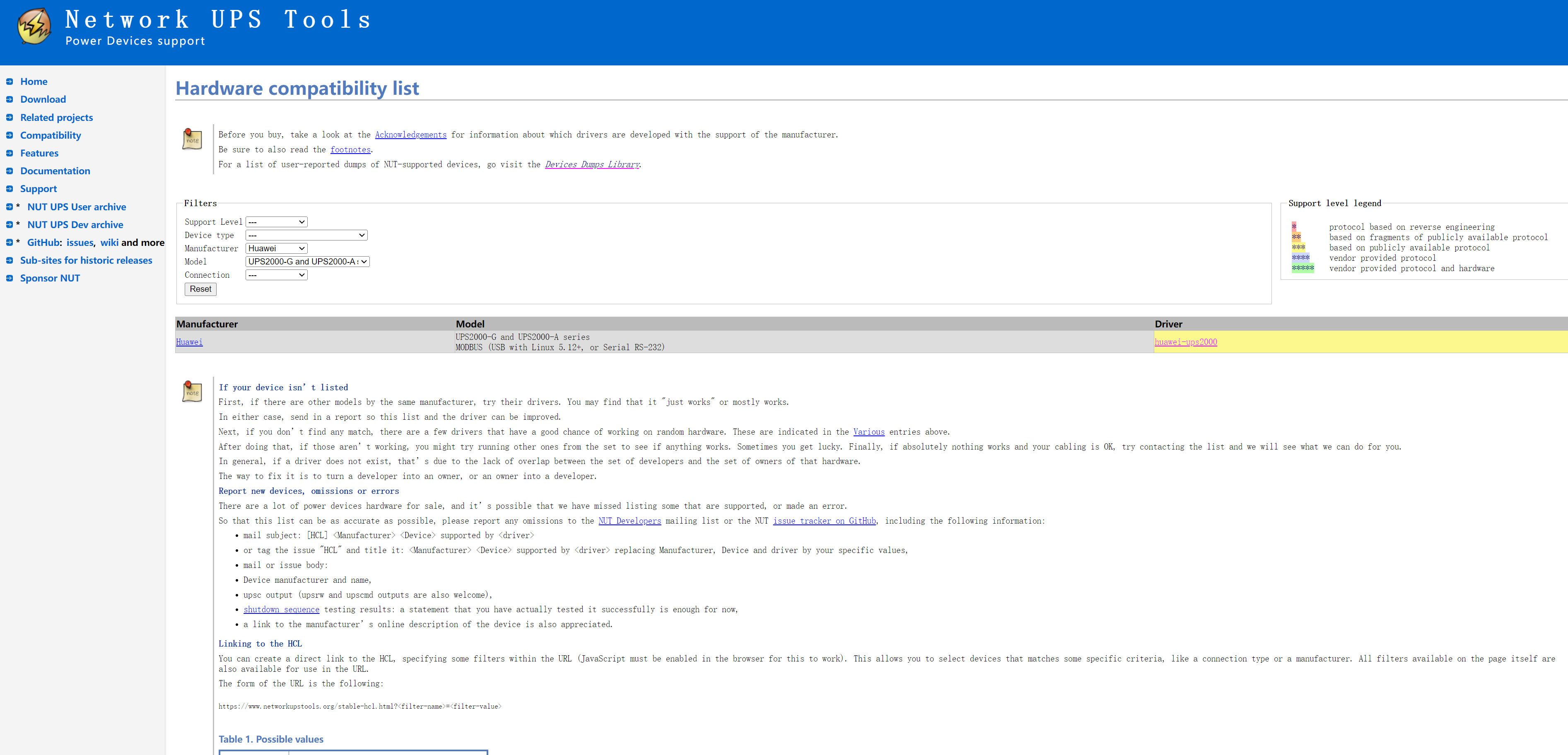

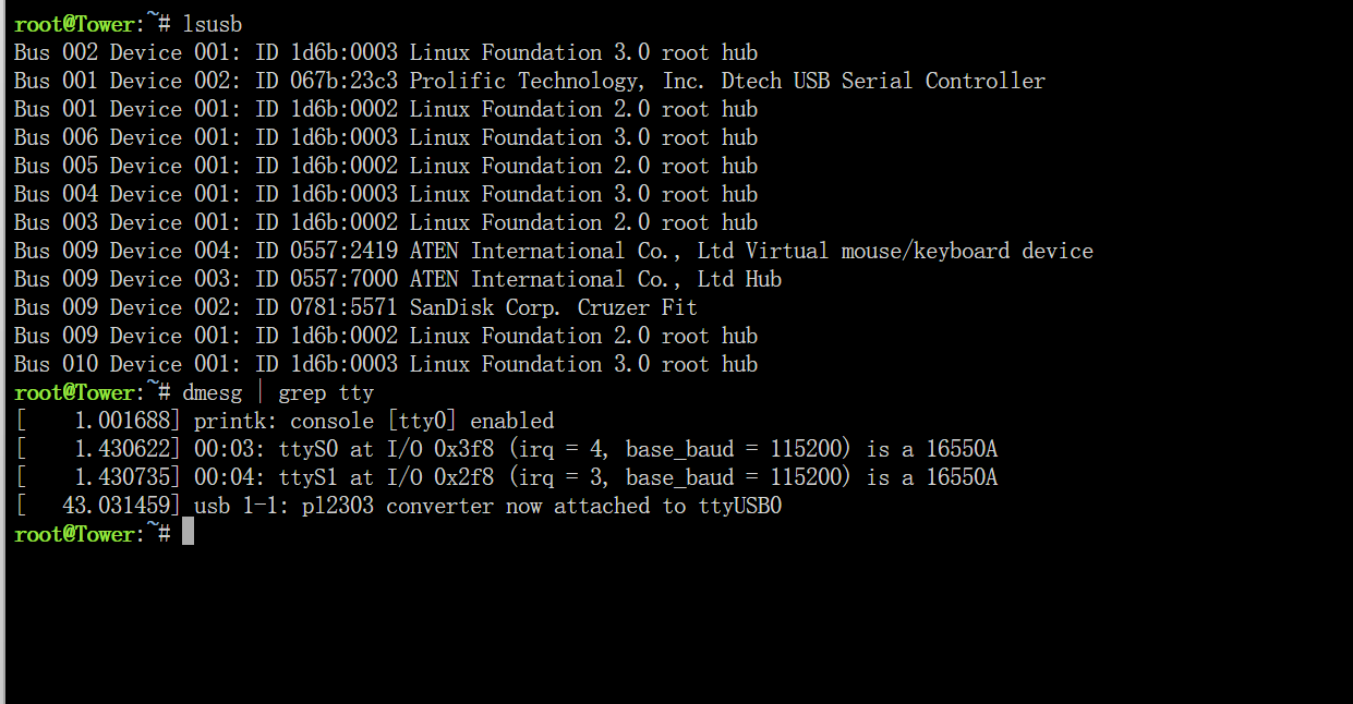

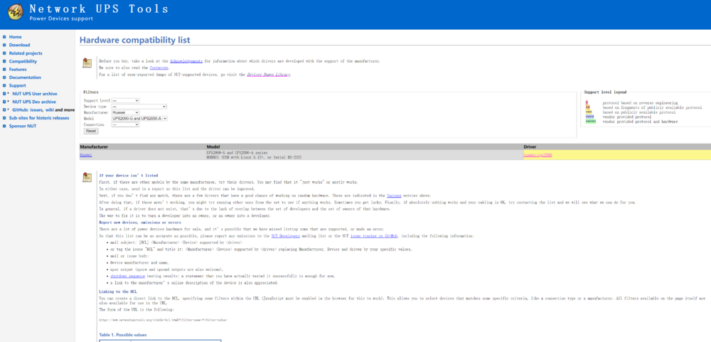

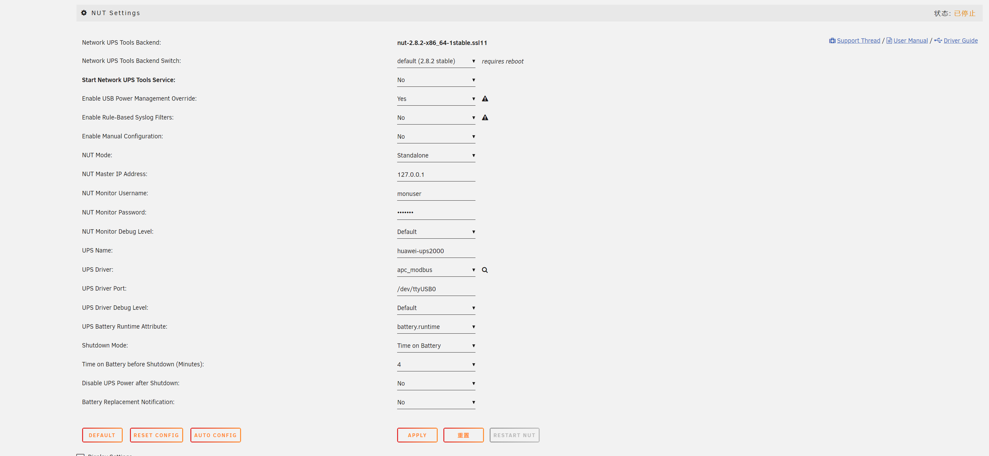

I am using the Huawei UPS2000-A-2KTTS | 2KVA / 1600W with a built-in battery tower UPS, but when I use the NUT Device Scanner, it shows the following message:
NO DEVICES FOUND Please visit the 'Driver Guide' and manually choose the recommended driver for your UPS. In case of persisting problems please try another physical port, cable or the 'Support Thread'.
However, I checked the compatibility on the NUT Hardware Compatibility List and found that my UPS is supported. I am not sure what is wrong or if my settings are incorrect. I would appreciate any help with this issue.
Your settings are not correct, please try this configuration instead and let me know:
Thank you for your help, it is now working correctly. I have another question: I am currently using a 2303 to USB adapter, but I have an additional SNMP intelligent card. However, according to the Hardware Compatibility List, it seems that the UPS2000-A series does not support the SNMP intelligent card. I am not sure if it will still work properly if I switch to the SNMP card.

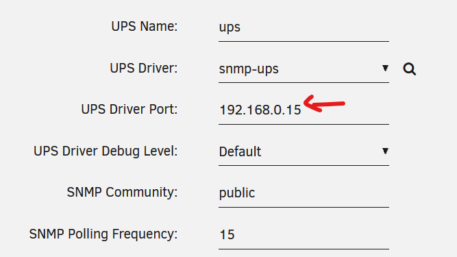

It can also work with SNMP, because for SNMP you would use another driver and not "huawei-ups2000" (that is only for a physical connection to the UPS). If you use SNMP, you would use the driver "snmp-ups" and set the UPS Port to the IP of your SNMP card (see where the red arrow is in the screenshot).
This would be an example SNMP configuration:
But beware you need to make sure that the network connection to your UPS stays available in a power outage, so any switches also need to be connected to the UPS.
Edited by Rysz

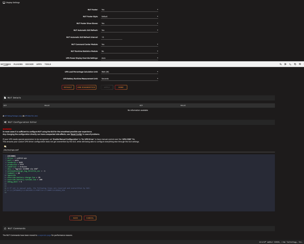

Any news for the APC Back-UP UPS?
After reboot it works for some time, then freeze
Tried with usb power override without succes
EDIT: Saw the post about APC, resetted config, will see about freezing
nut-debug-20240520202951.zip
Edited by PilaScat
