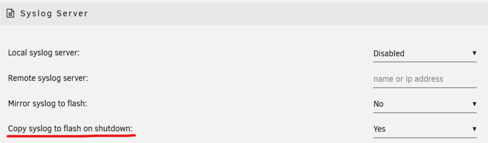

22 minutes ago, KillianMelsen said:
There is nothing in the logs regarding the previous shutdown, please make sure to enable this:
And then post the NUT Debug Package again next time you get a shutdown, directly on the first boot after the shutdown. The BX series is known to be bugged (we spoke on GitHub about this) but it shouldn't cause any shutdowns, at least it didn't for any of the other affected people so far. NUT should in general never cause unclean shutdowns (and parity checks) unless something on your server was taking extremely long to stop - resulting in a forced shutdown (but this would also happen without NUT if you press "Shutdown" and something gets stuck). So even if your UPS reported a false power event the shutdown should always have been a clean shutdown. In any case we would need the logs from before the shutdown to really diagnose the problem that led to the unclean shutdown so this is guesswork on my part at best.
Regarding the other problems now having stopped on another USB port, I'm guessing the USB port you were previously connecting your UPS to is maybe faulty or the USB cable between the PC and the UPS is in the process of dying. There's a lot of USB related events in the logs, so I'd monitor the situation and if it happens again on the new USB port I'd consider exchanging the cable (can be found on Amazon for around 10$). Sorry I can't really help more at this point, but do report back with new logs in case it happens again.
Edited by Rysz
Thanks for the swift reply! I believe copy syslog to flash on shutdown was enabled already, but it seemed that the copying didn't actually happen before the unclean shutdown. Like I mentioned, this morning I moved the USB cable between the UPS and server to another port (USB 3.2 vs 2.0 if that matters) and I haven't had a single error since then (no messages about low batteries either except for a single one right after starting NUT, in fact). Perhaps the port was the problem...
Some UPS do behave better on USB 2.0 ports, so I usually always connect mine on USB 2.0 where possible. Another affected user reported the BX problems stopped for him all of a sudden and without changing anything around. I still haven't gotten my hands on a BX series device to investigate more, at this point I'm really clueless what the UPS is actually doing when it reports these states.

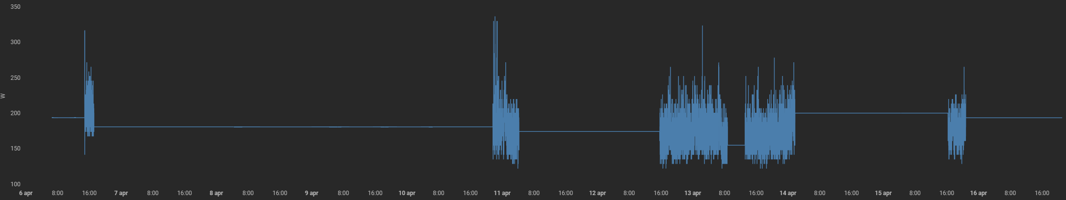

here I am again with a new problem, after the various low battery nut now freezes and remains at the same wattage for days, I have to restart it manually to fix it but after a while it continues to freeze
It's a big problem because it doesn't seem to communicate with the UPS (which is new, less than a month old) and therefore if there was a blackout it wouldn't do its job
nut-debug-20240416210804.zip
Edited by PilaScat
There's lots of USB disconnects in your logs and it seems something is hibernating your UPS periodically - causing the data staleness. I also see you have powertop installed, which is known to cause such issues. Would be best to remove anything powertop related, reboot the system and watch if the problems come back.
