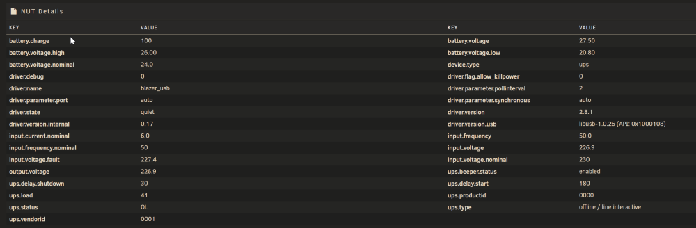

Then I spotted the notice regarding powertop. I had powertop installed for months and never had issues.
But in this case, after removing powertop, the errors are gone, and I can see the ups details again.

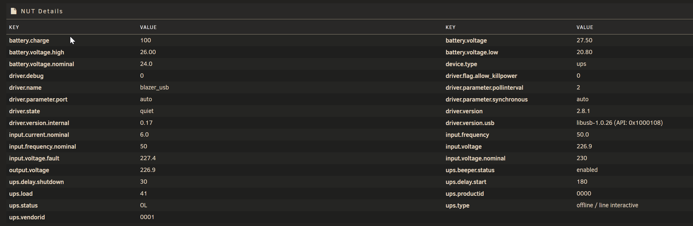

One notice, If I choose nutdrv_qx as driver, "Battery Charge" is not displayed.
If I choose the blazer_usb, Battery Charge is shown.
Is there any chance to get the "Runtime Left" Infos from the greencell USV?

Better to stick with "blazer_usb" then, the battery charge is important. Glad it works now, powertop can be unpredictable and I'm not a fan of it overall personally.
Regarding the runtime it's possible your UPS does not send this information for NUT to read. Unfortunately you cannot do anything about that, but you can still use the "Shutdown Mode": "Battery Level" and "Time on Battery", which are the more reliable shutdown modes anyhow. "Runtime Left" is the least reliable shutdown mode and that's the only one that won't work for you because of the missing runtime variable. So basically NUT already has all the information it needs to work reliably and that's good even if some of the variables are missing here. You will see some more information (not the runtime, but at least the power consumed) if you set this setting as follows with your values (1500/900 in your case):

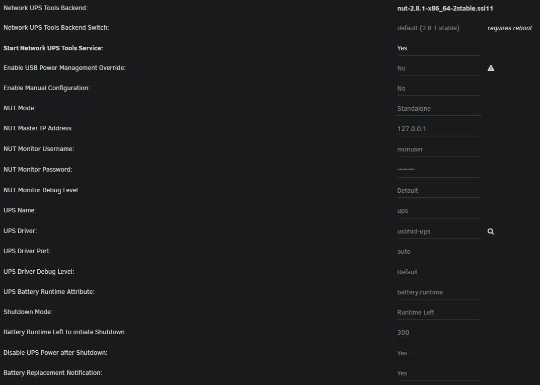

Can you post a screenshot of your NUT Settings page? What exactly isn't working for you? Did you try clearing the browser cache or from another browser? Please also post the NUT Debug Package found on the NUT Settings page.
Edited by Rysz

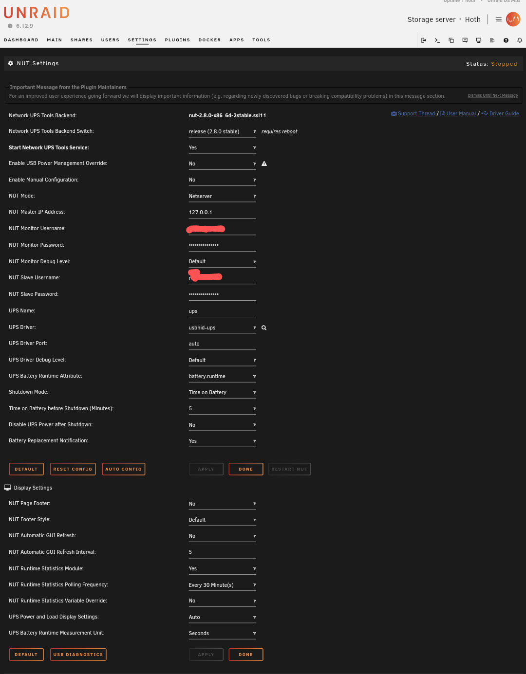

When I attempt to start nut services it gives the error not able to start succesfully.
nut-debug-20240330123023.zip
Edited by dragoontwo
Added settings

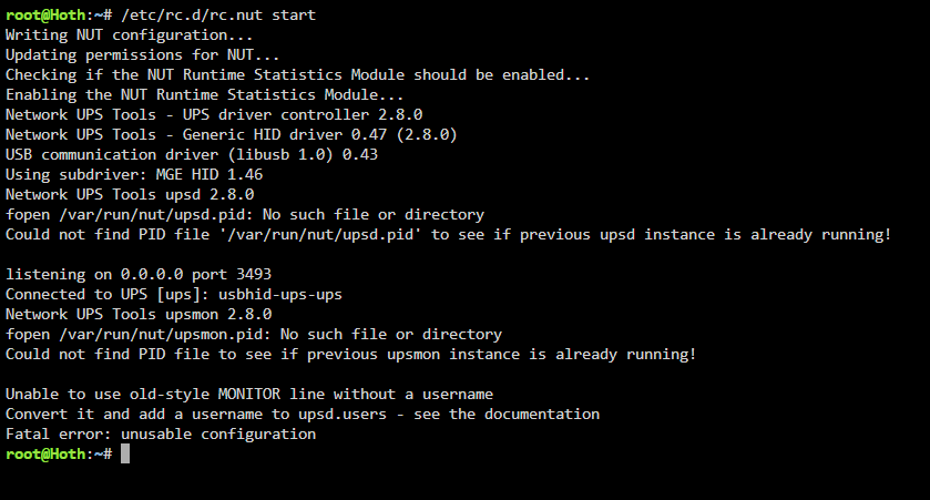

I cannot find a problem with your configuration, can you run the command and show me the output:
/etc/rc.d/rc.nut start
If you don't know how to run commands, can you try "Reset Config" and set up NUT with a fresh configuration? Please let me know if it works for you then.
Also I noticed you have very long passwords, can you try setting both passwords to something easy like 123 just for sake of confirming it's not a problem with the passwords? Also make sure the usernames and passwords do not contain any spaces.
Edited by Rysz

It does appear to be an issue with the password length.  Here's the command you asked for earlier anyways.
Thanks, it's a problem with either the username or password (or both). This is very important information for me because I'll have to fix this, thank you for your help. Can you confirm it works for you now with an easier combination of usernames and passwords?
It is now working, and I'll go back to the current 2.8.1 release when I can reboot.
Thanks a lot again and sorry for the inconvenience, this helped me identify two important issues for fixing in the next update. You can also just remove and reinstall NUT after changing the backend setting and you'll be on the new version again without rebooting. 🙂

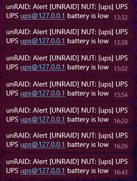

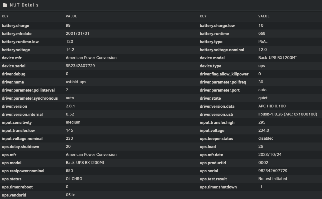

On 3/16/2024 at 4:55 PM, PilaScat said:
Hi, today my new UPS (APC BX1200MI-GR) arrived, set it up and charging, but in the notification I'm getting this:
Is not true, it's going to 100%
Other screens:
While making the screens I saw live the percentage going to 0% then back to 99%, triggering the notification
I'm connected to NUT with Home Assistant for automation, but I'm on standalone, it works but is it correct?
Yes I have powertop but I checked and it isn't touching the UPS USB, and it worked the same with the old UPS, same UPS but 950VA
Just to follow up on this for you and other users with the affected APC BX series.
Users who are getting intermittent LOWBATT (low battery) notifications can silence these wrongful LOWBATT notifications by resetting their configuration using "Reset Config" and setting up NUT with a fresh configuration. In the new configuration layout such LOWBATT events will no longer raise notifications through Unraid's notification service and only appear in the SYSLOG.
For intermittent REPLBATT (battery replacement) notifications, those can be controlled through the GUI and will have to be disabled for your UPS in case they still occur wrongfully - which unforatunately seems to frequently happen on the affected APC BX series.
The issue itself is still under investigation, we're suspecting that the UPS is cycling through those states while doing some sort of battery calibration process - follow the process over at: https://github.com/networkupstools/nut/issues/2347

Please post the diagnostics package, those messages are normal and just means it's skipping over packages for other Unraid versions. Can you not see NUT Settings anymore after updating or what is not working?
My apologies.  False alarm.  I should know better than to do upgrades after 11 PM.
It was the change from nut version 2.8.1 to 2.8.2 along with a configuration error on my part.  I had a bad listener entry in upsd.conf.  This didn't cause any issues for 2.8.1, but 2.8.2 now forces upsd to exit with an error if any listeners fail.  Removing the bad listener entry allowed upsd to start.  They added the ALLOW_NOT_ALL_LISTENERS setting in upsd.conf to control this behavior.  See this issue: https://github.com/networkupstools/nut/issues/723
Thank you for the quick reply and for all the work you have been doing on this plugin.
