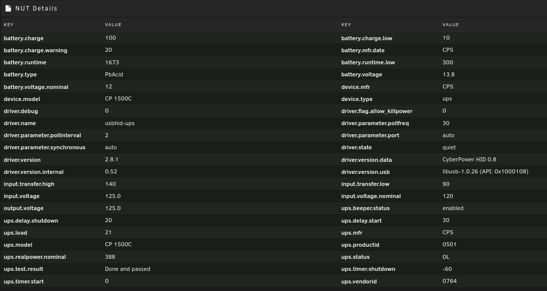

First off, thank you for this awesome plugin! I initially attempted to set up set up my NUT server on pfsense, but I struggled with a bunch of connection issues right from the start so this was my next best alternative.
For some background I have a pretty old UPS that I purchased in 2014, specifically the CyberPower CP1500AVRLCD. It doesn't look anything like the current model that is shown on their website - its has a blue display and rubberized power button that lights up blue, if anyone is familiar.
In terms of autodetection with the NUT plugin, everything seems to be fine in terms of detecting the correct model (https://networkupstools.org/ddl/Cyber_Power_Systems/CP1500AVRLCD.html) However, I think some of the parameters that have been predefined are causing the power draw to be reported incorrectly. Specifically, it only reports about 50% of what is shown on the UPS display and the apcupsd plugin (I'm not using this plugin simultaneously btw). My assumption is that since battery.voltage.nominal is set to 12 and I have two 12 volt batteries wired in series in this UPS, it is incorrectly reporting the power draw. The confusing part is that battery.voltage reports around 13.8-13.9, so that somewhat invalidates my theory. Any thoughts on how I might go about addressing this issue? Can I just make some ups.conf adjustments myself, or are these fields not user definable? I'm attaching my current configuration for reference, I'd appreciate any help you can provide!
EDIT: I just noticed ups.realpower.nominal is reported as 388 - I assume this should state 900 for my UPS

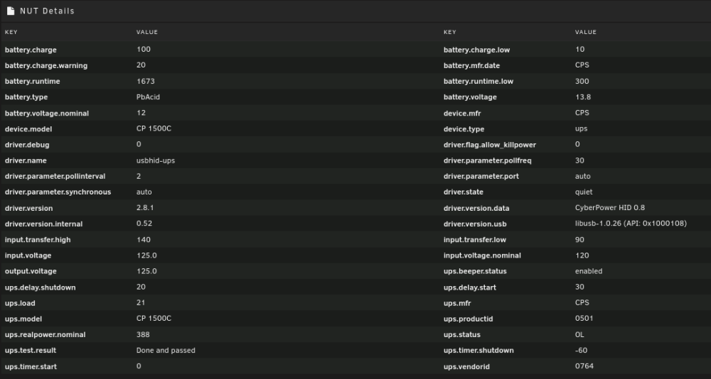

172079762_Screenshotfrom2024-02-0117-06-36.thumb.png.59bea2d9d4ddecd4de8e0196e2ae91e3.png391911804_Screenshotfrom2024-02-0117-07-18.thumb.png.c6f2b6744a2d8b20503b03f8b25e06ea.png
Since your UPS doesn't provide the actual power draw it's calculated from the load and nominal power (wrongly 388W). There's a setting in the GUI: "UPS Power and Load Display Settings" where you can override the wrongly reported nominal power values ("Manual"). You should put your actual values 1500VA/900W there and it'll then show the correct power draw in the GUI.
Please let me know if that worked for you!

13 minutes ago, Rysz said:
Since your UPS doesn't provide the actual power draw it's calculated from the load and nominal power (wrongly 388W). There's a setting in the GUI: "UPS Power and Load Display Settings" where you can override the reported nominal power settings ("Manual"), you should put your actual values there and it'll then show the correct power draw in the GUI.
So simple, that works perfectly. Thank you!

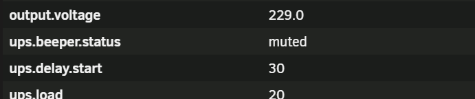

Found i have ups.beeper.status=muted , and cant enable by pressing on button also by command :
upscmd -u admin -p adminpass Eaton9E2000i beeper.enable
using NUT for 9E 2000i
Edited by Masterwishx
Can you try beeper.on instead of beeper.enable?
Yes i tryed also not working
only beeper.disable working , when beeper.enable after its goes to mute
i mean its stacked in mute, i tryed power off the wall switch , then UPS goes to battery and beeper is working every 4sec but status is still mute ...
Then it's probably just reported wrongly by the driver, if the beeper is otherwise working that's the most important thing.
OK, strange i think it was OK befor . also i see OK after every sended commands ...

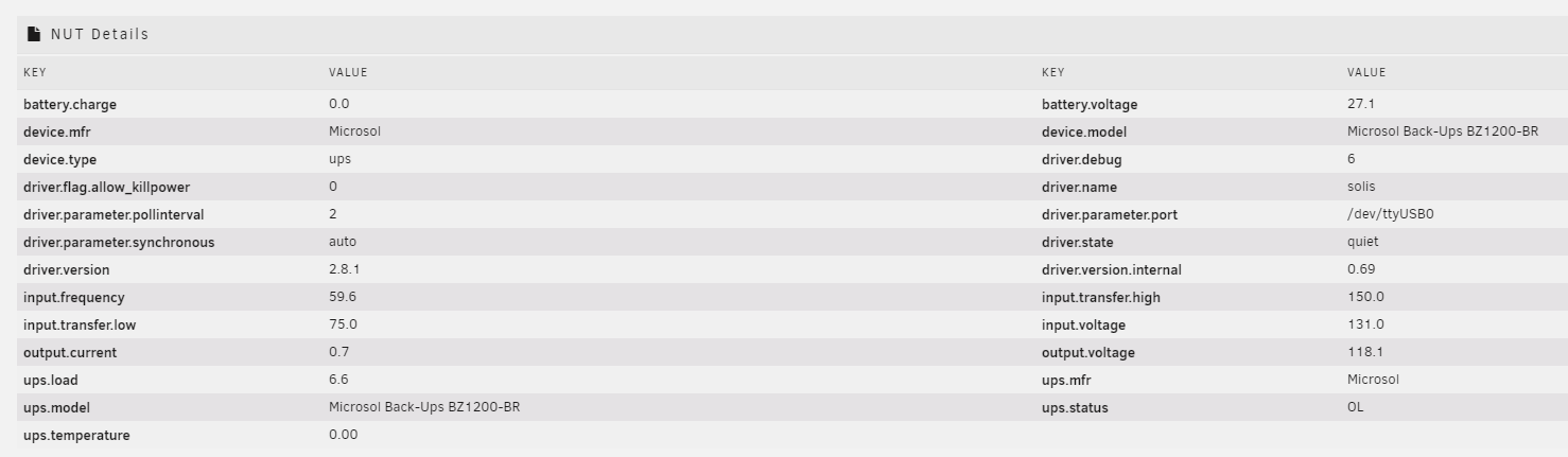

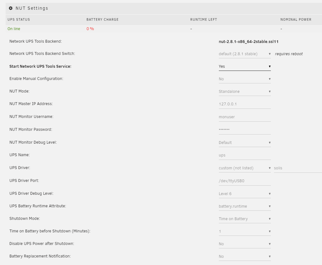

Hello Guys,
I was able to make my APC Back-Ups BZ1200-BR be detected by NUT Plugin using the "solis" driver, but for some reason the status and data from the UPS is not updated in real time. I only get the new data/status when I click "Restart Nut" buttom. I know this driver is not perfect but I only need to turn off my server when status is changed to battery. Anybody else already experienced it or can give me some tips where to look at?
Thanks in advance! 😃
17 hours ago, njpj said:
Hello Guys,
Can you try changing the NUT backend to "release (2.8.0 stable)" and see if that works?
In NUT Settings using the "Network UPS Tools Backend Switch" (need to reboot after switching).
If that doesn't work you can also try the oldest backend "legacy (2.7.4. stable)".
Please let me know if any of those suggestions worked for you!
Hello Rysz,
First of all, really thank You for your repply.
I tried all backends available, unfortunately with no luck.
What I noticed is that the data gets refreshed, but only 1-2 times / hour. I was not able to catch exactly the period it's refreshing.
Do you know if maybe there's some place where I can change this refresh frequency?
Thank You 😉

On 2/18/2024 at 8:10 PM, njpj said:
Hello Rysz,
Thank You 😉
I can't really help more there, unfortunately, it's most probably a driver issue.
The default refresh is 5 seconds for the status, so I'm guessing the connection is going stale.
You could open an issue on NUT GitHub about it: https://github.com/networkupstools/nut/issues
