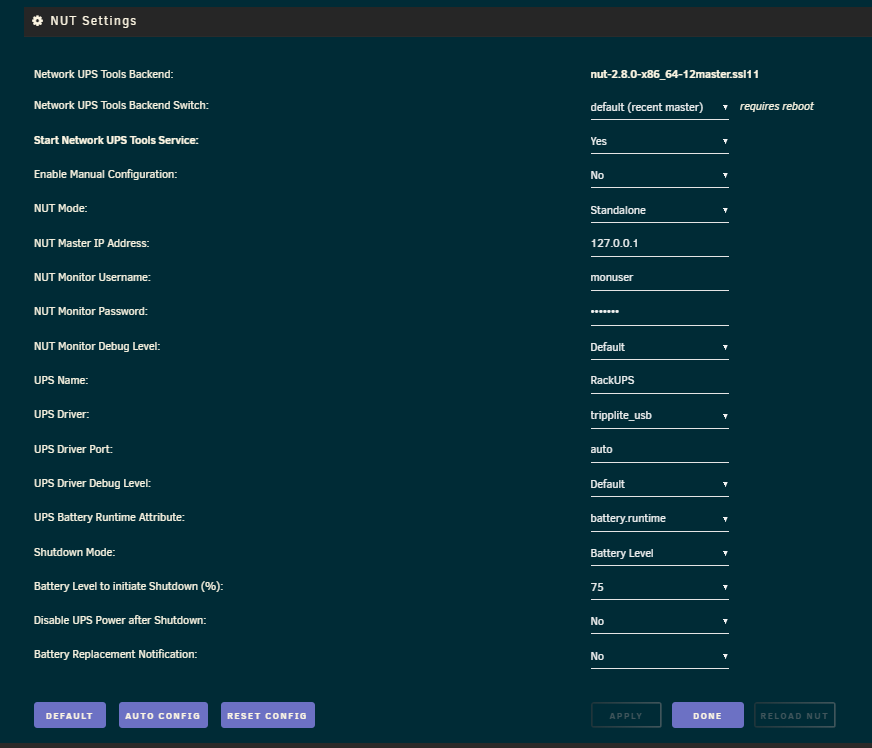

1 minute ago, Rysz said:
Which UPS model do you have exactly?
TrippLite SMART1500RM2UL
Should work with driver "tripplite_usb" and port "auto" - can you test this combination with this version of the plugin?
You need to set Start Network UPS Tools setting to "No", change the settings and then back to "Yes" to start NUT again.
As requested, i stopped the service, set it to "Tripplite_usb" and port "auto", started the service.
NUT Details - No information available
Hmm, does it say anything in the logs with the tripplite_usb driver?
What else you can try:
  • Auto Config with different USB port
  • Same settings on backend "release (2.8.0 stable)"
  • Same settings on backend "legacy (2.7.4 stable)"
  • Auto Config on backend "release (2.8.0 stable)"
  • Auto Config on backend "legacy (2.7.4 stable)"
If you don't want to reboot changing backends, you can also just uninstall and reinstall the plugin (after changing the backend). Just make sure that "Network UPS Tools Backend:" says something different than before, that it's actually changed (you at least need to reinstall the plugin, otherwise it won't change the backend).
Edited by Rysz

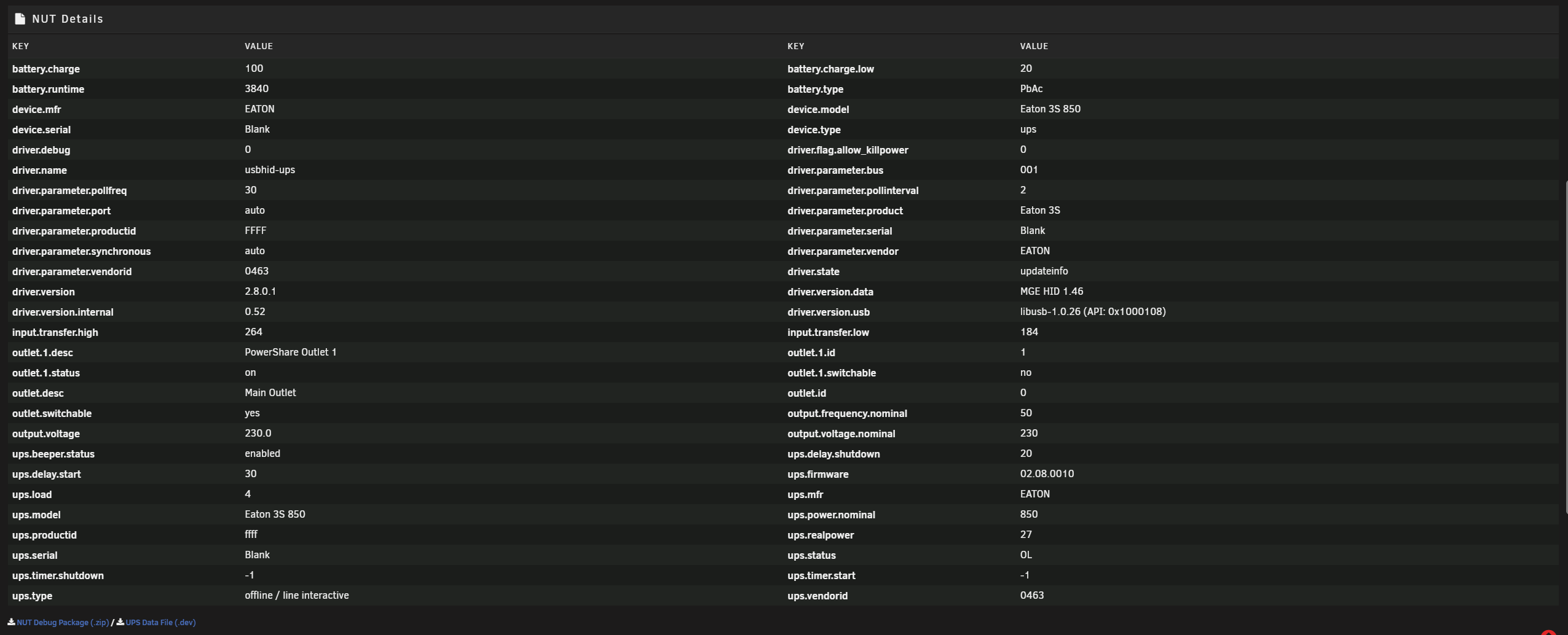

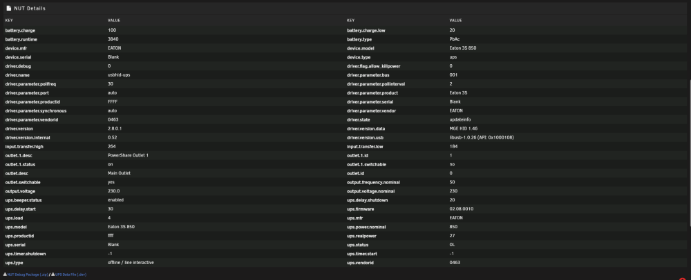

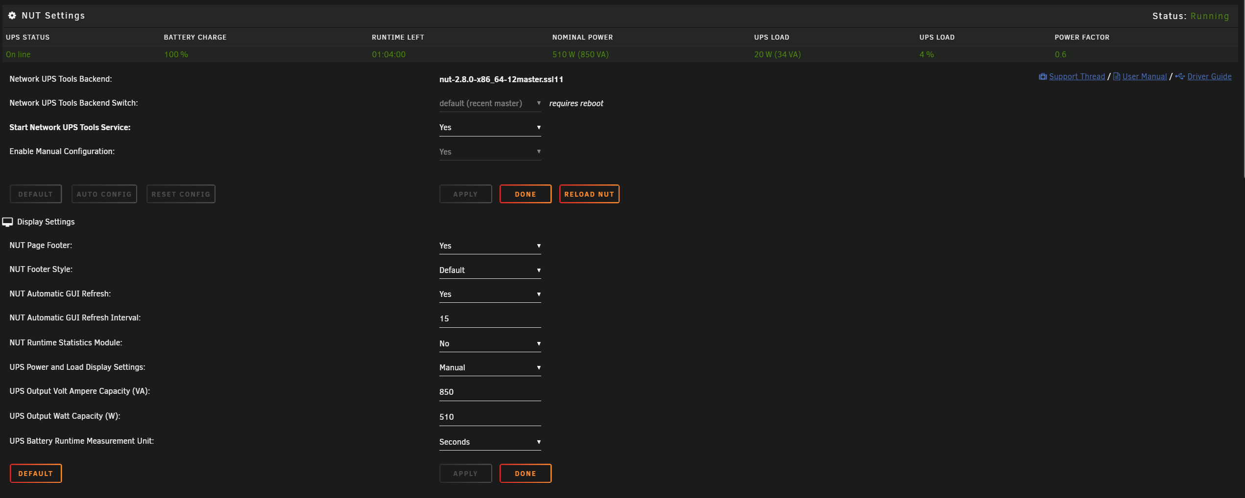

Is something wrong in my configuration or why is the load of my Eaton 3S 850 DIN UPS always 4%? No matter if something load intensive is running on my Unraid server or not. Unfortunately, the UPS is not really smart and I have to manually specify VA with 850 and W with 510, but he would calculate everything so.
At least that was the thought. But brings nothing, as long as the load is always at 4%.
Can you post a screenshot of the variable table (NUT Details) please, hard to tell what's wrong.
Of course.
Here the ups.conf
[ups]
driver = "usbhid-ups"
port = "auto"
vendorid = "0463"
productid = "FFFF"
product = "Eaton 3S"
serial = "Blank"
vendor = "EATON"
bus = "001"
Edited by sasbro97
Forgot something
35 minutes ago, sasbro97 said:
Of course.
Table looks OK, general compatibility seems good with all the really important variables reported.
NUT itself uses the variables reported from the UPS, but the plugin can calculate some for the GUI.
However that only works for variables which are zero or entirely missing, so not much we can do there.
On the upside this is only an optical problem, load variables are not required for NUT itself to function.
So you'll still have the safe shutdown and all other functions of NUT working without the load variable.
