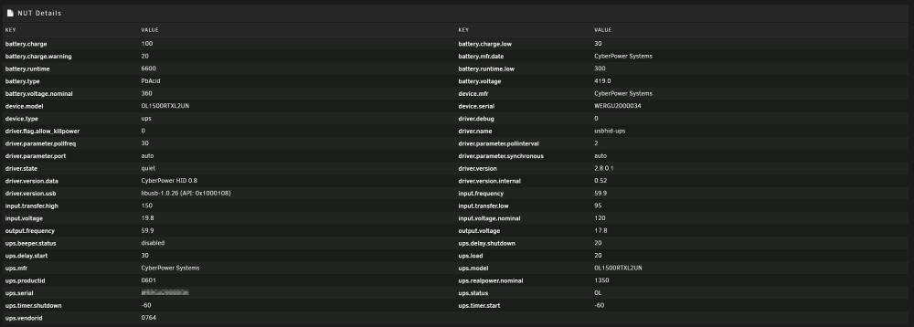

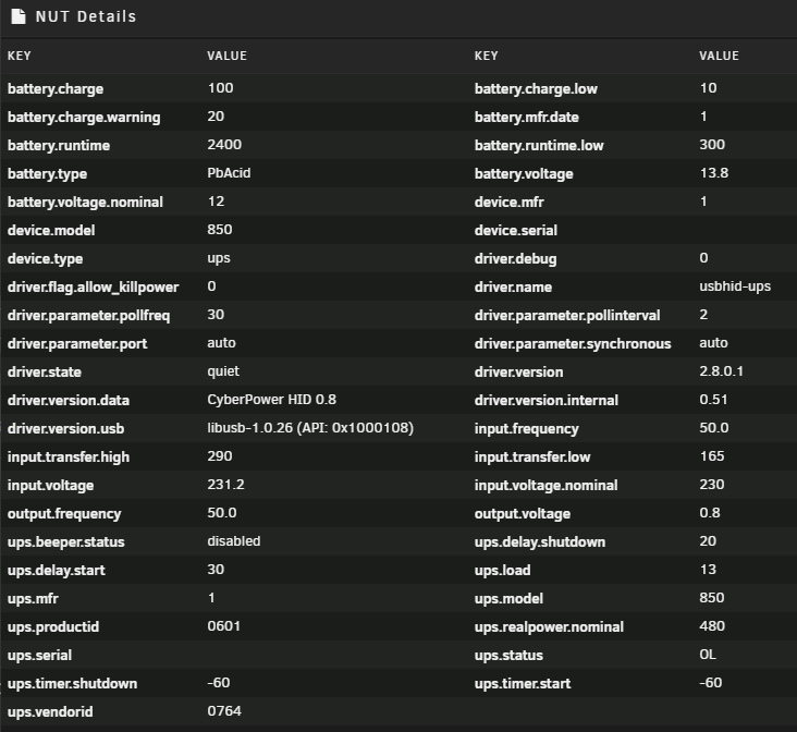

Switched to the new one and somehow output voltage display is broken, just gives seemingly random values, sometimes 2 and some, sometimes 0.8, sometimes 24 something... never had a problem before.
Hello,
this is not something that the plugin has any control over, unfortunately, it's either what your UPS reports or the NUT driver in the backend chooses to "see" from the values your UPS sends.
It's possible your UPS isn't playing well with the newer NUT backend, so I suggest switching to the "legacy" backend in NUT settings - then it'll use the exact same backend (2.7.4) as Simon's version did.
If the problem persists even after the backend switch then it's likely your UPS that's suddenly reporting wrong values for some reason because the backend would be the same and the plugin has no control over the values sent from the NUT driver.
Edited by Rysz
1 hour ago, Kilrah said:
Yep, backend switch fixed it, thanks.
Might be this...
https://github.com/networkupstools/nut/issues/1973
Yeah that looks like the problem you're experiencing, hopefully Jim will fix it at some point. 🙂
Glad that the legacy backend works for you, in this case probably best to stick with that for now.

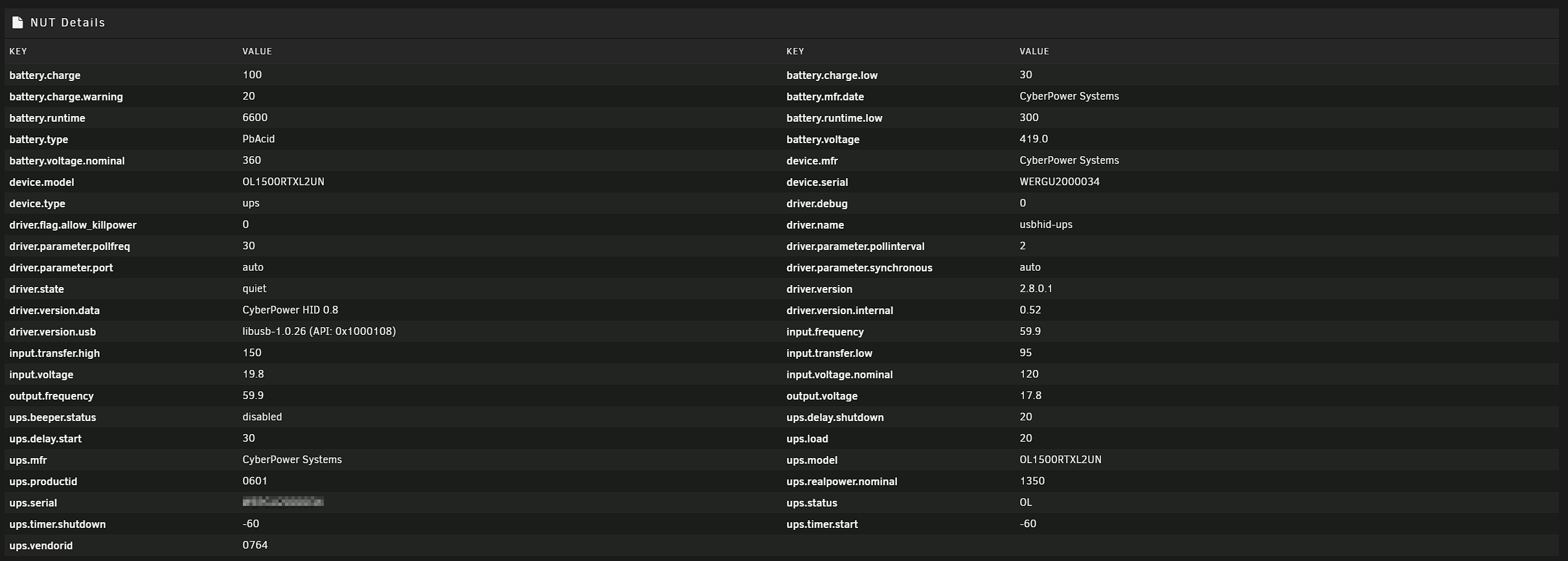

I was on the old plugin and now I'm using desertwitch 2023.09.17b version, this problem never disappear. I have tried to set `pollinterval` to 15 according to some google search, but nothing changed. This is the detail about my UPS if it may help
root@TARS-NR:~# upsc CP1500@localhost
battery.charge: 100
battery.charge.low: 10
battery.charge.warning: 20
battery.mfr.date: CPS
battery.runtime: 7575
battery.runtime.low: 300
battery.type: PbAcid
battery.voltage: 26.1
battery.voltage.nominal: 24
device.mfr: CPS
device.model: CP1500AVRLCD3
device.serial: BHPMV7001812
device.type: ups
driver.debug: 0
driver.flag.allow_killpower: 0
driver.name: usbhid-ups
driver.parameter.pollfreq: 30
driver.parameter.pollinterval: 15
driver.parameter.port: auto
driver.parameter.synchronous: auto
driver.state: quiet
driver.version: 2.8.0.1
driver.version.data: CyberPower HID 0.8
driver.version.internal: 0.51
driver.version.usb: libusb-1.0.26 (API: 0x1000108)
input.voltage: 121.0
input.voltage.nominal: 120
output.voltage: 121.0
ups.beeper.status: enabled
ups.delay.shutdown: 20
ups.delay.start: 30
ups.load: 8
ups.mfr: CPS
ups.model: CP1500AVRLCD3
ups.productid: 0601
ups.realpower.nominal: 900
ups.serial: BHPMV7001812
ups.status: OL
ups.test.result: No test initiated
ups.timer.shutdown: -60
ups.timer.start: -60
ups.vendorid: 0764
I appreciate any help.

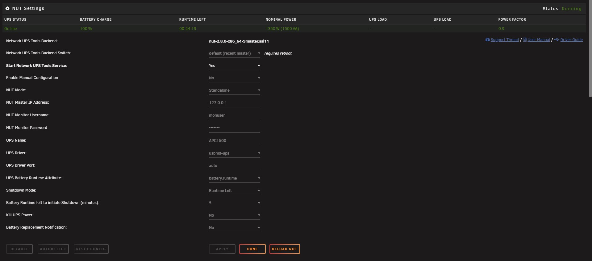

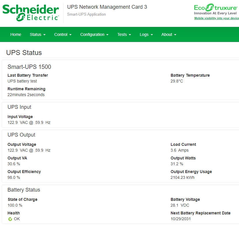

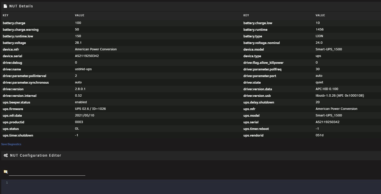

Curious to see if anyone could help me get this plugin to work with my APC UPS Smart-UPS, SMTL1500RM3UC, so that it shows UPS Load in watts and %.
I'm currently using the included USB cable for the connection to my unRAID server.
I have the APC NMC (Network Mgmt Card) installed in the UPS, but haven't been able to figure out how to get that to work with NUT or even the unRAID UPS settings. I can log in to that card from another pc, but it would be nice to see it in NUT.
I have tried all of my USB ports on my motherboard, i.e. USB2, USB3, with no difference.
The only readings NUT or unRAID UPS will give me are:
UPS Status = On line
Battery Charge = 100%
Runtime Left = 24:19
Power Factor = 0.9
I've attached all relevant info I could think of, but if you need something else just ask.
Thanks for looking.
nut-diagnostics.dev threadripper19-diagnostics-20230923-1701.zip

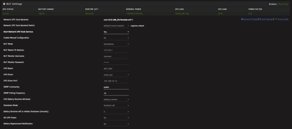

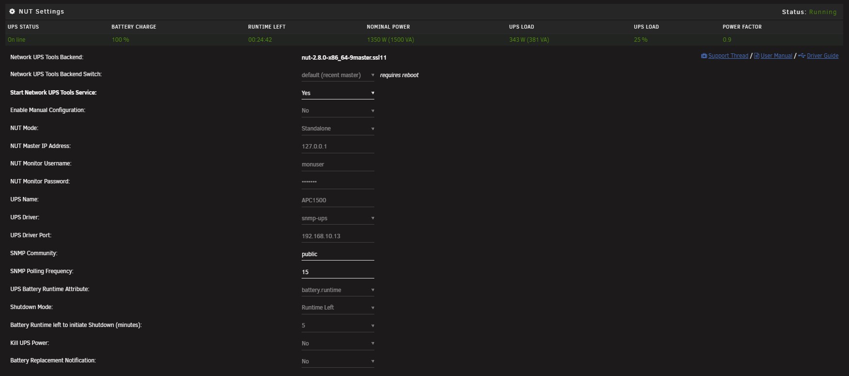

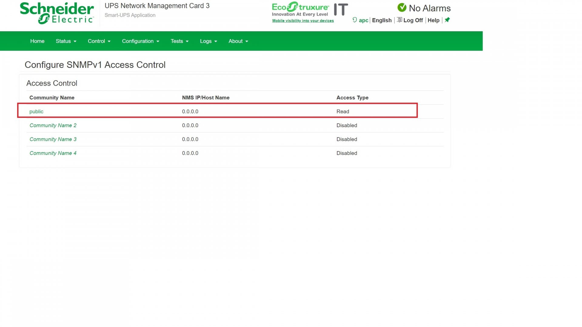

Hello,
this seems to be a USB driver compatibility problem with your UPS series, see here:
https://github.com/networkupstools/nut/issues/359
I'd suggest you have NUT connect to your UPS over SNMP (network connection) instead rather than USB (cable connection). SNMP would make NUT connect to the UPS' network card and that makes it easier for NUT to read these missing values from your UPS.
In the NUT settings for SNMP you'll set:
UPS Driver: snmp-ups
UPS Driver Port: (ip address of your UPS here)
SNMP Community: public

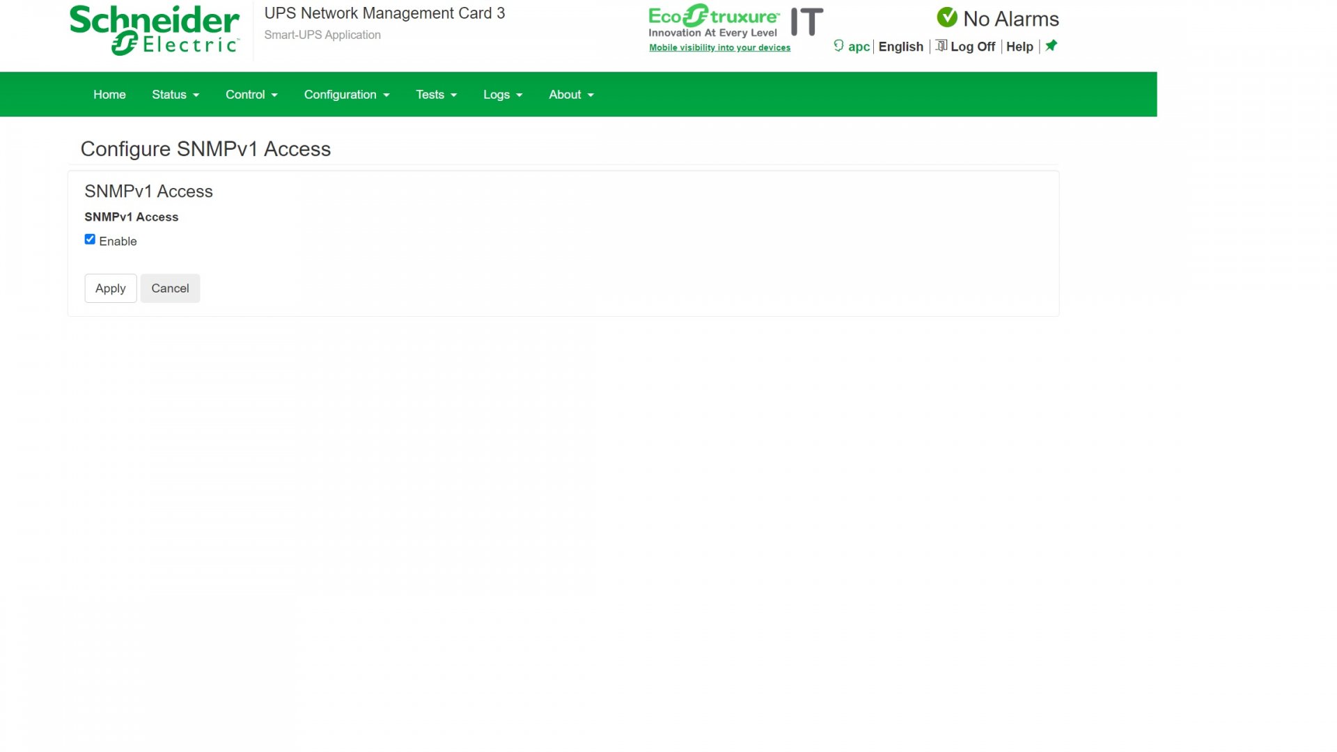

If that doesn't work straight away your UPS needs to have SNMP activated/configured first:
More information here:
https://cdn.cnetcontent.com/b3/87/b387b23c-0e2c-49de-bbb1-74613618fb7f.pdf (page 53/54)
https://support.auvik.com/hc/en-us/articles/205162620-How-to-enable-SNMP-on-APC-UPS-devices
If you absolutely need to stay on USB and don't want to or can't connect over network (SNMP), then a last resort attempt would be switching the backend to "legacy" in NUT Settings (requires reboot).
Please let me know what worked or didn't work for you!
Edited by Rysz
Spoiler
@Rysz

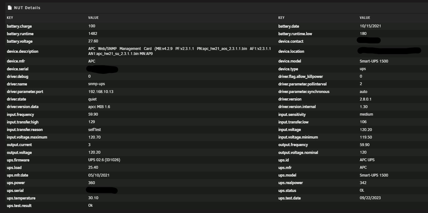

You absolutely nailed it!
The easiest fix I've had to do with my unRAID since I started the server.
Just needed to adjust the NUT setting and APC SNMP access control setting and it worked instantly!
Thank you so much for the help!
Anyway to donate to you for the help?

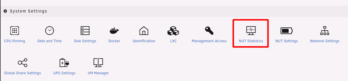

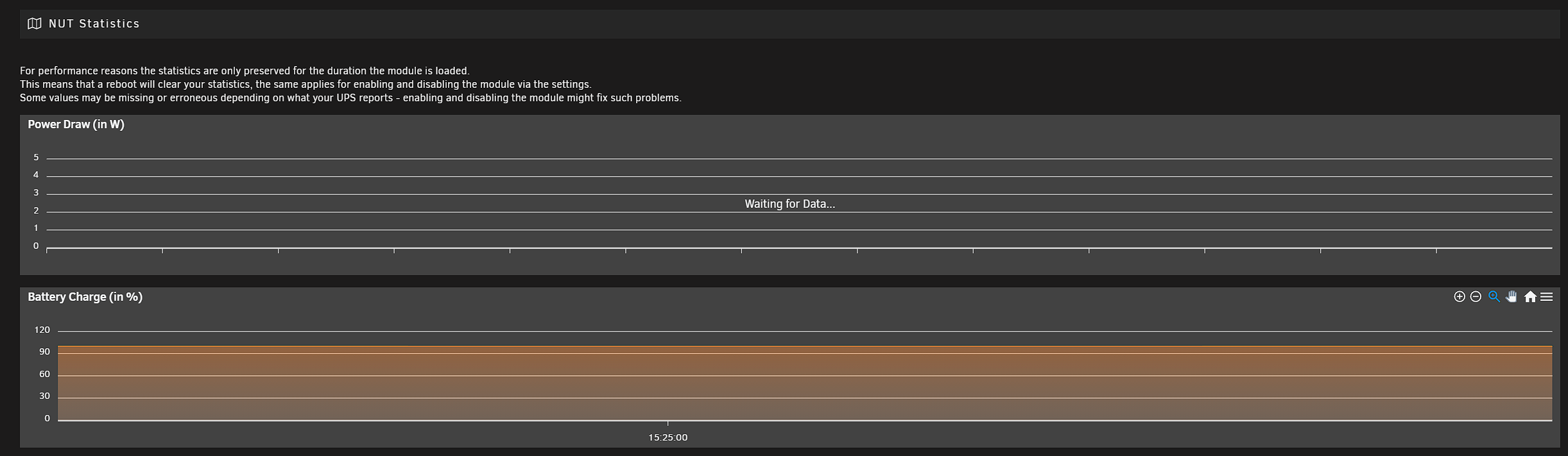

@Rysz I don't know if you've seen it already but I've issued a PR to hide the NUT Statistics from the Unraid Settings page if it is disabled in the NUT settings.
Hadn't seen it yet, that's really cool - I didn't know you could do that. Will test and merge when I get home - thanks a lot. 🙂
Sure thing:
Disabled:
Enabled:
Thanks - pull request merged and code included in today's update. ☺️

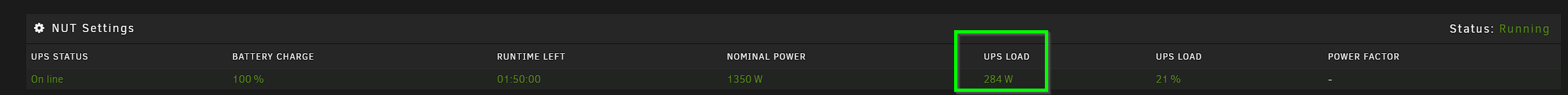

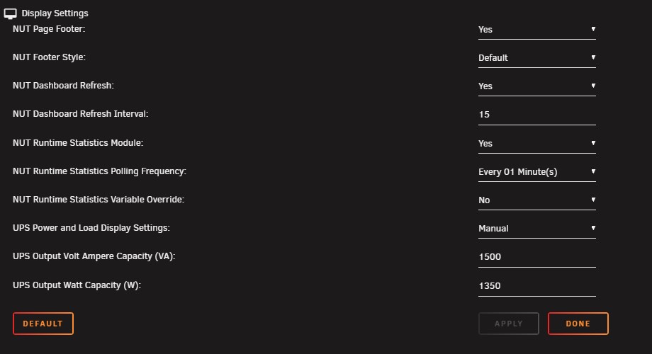

Do you happen to know the name of the variable that is populating this load value?
I configured the statistics page, and all seems to work out the box except for the Power Draw in Watts:
However, I assume those two values are one in the same?
It seems like be default you are using "ups.realpower", however I don't see that as a value in my config screen (not to say it isn't one under the covers though):
Thanks in advance for any guidance.
