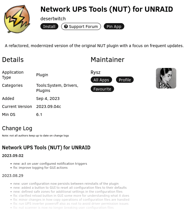

Hi i already have the NUT plugin installed but just noticed there is a new version available from Rysz repository (Network UPS Tools (NUT) - CI). What does this CI version do differently and what does CI stand for? TIA
It's an alternative version with a different (newer) NUT backend and a few minor bugfixes, you can choose which one to use, but don't install two at the same time - I'll clarify this better in the application description.

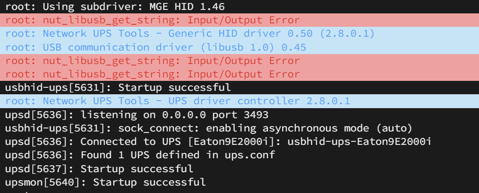

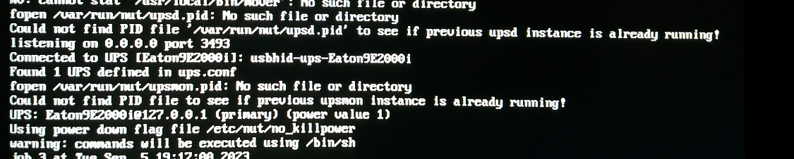

@Rysz installed new version of new plugin 2.8.0.1 , all working fine but have some errors on boot and not correct VA :

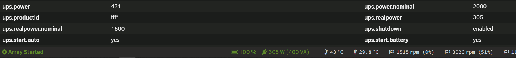

VA in footer is not same as in ups.power :
