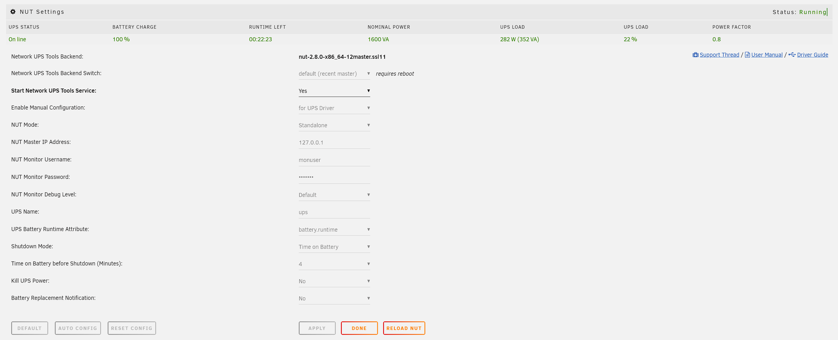

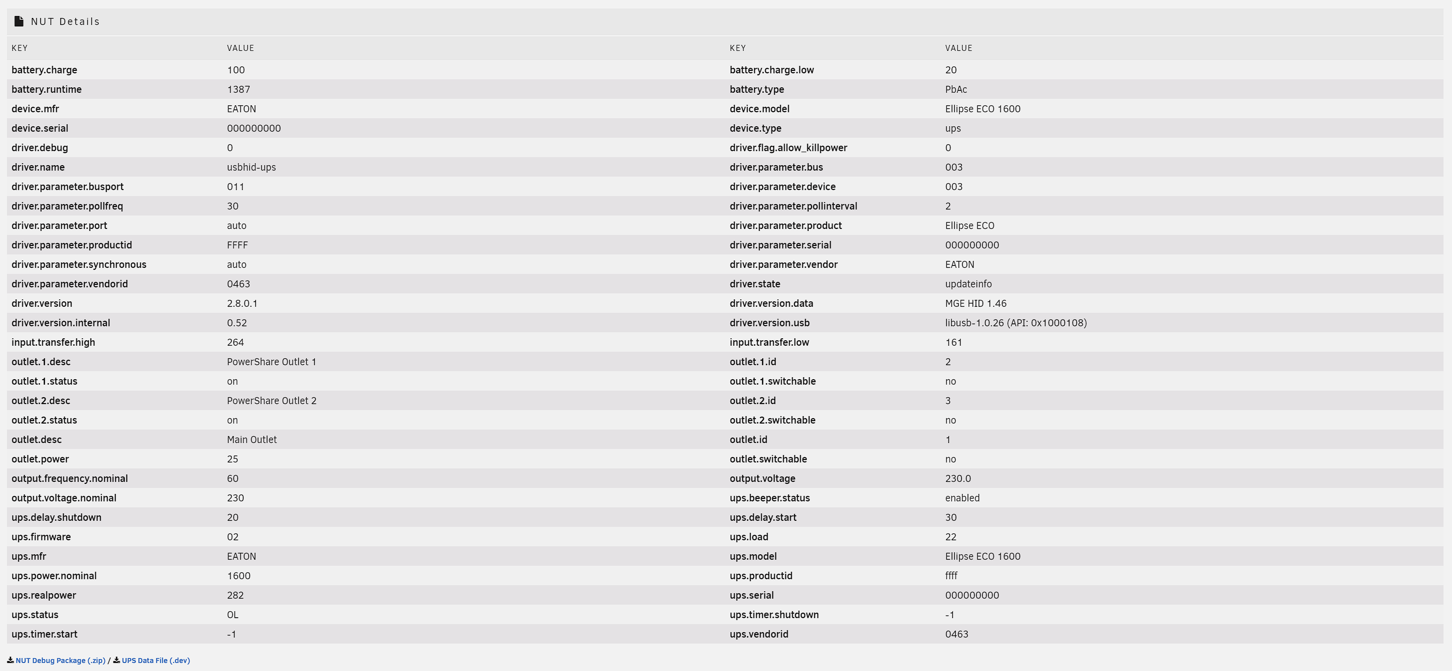

You are right. I just didn't read it right. However, load isn't shown with 2.8.0 or 2.7.4. I will try again with a different USB-Cable. Do I still have to set anything in Unraid's own UPS Settings?
No - the UNRAID's own UPS settings (the APC daemon) should be set to "No" / "Disabled" 🙂

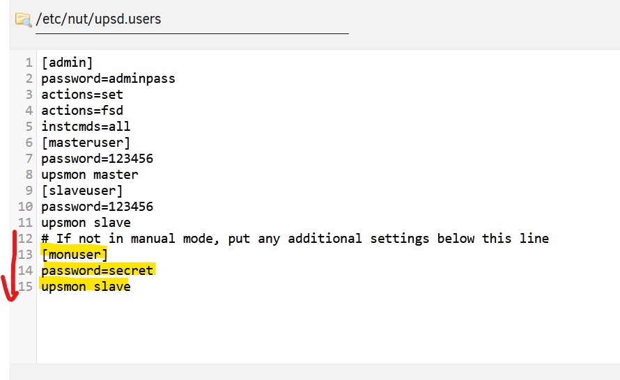

Synology will also work as ups name:ups username:monuser pass:secret   , but the tricky thing is this , a nut server can't use two identifaction at same time , thus I'm trying to use SNMP ups mode if NUT can provide.
You can add a second user with different credentials like this:
  • Set NUT Monitor Username to something else than "monuser", like "masteruser"
  • Set NUT Slave Username and NUT Slave Password to the username/password your QNAP expects
  • Apply Settings (to save configuration)
  • In NUT Configuration Editor, modify the /etc/nut/upsd.users like this:
  • Save the modified configuration file
  • Start NUT
Then on your Synology device you can use the monuser user, and on your QNAP the other user (here slaveuser). Make sure to put the additional user below the line 12 and leave the rest of the settings (as they are configured and overwritten by the GUI settings).
I can't guarantee this'll work (don't have QNAP/Synology devices).
But in theory it should work like this, unfortunately there's no SNMP server in NUT. 🙂
We have since found the issue with this, the problem was that the server was not connected to the "master" power outlet and that this Eaton UPS doesn't report load for the "slave" power outlets.
Edited by Rysz

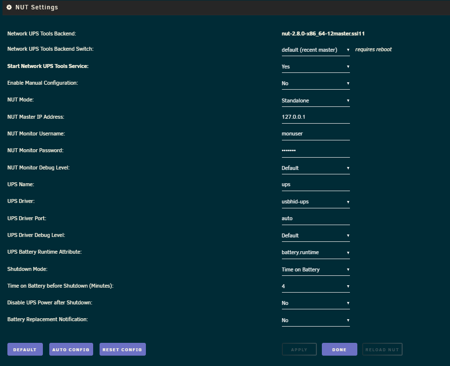

Do you know how to reset the settings to their initial state?
Even after uninstalling and reinstalling the plugin, the same settings are retained.
IMHO, I think it would be helpful if it's mentioned in the plugin introduction on the first page.
There's a button "Reset Config" - that'll reset everything to the default state. 🙂
Thank you for the quick feedback. I'm recording the process I went through, thinking that there may be others like me who are beginners. The UPS I'm using is the EATON Ellipse ECO 1600 USB DIN.
1. When I updated Unraid from 6.11 to 6.12, I encountered an issue in the "Update assistant" indicating that a plugin was not compatible.
2. Upon seeing the message, I deleted the plugin and proceeded with the Unraid update.
3. After the update, I found that the plugin was available for reinstallation, and when I did so, the user interface was completely different.
4. The Reset button was disabled.
5. I changed the "Start Network UPS Tools Service" to "No," and the Reset button became active.
6. I clicked Reset.
7. Then, I clicked on Auto Config.
8. It started working correctly.
Thank you.

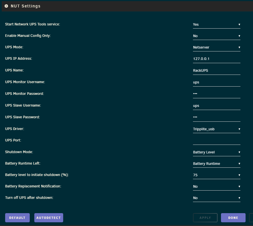

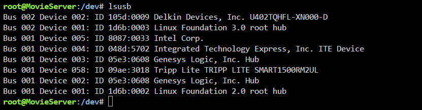

I have a new Tripp Lite UPS, i previously had an APC UPS configured and it worked fine. I can't seem to get NUT to work with my UPS. When i run Autodetect, it doesn't display anything and the Done button illuminates. When you click done, it selects Blazer_usb. I have tried both Tripplite_usb and Usbhid_ups. Neither worked. I ran lsusb and you can see in the attached image the UPS is connected. I have tried typing auto in for port as well. Any idea?
Hello!
You seem to be using an extremely old version of the plugin, a lot of changes have been made to the autoconfigure mechanism and drivers since.
Please uninstall your outdated plugin and install "Network UPS Tools (NUT) for UNRAID" by Rysz from Community Applications ("Apps" Tab).
When you first set it up, best choose "Reset Config" to clear the old configuration and then "Auto Config" for auto detection of your UPS.
Also please make sure to never use the same usernames for Monitor and Slave, this can lead to unexpected behavior.
Please let us know if it worked for you 🙂
Edited by Rysz
10 minutes ago, Rysz said:
Hello!

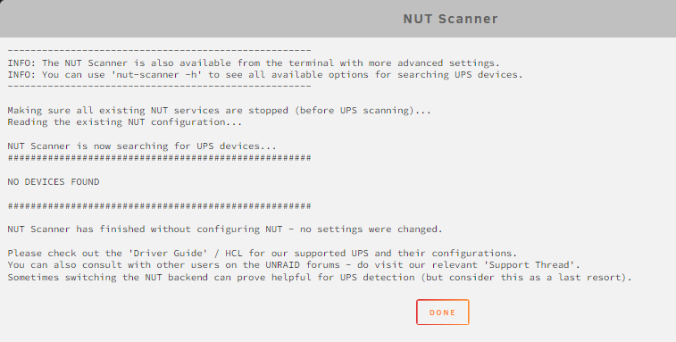

Ok so, i upgraded, reset config, ran a scan. It didn't find the UPS.
