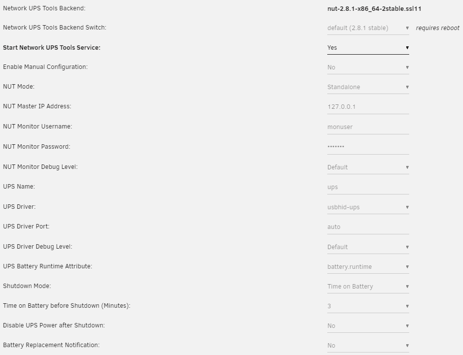

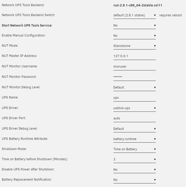

Hi.
I am brand new to NUTS and Unraid, but my Unraid server is up and running with most of what I need running on it, so it was time to get the UPS up and running.
I have Powerwalker VI 1200 up and running.
A week ago I installed NUTS, and got it up and running straight off the bat. But a few days ago it had stopped which I noticed since the Page Footer was no longer showing.
I get the following message when trying to start it:
NUT was not able to start successfully - please check the SYSLOG for more information.
Log file says:
Nov  7 02:08:02 Tower kernel: PMS LoudnessCmd[21473]: segfault at 0 ip 0000147258511080 sp 000014725394a0c8 error 4 in libswresample.so.4[147258509000+18000] likely on CPU 2 (core 2, socket 0)
Nov  7 02:08:02 Tower kernel: Code: 01 cf 4c 39 c7 72 e3 c3 cc cc 8d 04 49 48 98 4d 89 c1 49 29 c1 48 63 c2 48 63 c9 49 39 f9 76 75 f2 0f 10 05 02 05 ff ff 66 90 <0f> bf 16 0f 57 c9 f2 0f 2a ca f2 0f 59 c8 f2 0f 11 0f 0f bf 14 06
Nov  7 02:08:04 Tower root: Updating permissions for NUT...
Nov  7 02:08:04 Tower root: Checking if the NUT Runtime Statistics Module should be enabled...
Nov  7 02:08:04 Tower root: Disabling the NUT Runtime Statistics Module...
Nov  7 02:08:05 Tower flash_backup: adding task: /usr/local/emhttp/plugins/dynamix.my.servers/scripts/UpdateFlashBackup update
Nov  7 02:08:05 Tower root: Network UPS Tools - Generic HID driver 0.52 (2.8.1)
Nov  7 02:08:05 Tower root: USB communication driver (libusb 1.0) 0.46
Nov  7 02:08:05 Tower root: libusb1: Could not open any HID devices: insufficient permissions on everything
Nov  7 02:08:05 Tower root: No matching HID UPS found
Nov  7 02:08:05 Tower root: Driver failed to start (exit status=1)
Nov  7 02:08:05 Tower root: Network UPS Tools - UPS driver controller 2.8.1
Nov  7 02:09:05 Tower flash_backup: adding task: /usr/local/emhttp/plugins/dynamix.my.servers/scripts/UpdateFlashBackup update
I tried running the Auto Config and it produced the following information:
[nutdev1]
driver = "usbhid-ups"
port = "auto"
vendorid = "06DA"
productid = "FFFF"
bus = "001"
device = "017"
busport = "003"
###NOTMATCHED-YET###bcdDevice = "0003"
I did nothing to the setup myselves after it worked until it stopped, but the setup I am messing with now looks like this:
Any help would be greatly appreciated.
PS: Where is the configfile for NUT located?

6 minutes ago, tormi said:
Hi.
Log file says:
[nutdev1]
port = "auto"
vendorid = "06DA"
productid = "FFFF"
bus = "001"
device = "017"
busport = "003"
I would suggest to "Reset Config" and then set it up again as in your screenshot.
Maybe there are some broken parts in your configuration that's causing the issue.
You can see the configuration files at the end of the "NUT Settings" page.

Thanks for suggestion. Reset and reboot did nothing.
I have not added anything to the config file, neither did I do this when I got it working on the first try. (Should something be added here?
Logfile does not have as many errors now, but Driver fails to start.

Did you also try "Reset Config" and then afterwards "Auto Config" again?
If possible can you send me a PM with your debug package after "Auto Config" - it's on "NUT Settings" page:

Nice to have a fellow PowerWalker with me. I was just going to write to @Rysz right now because mine started up again by magic:
As it is fresh in my memory I will post excactly what I did.
1. Turned off the server (I still hadd NUTS installed, so this time I did not unistall it)
2. Change USB port (again)
3. Fired up Unraid, and tried to start NUTS to no avail.
  • At this point my NUTS settings was like on the picture EXCEPT that "Enable Manual Config" was set to "something like UPS Device" (I don't remember the excact wording and I will not shut it down to find out :)).
4. The next I did was: Reset Config
5. I forgot to do Auto Config :)
6. I still did not work.
7. The ONLY thing I changed then was "Enable Maual Configuration" to "NO".
And voila, it is working again. Lets hope it lasts this time. Give it a try and GOOD luck.
@Rysz If you want to take a look at my config now, it is available, just let me know.
Thanks a lot for sending me the NUT debug packages with your respective configurations. I've just compared the two configurations and it seems the NUT Scanner (= "Auto Config") misdetected either your USB port's information or UPS device's information. As a consequence, particularly by writing that wrong information into the configuration file, the UPS driver then only tried connecting to a UPS with said wrong information (and not all other possible UPS combinations it otherwise knows).
That's unfortunately one of the pitfalls when using "Auto Config". It aids detection, but makes the UPS driver "blind" to any other UPS devices it would usually otherwise know. I'll have to put this as a warning message somewhere, for more tricky UPS devices or UPS detection scenarios like yours.
To further illustrate this, here we have the old ups.conf configuration (with "Auto Config"):
	port = "auto"
	vendorid = "06DA"
	productid = "FFFF"
	product = "Offline UPS"
	serial = "000000000"
	vendor = "PPC"
	bus = "001"
	device = "029"
	busport = "009"
And this is the working new ups.conf configuration (without "Auto Config"):
driver = usbhid-ups
port = auto
When all those vendorid, productid, bus, device, ... parameters are not given to the UPS driver it basically starts lock-picking all possible other combinations of any UPS devices it otherwise knows, instead of just trying that one UPS device that NUT Scanner (= "Auto Config") has given to it.
That seems to have been successful in your case, by not pinning the UPS driver onto a specific USB port or UPS device it managed to autodetect it somehow else straight away. But in other cases it would need exactly that information we've now dropped to detect the UPS in the first place - so it remains a double-edged sword.
So in your case please do not use "Auto Config" for that UPS (it doesn't seem to work well in this specific case) and best don't change any of the UPS Driver Settings anymore now that it works. It should then continue working even after a system reboot. 🙂
Users with similar troubles I would recommend to attempt "Reset Config" and then not use "Auto Config" straight away, but instead try their respective UPS Driver with UPS Port set to auto first.
Edited by Rysz
Thanks for the explanation @Rysz and the hints with your settings @tormi. A reboot, reset config and then start the service with manual config worked for me. It runs as expected now. Thank you again 🙂
I'm very glad to hear it, thanks for your patience with this.
I'll be including a warning message before starting "Auto Config" as part of the next update.
