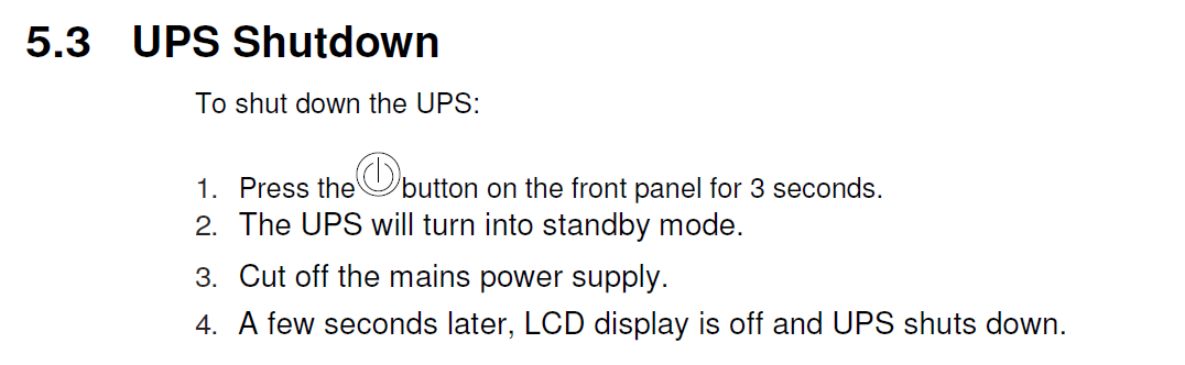

if i set 'Disable UPS Power after Shutdown=yes' all working fine , my ups goes to 'Standby' after power loss , and then power up when power return to normal.
but is anyway i can turn OFF completely the UPS ? or it will not power on then if it possible at all?
using Eaton 9E2000i (Online UPS)

NUT has no more control over this behavior except for telling the UPS to turn off the power. How the UPS handles that depends on the implementation on the UPS itself, maybe there's a setting directly on the UPS. Maybe - I'm guessing here - because you have an online UPS (where the power to the devices is never coming entirely from the mains power) it's never going to fully turn off but will just kill the power to the outlets and remain in standby until it it sees that the AC is back online.
I'd check out the user manual and perhaps contact Eaton over this, they are very supportive of the NUT project so I'm sure they'd be able to tell you more about this. For instance my line-interactive Eaton 5P850 turns completely off after shutdown, but that's a line-interactive and not online one.
Is the LCD going dark when it "shuts down" or how do you notice it's actually "shutting down" (or going to standby mode as you described)? Does it cut the power to the outlets?
Edited by Rysz

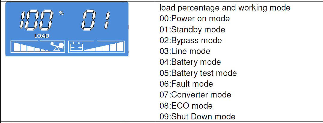

it has two sates (off):
1. stand by   (no power supplied to outlets) but LCD working and fans in ups working in low noise .
2. power off ( complete shut down nothing working at all )
from user guide:

Also checked after nut send FSD OB and power down , it has :  01 - Standby Mode

Did you check upscmd for your UPS if there's anything else?
upscmd -l <upsname> should show a list of available commands.
