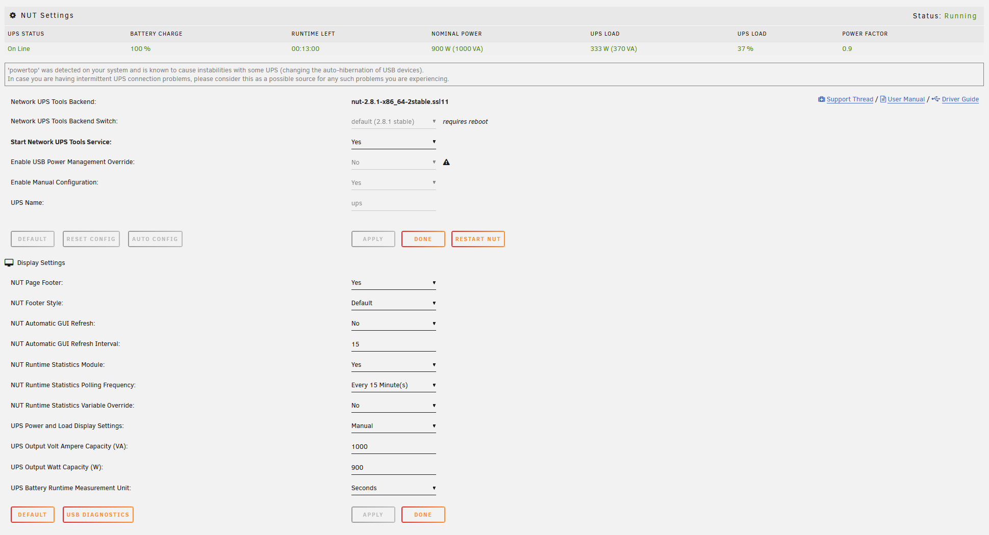

Migrated from the legacy NUT plugin, and all is working fine -- but I can't see where the "automatic shutdown" options have been moved to. If I'm not mistaken, the legacy plugin had support for this. Am I just blind?
Is there any way to enable auto-shutdown of the local Unraid host as a UPS battery percentage level?
Does anyone know how to trigger Unraid's graceful shutdown, versus a generic power-off that may not wait for Docker/VMs to shutdown and unmount the array first?
There isn't one. Shutdown/reboot always stops everything cleanly.
Options are on the NUT settings page where you'd expect them?

Unless I'm seeing something different to you, the only place I can see power settings in the NUT config section of Unraid -> Settings is in CLI for "/etc/nut/upsmon.conf"
MONITOR [email protected] 1 monuser monpass master
SHUTDOWNCMD "/sbin/poweroff"
POWERDOWNFLAG /etc/nut/no_killpower
NOTIFYFLAG ONBATT SYSLOG+EXEC
NOTIFYFLAG ONLINE SYSLOG+EXEC
NOTIFYCMD "/usr/sbin/nut-notify"
Didn't there used to be a GUI option to configure this, or am I just misremembering?
It's there for me...
It's because you're using manual configuration mode where everything is supposed to be configured through the configuration files. You'll have to set manual configuration mode to "No" or "for UPS Driver" (if your UPS needs custom settings to be recognized) in order to see the GUI options. I'm guessing you enabled manual configuration mode because your UPS.CONF file has special directives needed for your UPS, so I'd switch to "for UPS Driver" so that those are kept unchanged but you can still use the GUI.

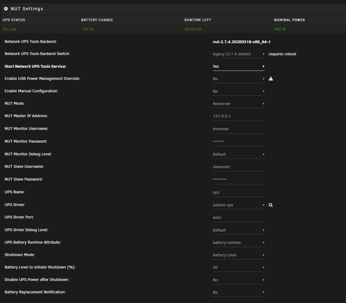

First of all, thanks for maintaining this plugin!
Unfortunately i had 2 power cuts in the last week that lasted more than the normal few seconds, and some weird stuff happened, and i cant figure out exactly whats wrong.
In attachment, debug zip, and print screens.
Sequence of events:
The settings are set to power off when battery.runtime < 300. UPS battery is quite new, and seems to be reporting accurate runtime.
21:30 The power failed
21:26 NUT script decided it was time to shutdown the server. But runtime at that time was >900s left (check last image)
(Somehow the server started back up, unrelated to NUT, i have to check my BIOS settings... i guess wake by USB or something is causing this)
At 21:29, it was back up, and battery runtime was 822.
At 21:39 NUT script decided it was time to shutdown, this time with the correct runtime left.
Not sure how to debug this at all.
I took a look at the scripts and all looks great, the only way i see to this fail is if the upsc command fails, making grep/awk fail causing the -gt comparison to fail somehow (nut-notify@L72), I'm probably way off on this, my bash script skills are 0 to none 🤣
nut-debug-20240315085147.zip
Edited by danielb7390

Thanks for the detailed information, I think you could be right about your observations. Another possibility is that NUT has lost communication with the UPS for a short time and by in-built backend behaviour NUT always considers a non-communicating UPS that was last seen on battery as critical and immediately sets FSD and shuts down. But since the other computer managed to remain in contact with the UPS a failing command chain is more likely. That script is a 7 years old and could use some general overhauling. I'll introduce some safeguards against any failing upsc-grep-awk chains, which I'm generally not that happy with in their current state, with the next update but it might take a while.

This is fixed now - thanks a lot for your investigation, I've taken the liberty of crediting you in the changelog. If you're interested how I solved this: https://github.com/desertwitch/NUT-unRAID/blob/2b7b5113df28836b68e1089d81cdf6095eec861e/source/nut-dw/usr/sbin/nut-notify#L71-L102
