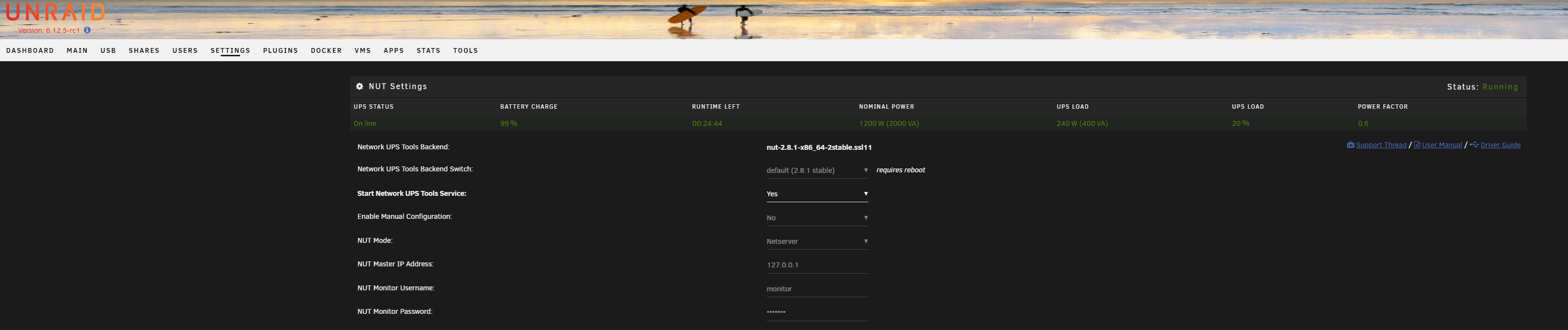

20 hours ago, Fribb said:
This morning I got the message "Warning communication lost with UPS".
I checked my NUT Settings and the UPS is listed as "On Line" with battery charge and NUT Details. But in the UPS settings it states "Lost communication". I already restarted both services and also switched USB ports without any change.
I do see a few warnings in the syslog like "Poll UPS failed - Data stale" or when I restart the NUT service I get "WARNING: send_to_all: write 34 bytes to socket 16 failed (ret=-1), disconnecting: Broken pipe"
diagnostics are attached.
I have the CyberPower CP1500EPFCLCD for a year now which was running without any issues.
"UPS Settings" has nothing to do with NUT, it's a separate tool (apcupsd).
In fact you should set "Start APC UPS daemon:" to "No" under "UPS Settings".
NUT and apcupsd cannot run at the same time - they'll interfere with each other.
Data stale warnings are usually USB timeouts and nothing to worry about.
Broken pipe warnings always occur when killing the NUT service, that's normal too.
So as long as everything works, "Start APC UPS daemon:" to "No" and you're all good.
Interesting, I disabled the UPS Settings and NUT seems to show everything again. Though I am wondering why it worked for a year and just now wants to crap the bed...
Thanks for the easy fix.

So for the most part I have NUT working... in the background. But I can't see anything in neither the stats page or the main nuts page giving me information about the UPS's.  The config works and is running from what I can tell from the logs.
I'm wondering why it doesn't show? although it reads info, batteries etc just fine when running upsc device@host
This actually seems to be a previously unknown shortcoming of the plugin when operating in manual configuration mode. I'm guessing that most people usually configure via the GUI and hence this problem hasn't surfaced any sooner. I'll take a look at possible solutions and will push an update once I have it figured out. In the meantime NUT itself should function normally, just in the background, even if the GUI shows nothing.
I have just pushed an update which fixes your issue. The "UPS Name" setting now remains visible also in Manual Configuration mode, letting you set which of your configured UPS you want the GUI dashboards to show information for. At present you can only choose one UPS to display information for in the GUI (by setting the "UPS Name" to that configured UPS' name). Showing multiple UPS in the GUI requires a larger developmental effort so I'll have to put this on the TO-DO list for now. Hope that helps... 🙂
