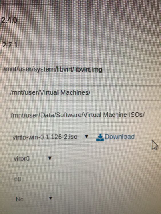

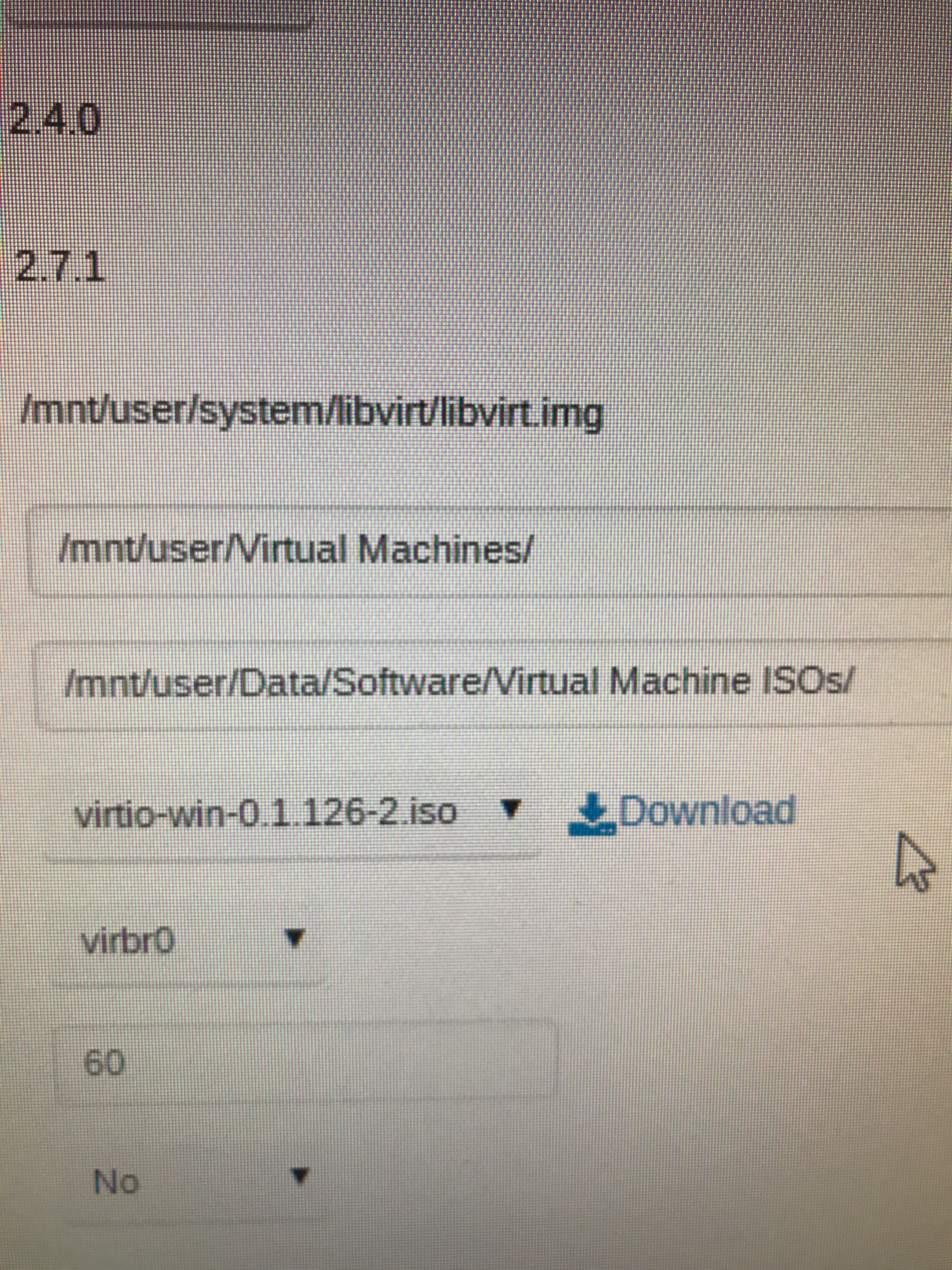

If ISO Library location (tested on that.  Didn't test the storage for domains) has spaces contained within it, then the first "word" is automatically created.
Here is an update.  I have turned off all my dockers, and actually deleted them all.  Then turned off the docker all together.  I made sure there were no spaces in the share I am trying to delete.  I deleted it, rebooted.  Low and behold....It came back again!
Hahahahaha - SQUID, you nailed it.  So, doing some research in terminal, I found out that I have Folders in root called - Virtual, Machine, Machies, and ISOs.  Only Virtual was showing up in Shares, but the other 3 were coming back in root after a reboot.  So I had a total of 4 folders, one as a share that kept coming back after a reboot.  Squid, I went to my VM Settings, and low and behold, I have attached a picture of what I saw.  I renamed them with underscores, and they never came back after a reboot.  Thank you for the help!
