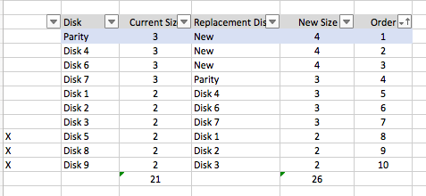

From a planning standpoint, I am going to first upgrade my Parity drive, re-establish parity, then roll through the drives in the following order.  For most drives, the new "destination" drive is larger than the current drive.  In the end, I will have 3 "leftover" 2GB drives.
Let me know if you see any holes in the plan or any "gotchas" to the conversion.

@trurl   Sorry for my poor choice of words regarding parity.  As I plan to increase drive sizes during the conversion process, my planned first step is to upgrade the Parity drive and let unRaid rebuild on the larger disk.  After that is complete, then move onto to the file system change process by using a blank drive (pre-cleared) formatted to XFS, and copying data over following the "Mirror each disk with rsync, preserving parity" process.   I plan to use this process because I have a mix of user share and excluded drive.
I hope I am on the right track.

Your plan sounds fine.
I would also recommend you look at 8T drives. I know they cost more, but the $/T is about the best for a 6T and very close behind is the 8T drive. You will likely pay more per terabyte for a 4T drive then either the 6T or 8T unless you get them on sale for a deal. It would cost more to add 2 x 8T drives compared to 3 x 4T drives, but if you add another 8T drive the cost of that 8T will be less then adding yet 2 more 4T drives.
