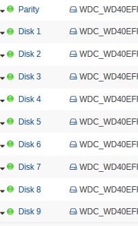

Can we get the "Table view spacing" capabilities back in the 6.4 GUI.  As you can see from the attached graphics there is much greater space between drives in 6.4 compared to 6.3.5.
Edited by BobPhoenix

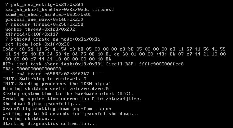

Having a few issues, and my log file is from 6.3.5.  First off, the after downloading the upgrade, I was unable to reboot or shutdown the server via the webgui.  It went through the motions as if it was shutting down but it remained in the Array Offline state.  I ended up restarting the server via IPMI which worked.
After it came up as 6.4, it was stuck on Starting Services on the bottom left.  I left it running for at least 30 minutes and the status never updated.  My docker containers were running as if the array was fully functional.  I ended up hitting Shutdown via the webgui and was stuck once again, so I rebooted via IPMI.  On the next reboot, I was stuck on Mounting disks (for over 30 minutes) and I hit shutdown via the webgui.  I am now stuck once again, here's what I see via IPMI.
The most recent log on the Server was from 6.3.5 and it has not saved any new logs since the upgrade.  How should I proceed?
