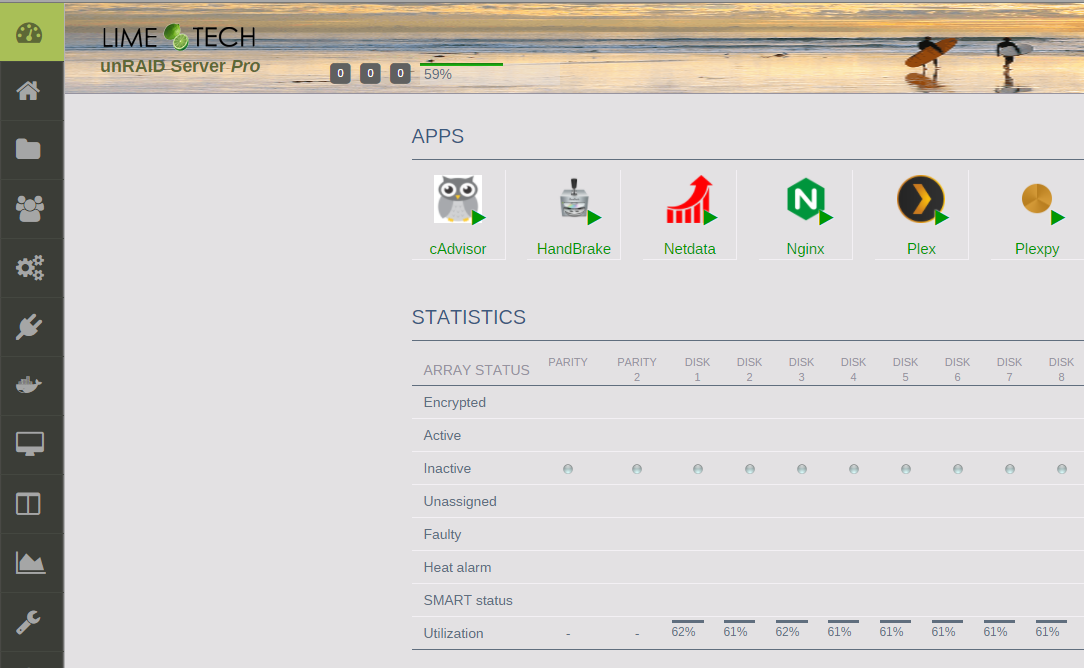

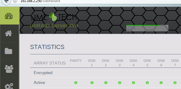

6 hours ago, Zonediver said:
Found also an issue with the new interface - its a gray transparent area with a green bar.
How did you get that GUI?
Setting->Display Settings->Dynamix Color Theme->Azure

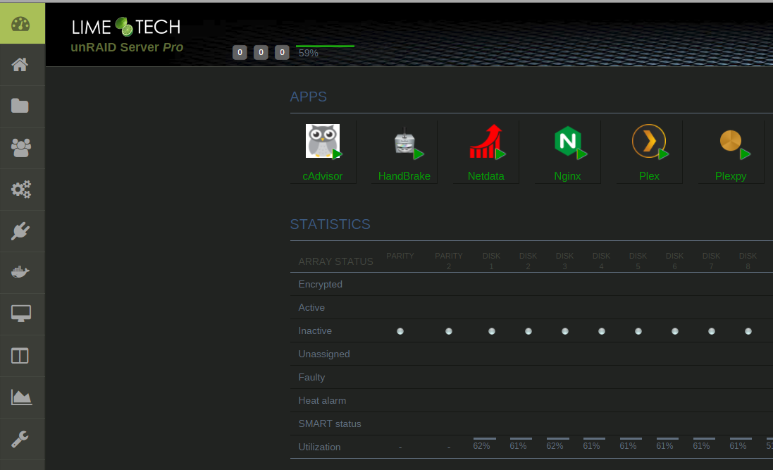

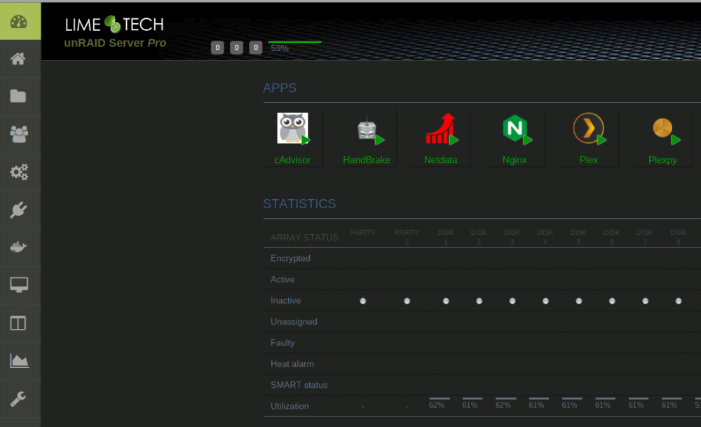

Small graphical anomalies with the new "Azure" theme (Dashboard):
This is a browser artifact and happens when browser scaling is set larger than 100%. Different browsers give different results when scaling.
Choosing the right combination of banner and theme makes a difference.
Edited by bonienl
@bonienl: Has the banner a different size now? What means the "right" combination?
Edited by Zonediver
Depending on your screen resolution the banner can be made wider than the original width of 1270px.
Themes white and black go up to 1920px, while themes azure and gray use the full screen width for the banner.
"Right" in this context simply means when choosing a GUI theme some banners display better than others, but it is all personal preference.
Thanks for this hint - i use Azure and Grey (verry cool by the way xD) and my Screen has a resolution of 1680x1050 - so what shall i choose for the banner width? 1680?
Yes, in your case 1680 will exactly fit your screen when using the new themes. When the banner is smaller it will be stretched.
Yep - i got it - 1680 is perfect. Thanks bonienl.
