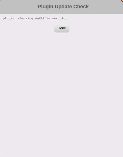

Noted the following on 6.4:
=> On the Plugins page, clicking "Check for Updates" does a check, but after it's done still shows Status: Unknown for my only plugin (Dynamix Cache Directories)
 => On the new "OS Update" page in Tools, clicking "Check for Updates" does a check, but it also shows Status: Unknown after the check.

If status is unknown then the repository (github or Limetech) could not be contacted. Do you have internet connection from your server?

Yes, it should have a connection.   It had no problem getting the update from 6.3.5 and the checks always worked fine then.

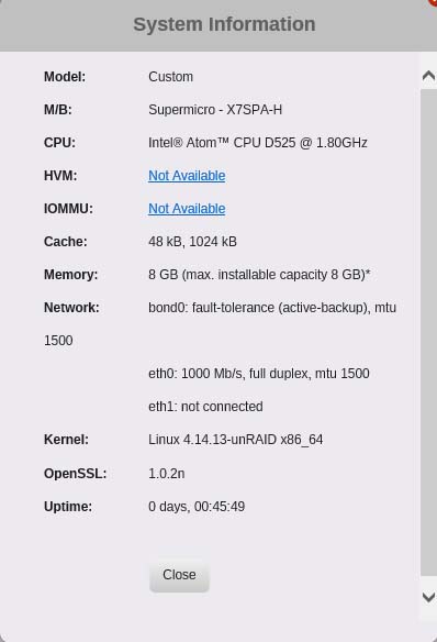

This seems to show a GB connection, so I'd think it would be able to connect for the update checks.
That is only the physical connection state, no guarantees that communication is possible.

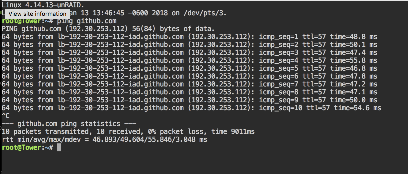

What happens with (terminal window)
ping github.com

The ping results in a series of 64 byte packets being received until I hit Ctrl-C, which stopped it and gave the following results:
GitHub.com ping statistics
58 packets transmitted, 58 received, 0% packet loss, time: 57075 ms
rtt min/avg/max/mdev = 44.465/51.391/82.397/5.597 ms

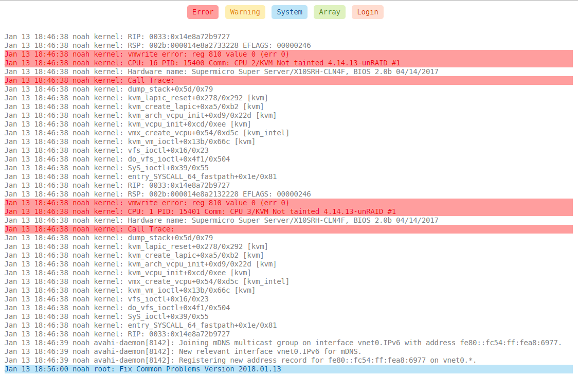

As requested here:
"Some users report vmwrite syslog errors as a result of VM startup. This is a harmless message and can be ignored; however, please report if you see this."
