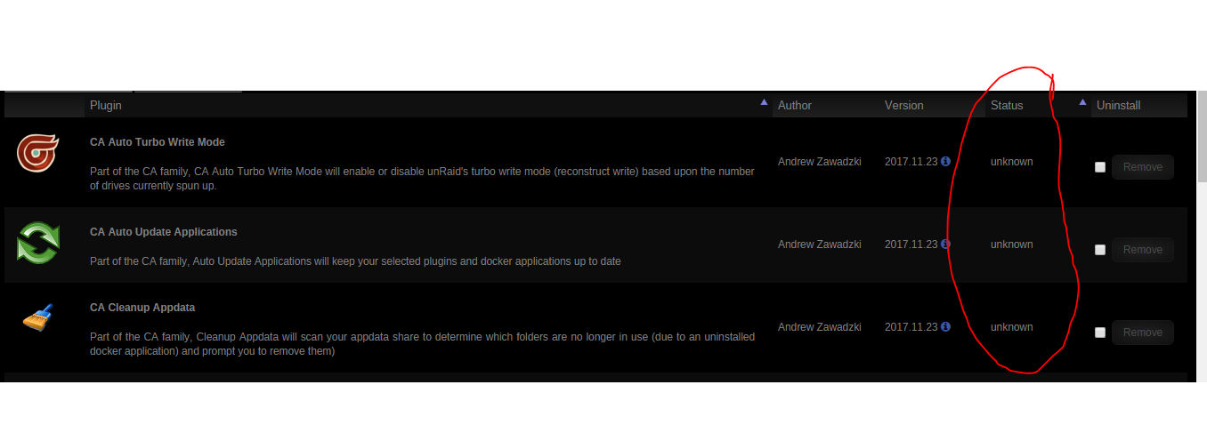

I'm having problems with plugins. All statuses show "Unknown" on the plugin page and I am receving this error:
Jan 13 12:25:21 Tower root: error: /plugins/unassigned.devices/UnassignedDevices.php: wrong csrf_token
Jan 13 12:25:23 Tower root: error: /plugins/unassigned.devices/UnassignedDevices.php: wrong csrf_token
Jan 13 12:25:23 Tower root: error: /plugins/preclear.disk/Preclear.php: wrong csrf_token
https://lime-technology.com/forums/topic/46802-faq-for-unraid-v6/?page=2&tab=comments#comment-545988

8 minutes ago, gar13 said:
Thanks Squid, that fixed the log issue, but still not able to see status of all Plugins
I left that one alone due to your cert problems.  A status of unknown is where the system is unable to determine the available versions because it can't communicate with GitHub.com
