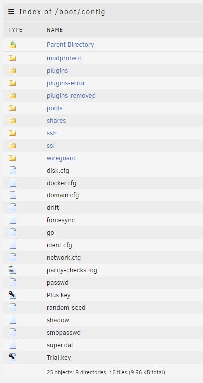

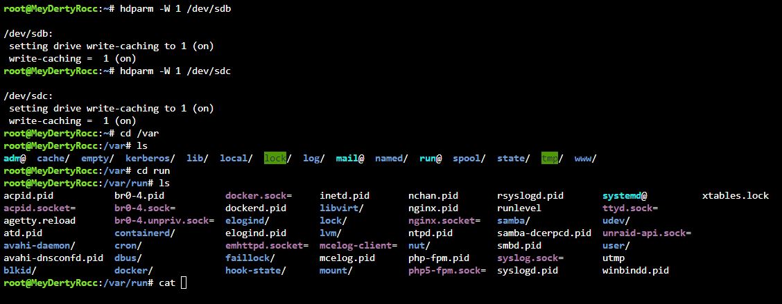

I am having issues with mover not "moving".
Troubleshooting so far:
  1. Removed age requirement
  2. Lowered cache space threshold
  3. Stopped docker tried to execute mover
  4. Setting share "use cache pool" from yes to no, then back to yes
  5. Looked for shareCacheEnabled="yes" in /config/share.cfg but my usb does not have that file?
  6. Looked for mover.pid but again not on my system?
I've read some people suggest that dual drive cache eventually creates problems for mover. I don't know why since it is just in RAID1 config basically right?
meydertyrocc-diagnostics-20230722-1259.zip
Edited by sharkaccident
I've uninstalled CA mover and everything seems to be working with default Unriad Mover utlity.
5. I believe the following should fix your issue. Go into terminal and paste the following:
echo shareCacheEnabled='"yes"' >> /boot/config/share.cfg
This will add share.cfg to your config with the appropriate line. Let me know if the mover tuning plugin works now.
EDIT: I think the other way to have the file created would be to edit your global share settings. "Settings>Global Share Settings"
6. I believe mover.pid will only exist while the mover is running. I may be wrong though.
Edited by Swarles

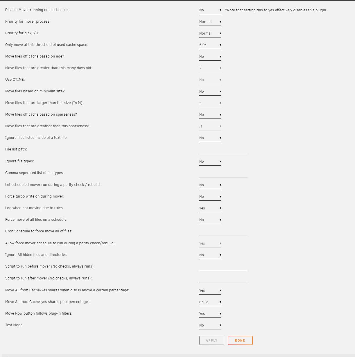

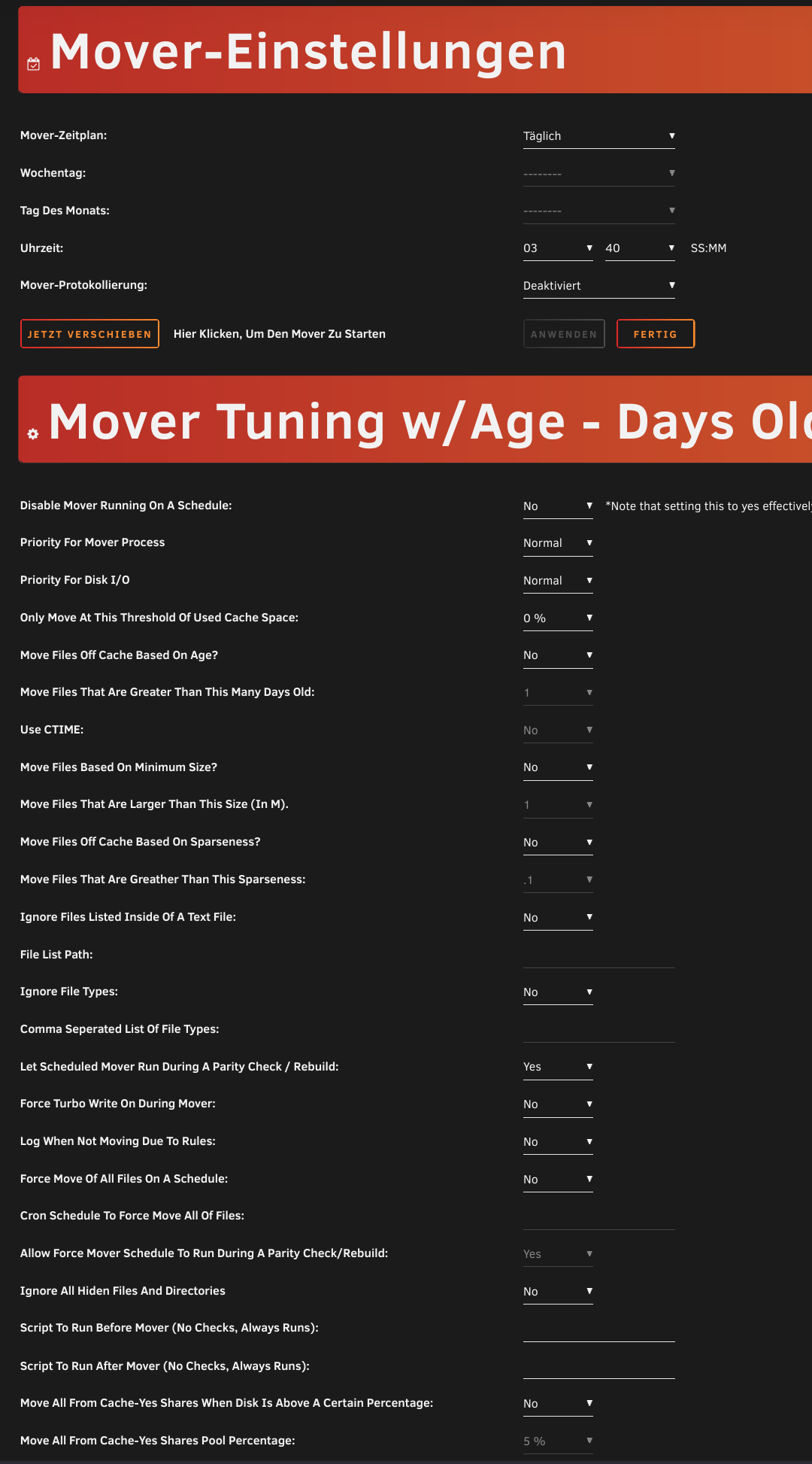

I have installed the plugin on 6.11 and the mover not working.
How can I checked this on syslog or another log and fix this?
Here is the Config:
Edited by Revan335
Here is the Config:
What would be helpful is if you do the following:
  1. Go to “cd /boot/config” and identify if “share.cfg” file exists. If not follow the steps from my comment above yours and see if it is now working.
  2. otherwise:
  3. Enable Mover Logging.
  4. Set “Move Now Button Follows Plug-In Filters” to yes.
  5. Set “Test Mode” to yes.
  6. Run mover.
  7. Go to “cd /top/Mover” and share the .log file.
This should help us identify where the mover is progressing to / stopping.

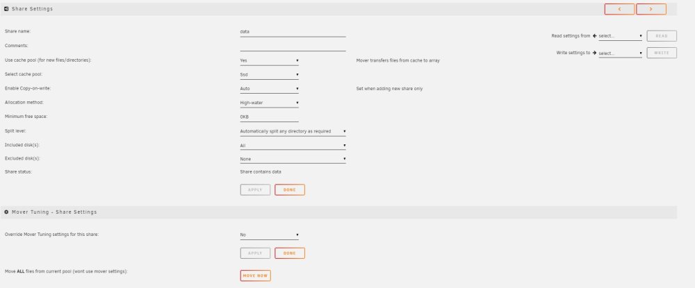

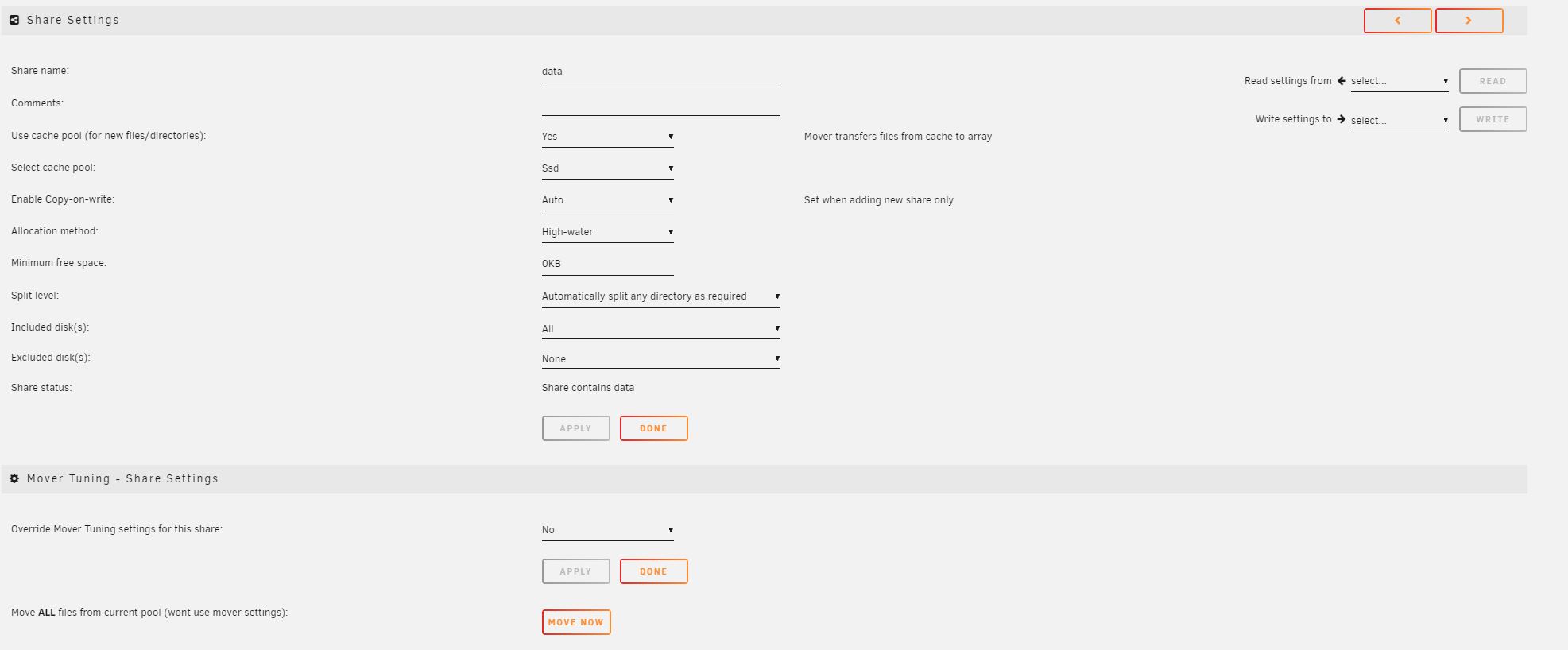

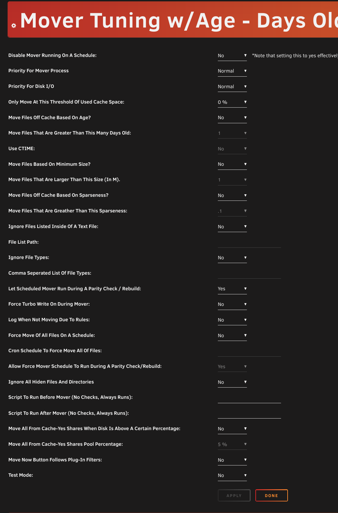

I'm having an issue where if I have this plugin installed mover starts and immediately stops without moving anything, but if I uninstall the plugin mover works fine.
I have 2 cache pools:
- Cache
- Sabnzbd
Any shares that use the Cache pool are set to Cache only, so mover only moves files from the Sabnzbd cache pool to the array.
When I install the Mover Tuning plugin, all I do is update this one setting;
Move Now button follows plug-in filters: Yes
and after that if I click MOVE NOW, mover starts and immediately stops, here is the log:
Aug 14 18:09:33 unRAID move: mover: started
Aug 14 18:09:34 unRAID move: mover: finished
I've tried reinstalling and updating the plugin and have messed around with some other settings, but after whittling settings away it looks like that's all it takes to keep Mover from running for me. I was wondering if it was an issue with my using a cache pool called Sabnzbd instead of Cache, but saw a thread on reddit saying that the plugin should work fine with multiple cache pools so now I'm not really sure what the issue is.

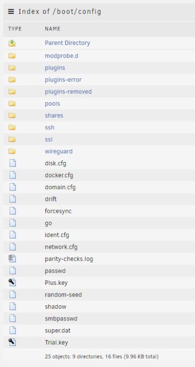

- Cache
- Sabnzbd
I can try help with this, first thing to check would be if "share.cfg" exists.
  2. If it does, verify that the line 'shareCacheEnabled="yes"' is in there.
  3. If no to either 1 or 2, do one of the following:
  • To have the file created by the system, edit your global share settings (edit, save, revert). "Settings>Global Share Settings"
  • OR; Paste the following in the terminal:
  • echo shareCacheEnabled='"yes"' >> /boot/config/share.cfg
If the file did exist and you verified step 2, do the following:
  1. Enable Mover Logging.
  2. Set “Move Now Button Follows Plug-In Filters” to yes.
  3. Set “Test Mode” to yes.
  4. Run mover.
  5. Go to “cd /top/Mover” and share the contents of the most recent ".log" file.
Edited by Swarles
