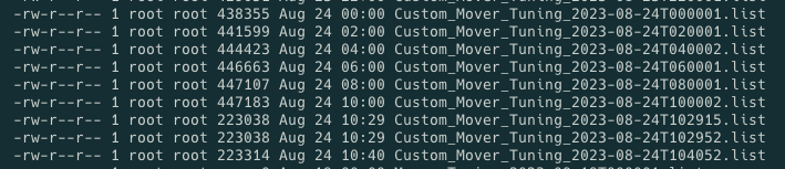

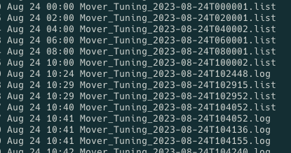

3 hours ago, Robbie G78 said:
So, should I still just run that command and that fixes it?
No, you have the pointer needed.
Can you send me a few mover logs from /tmp/Mover in a DM

Also having this same issue. I can invoke mover from the share page but cannot do so from the main page or the scheduler page. I have the "Move now button follows plugin filters" set to No.
I sent some logs and all my settings being used to hugenbdd.
What I have not tried is toggling the button filter to yes the back to no or removing and reinstalling the plugin.

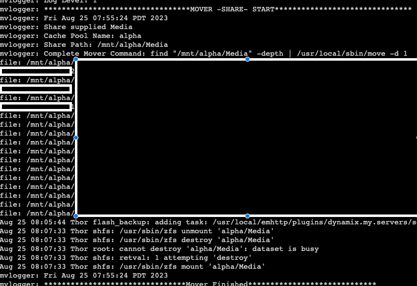

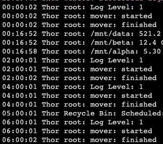

I'm having this same issue, same issue as @Robbie G78.
Move button doesn't work from the Main screen and Scheduler. Scheduler is set to run every 2 hours
But when triggering from the Shares screen. Here is a clip of telling me I kicked the mover from the share screen. Please don't mind the redaction:
I removed the plugin and restarted my server. Added files to my cache drive then triggered Mover from Main screen and see that it's now working. I'm still playing around with it and waiting for Scheduler to kick off Mover in half an hour to see if it will move files.
I'll be back and let you all know if Mover is working when Scheduler triggers it.

Confirmed, Mover is triggered and working when using Scheduler. This is without the Mover Tuning Plugin
Installed Mover Tuning Plugin again and Mover again is not working after triggering from the Main screen :( Uninstalling for now.
update, after uninstall, mover works again when triggered
