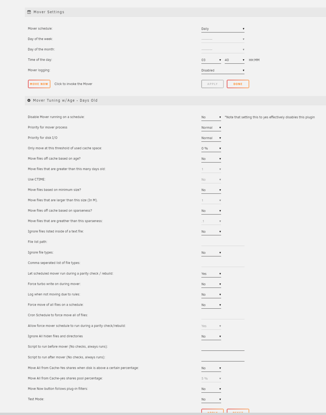

This is probably an issue with my config. I downloaded mover tuning
Even if I click Move now nothing happens it also does not run daily. If I disable "disable mover running on a schedule" and click Move now it will run mover. So it appears the issue is with mover tuning. These are the default settings when you download mover tuning. I must not be understanding something in mover tuning. What am I missing?
Well if you want to run mover you certainly don't want to disable it, do you?

Not sure you follow the issue with mover tuning enabled, mover does not run.
With "Disable mover running on a schedule" set to yes. I could get mover to run as expected.
You said "disable "Disable mover running on a schedule"", which would have meant setting it to No, which would have been normal.
So something else then.

No.....If I set it to yes then I can click move now and it moves the files. If its set to no and I click move now nothing happens.
Alternatively
With it set like I listed above which is to move daily (with disable mover tuning set to no) exactly like pictured above. Nothing gets moved files just sit on the SSD.

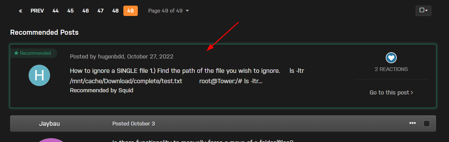

may just take a look at the recommended post on top of this topic ;)

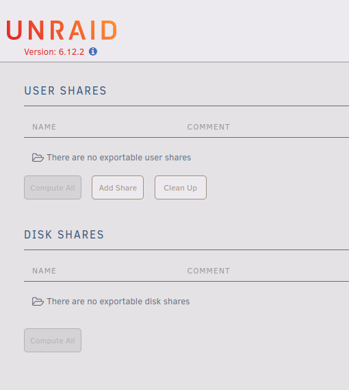

Afterwards I executed the mover and now all shares on the unraid GUI are missing under shares and nothing was moved
okay after a reboot the shares are back, phew.
