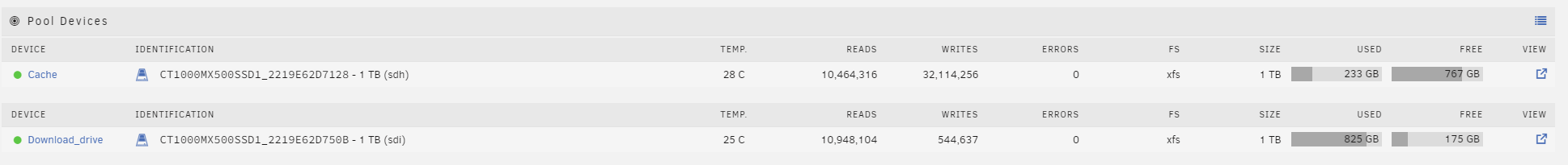

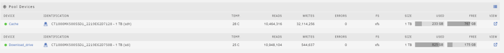

On 9/5/2023 at 11:30 AM, Magic815 said:
Not sure if my issue is tied into the (hopefully soon) forthcoming fix, but I realized my mover was not running in v6.11.5 recently.
My leading theory was that there might be an issue with me having two cache drives (one for appdata, which I call 'cache' and one for downloads which I call 'download_drive').
In the case of the following setting:
Only move at this threshold of used cache space
If I have that set to 50%, is it waiting until both drives reach 50%? Is there a way to trigger it based on just the 'download_drive' specifically, in my case.
I'm running the same OS version. I'm believing its the newest update to the Plugin.  However, I think my version is working I"m not 100% sure. Lol I haven't checked my files in a while.

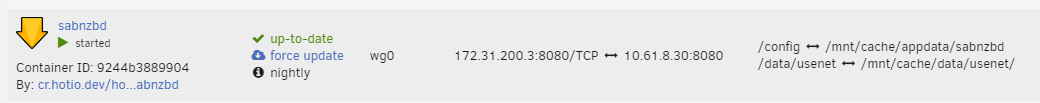

On my cache drive I have a share called 'data'.
SABnzbd use the cache 'data' share to it's Temporary Download Folder and Completed Download Folder.
The owner of the cache 'data' share is 'nobody' and everything works without any problems.
In the Mover Tuning - Plugin, I have setup "Cron Schedule to force move all of files: 35 3 * * *
The Plugin 'destroy' the cache 'data' share and create a new one with owner 'root' and after that SABnzbd can no longer get access to the share.
When I change owner back to 'nobody' and restart SABnzbd, SABnzbd works again.
Oct  2 03:35:04 unRAID shfs: /usr/sbin/zfs unmount 'cache/data'
Oct  2 03:35:04 unRAID shfs: /usr/sbin/zfs destroy 'cache/data'
Oct  2 03:35:04 unRAID root: cannot destroy 'cache/data': dataset is busy
Oct  2 03:35:04 unRAID shfs: retval: 1 attempting 'destroy'
Oct  2 03:35:04 unRAID shfs: /usr/sbin/zfs mount 'cache/data'
2023-10-02 02:10:13,845::INFO::[_cplogging:213] [02/Oct/2023:02:10:13] ENGINE Bus STARTING
2023-10-02 02:10:13,950::INFO::[_cplogging:213] [02/Oct/2023:02:10:13] ENGINE Serving on http://0.0.0.0:8080
2023-10-02 02:10:13,950::INFO::[_cplogging:213] [02/Oct/2023:02:10:13] ENGINE Bus STARTED
2023-10-02 03:35:07,990::ERROR::[filesystem:728] Failed making (/data/usenet/incomplete)
  File "/app/sabnzbd/filesystem.py", line 722, in create_all_dirs
    os.mkdir(path_part_combined)
FileNotFoundError: [Errno 2] No such file or directory: '/data/usenet/incomplete'
2023-10-02 03:35:07,992::ERROR::[filesystem:396] Cannot create directory /data/usenet/incomplete
2023-10-02 03:35:07,992::ERROR::[filesystem:728] Failed making (/data/usenet/complete)
FileNotFoundError: [Errno 2] No such file or directory: '/data/usenet/complete'
2023-10-02 03:35:07,992::ERROR::[filesystem:396] Cannot create directory /data/usenet/complete
2023-10-02 03:35:07,993::ERROR::[filesystem:728] Failed making (/data/usenet/incomplete)
