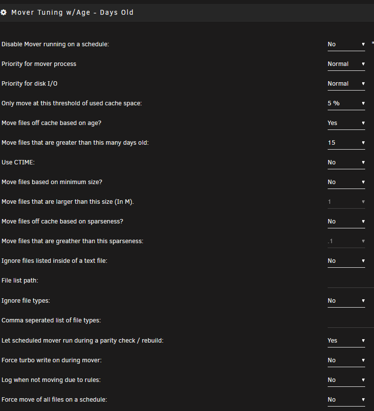

I have over 600gb on my cache and my settings are image.thumb.png.05405a3405031476cccdf02bf529ad9f.png
Even with forcing mover to run, it still doesn't move any of the files. Could this be a mover tuning issue or a hardlinks issue?
You've set to only move files that are more than 15 days old, that might be why.
Edited by Kilrah
Most of the files are over a month old. I understand the settings but its not moving files that are well over 15 days.
I was trying to run it nightly for files over 15 days old but they are just accumulating and not moving

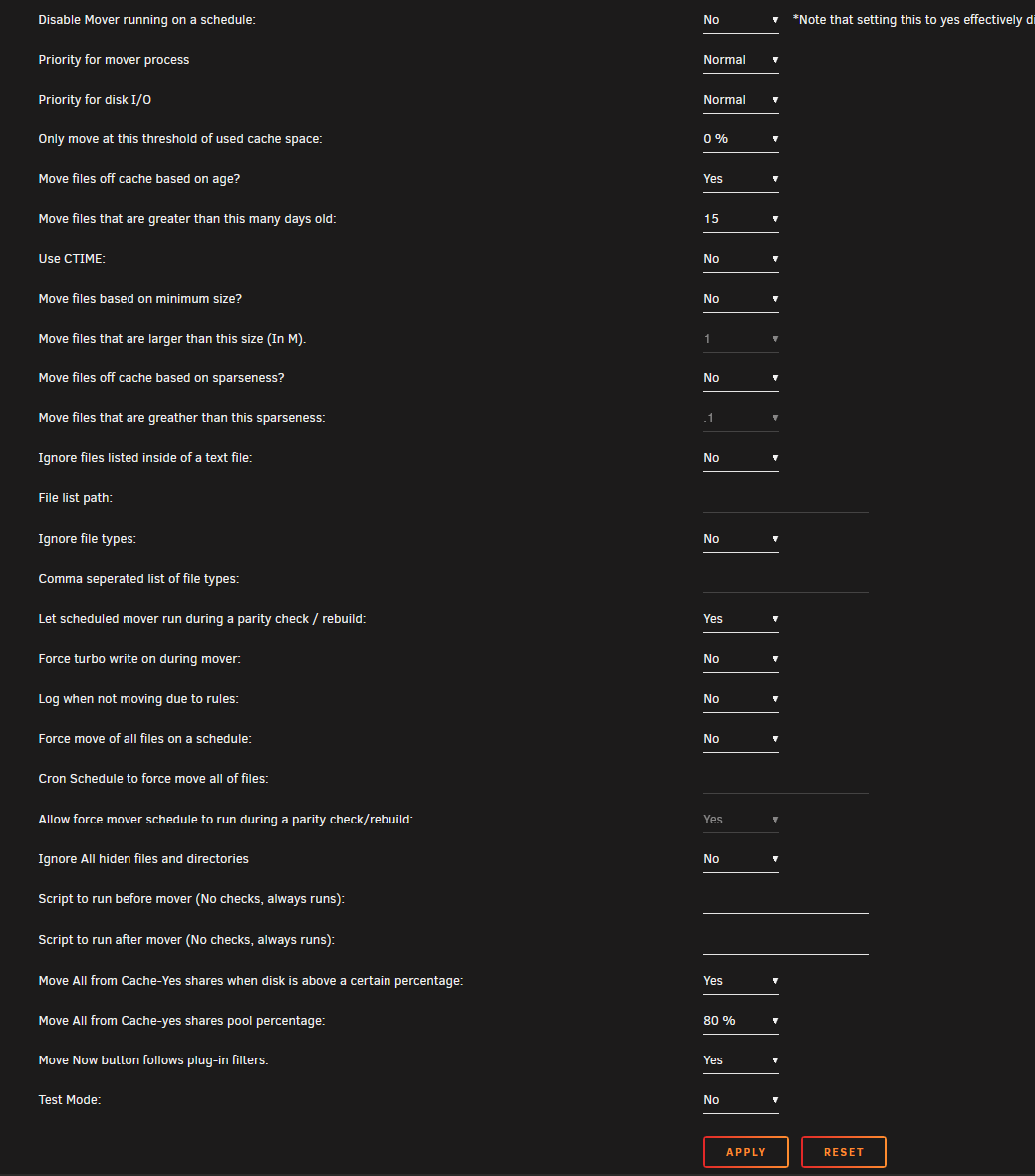

What are all your settings?
