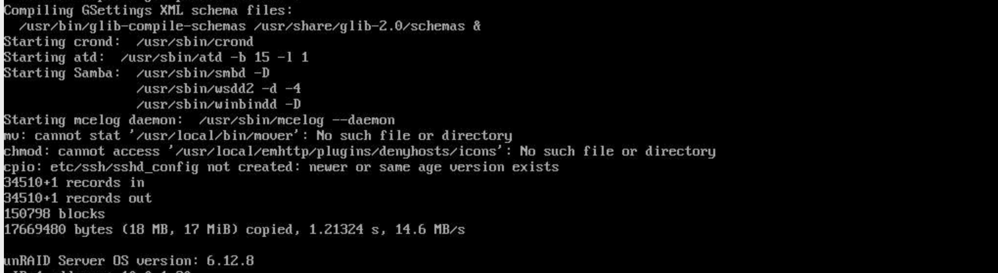

42 minutes ago, wgstarks said:
For me the error has only showed up on reboot in the console. Not in the system log.

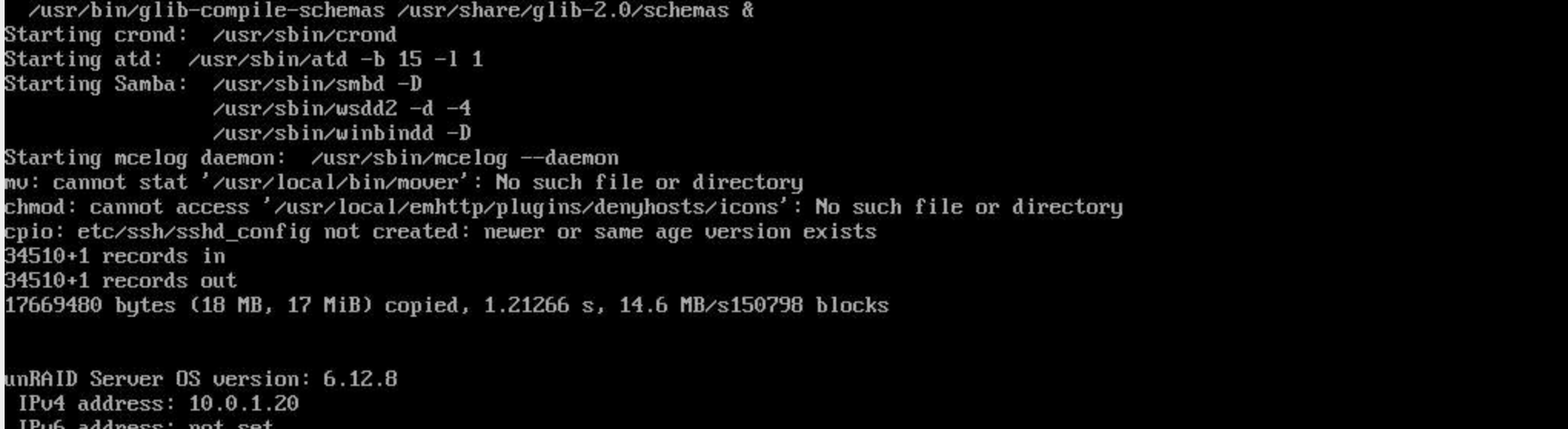

Tried uninstall-reboot-reinstall. Didn't work. performed another reboot after the reinstall and still seeing the error.
568259067_Screenshot2024-02-24at9_10_15PM.thumb.png.25ac29f923bd54d92f26a0943ee4d418.png
Oh okay during boot makes sense, I have found the issue.
line 113 of "ca.mover.tuning.plg"
if [[ ! -f /usr/local/bin/mover.old ]]; then mv /usr/local/bin/mover /usr/local/bin/mover.old; fi
I uninstalled the plugin and rebooted and it would appear that unraid does not initialise a "mover" file in "/usr/local/bin/mover" (on 6.12.8 at least). "move" is located in "bin" and "mover" is located in "sbin".
I don't know enough about unraid to know why this is the case or what the configuration is in older OS. It's probably important for people on older OS. I can confirm that this is not an issue to worry about though.
We could change it so it checks if "mover" exists rather than if "mover.old" doesn't exist, thoughts @hugenbdd?

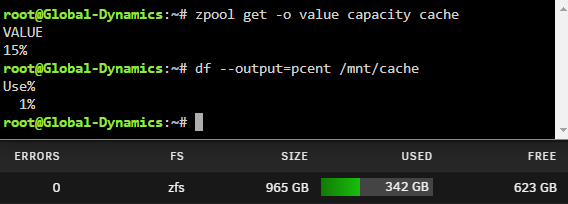

12 hours ago, Swarles said:
For the time being it will remain a whole pool basis unless someone else wants to implement it. In light of that which one do you think would be better to use going forward?
zpool get -o value capacity
OR
df --output=pcent
Both have issues. zpool commands use the raw capacity of the pool (including parity drives, etc.) and ignore the properties of the underlying filesystem. df is too aware of the filesystem and ignores everything in the datasets.

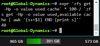

After a little playing around... How about zfs get instead?
318 / (318 + 580) = 35.41%
More than close enough to 342GB / 965GB = 35.44%
(Looks like just imprecision with GB vs GiB)
Get precise with the -p flag.
Plus some bash magic: (there was definitely an easier way to do this if it doesn't have to be a one line command lol)
expr `zfs get -Hp -o value used cache` * 100 / `zfs get -Hp -o value used,available cache | awk '{s+=$1} END {print s}'`
Tested again while letting the pool fill up:
