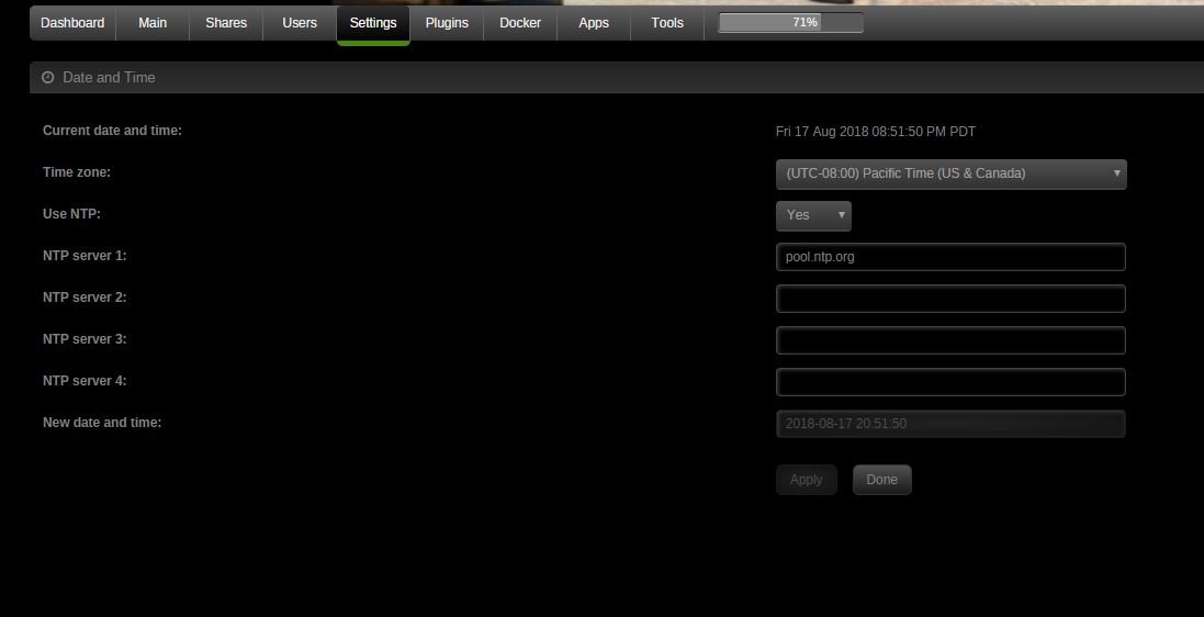

August 18, 20188 yr Author @limetech can you please see below errors and advise on how to resolve? Aug 17 17:35:32 Tower nginx: 2018/08/17 17:35:32 [error] 10387#10387: nchan: A message from the past has just been published. Unless the system time has been adjusted, this should never happen.Aug 17 17:35:32 Tower nginx: 2018/08/17 17:35:32 [error] 10387#10387: nchan: A message from the past has just been published. Unless the system time has been adjusted, this should never happen.
August 18, 20188 yr 1 hour ago, Switchblade said: @limetech can you please see below errors and advise on how to resolve? Aug 17 17:35:32 Tower nginx: 2018/08/17 17:35:32 [error] 10387#10387: nchan: A message from the past has just been published. Unless the system time has been adjusted, this should never happen.Aug 17 17:35:32 Tower nginx: 2018/08/17 17:35:32 [error] 10387#10387: nchan: A message from the past has just been published. Unless the system time has been adjusted, this should never happen. Maybe drifting time that got corrected when the time client got in contact with a time server. Maybe a time server that is bad at keeping track of time. Have you configured the use of ntp to set the clock? And have you specified a good time server?
August 18, 20188 yr Author 12 minutes ago, pwm said: Maybe drifting time that got corrected when the time client got in contact with a time server. Maybe a time server that is bad at keeping track of time. Have you configured the use of ntp to set the clock? And have you specified a good time server? I did not change anything from defaults. What do you recommend?
August 18, 20188 yr The error message indicates that the time has stepped back. If it doesn't happen regularly, then I would ignore.
August 18, 20188 yr Community Expert Have you checked the CMOS battery? Perhaps the motherboard lost the time when it was powered off.
August 18, 20188 yr Author battery is good and power has not been off. Server up time is over 30 days and this error only occurred once in the log. So I guess is happens about once a month. My time settings are default. Do you recommend different time settings?
August 19, 20188 yr 15 hours ago, Switchblade said: My time settings are default. Do you recommend different time settings? No reason to. Only fix what is actually broken.
September 23, 20188 yr Author I changed my NTP server to us.pool.ntp.org no more errors, or at least not yet.
