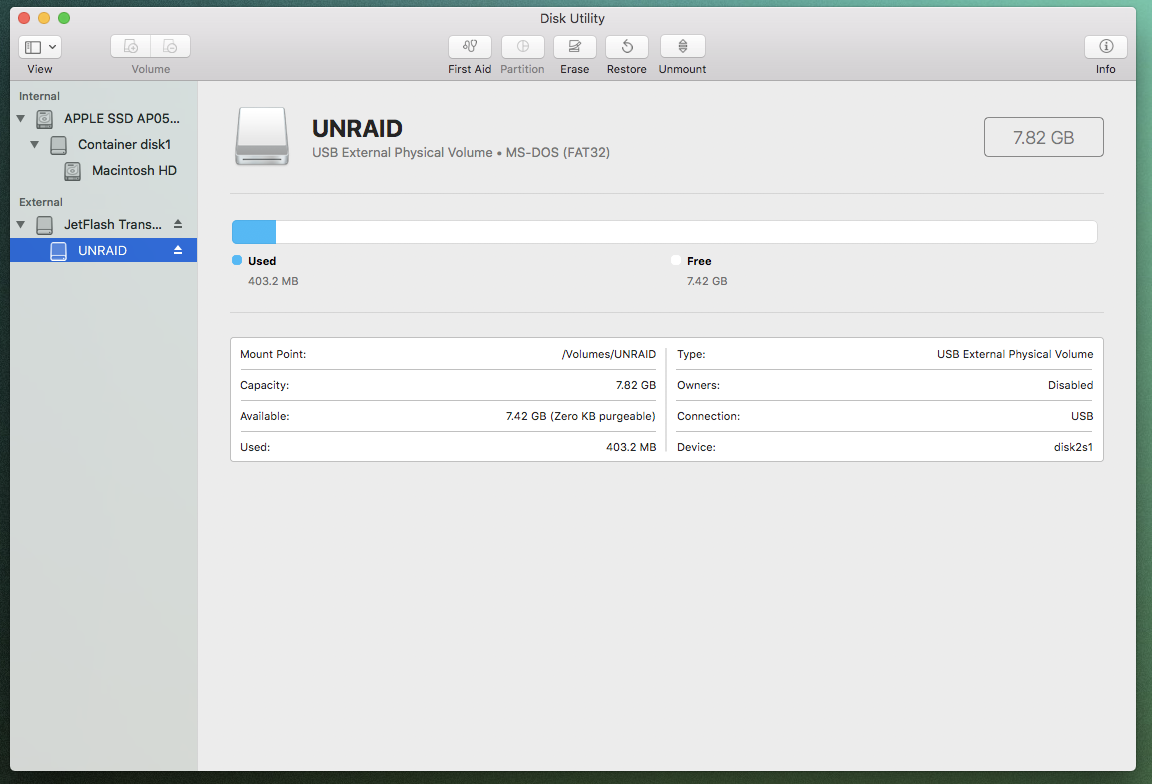

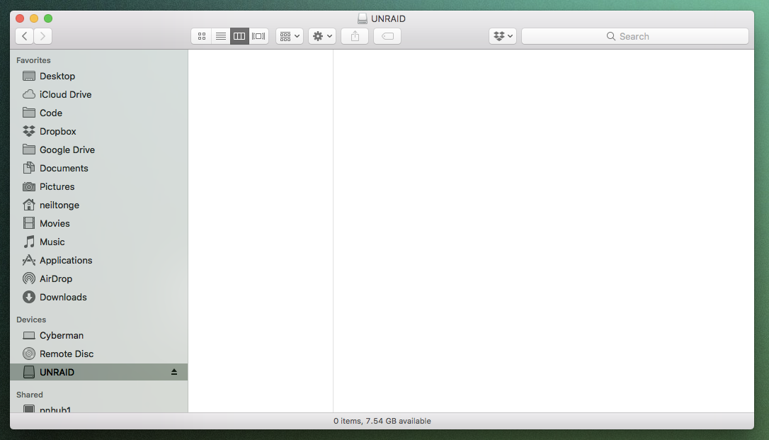

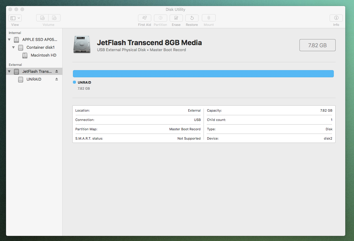

Just returned from a couple of days away and turned on my Unraid machine only to find I can't connect to it or even see it on the network.  I connected a display to it to see what is going on and it's not even booting into Unraid.  It's set to boot from the USB but not doing so.   I've just connected the USB to my machine to find that it looks like the drive is empty!
Here's some screenshots:
What I THINK COULD have happened is that I noticed that as I shut down the machine before going away, the script to backup the USB drive just started.   I'm 100% sure but could this have caused it?
Either way, any idea how I can get my machine back up and running?

If you have a backup of the config folder you can just prepare as a new install and copy the config back.
