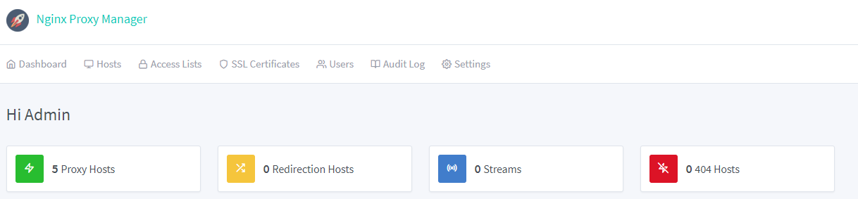

Check this out ....https://nginxproxymanager.jc21.com/
The instructions are virtually non-existent but the set up is intuitive.
Cheers
PS: I just posted up the coding to get nextcloud working on the NGINX Proxy Manager help thread.
