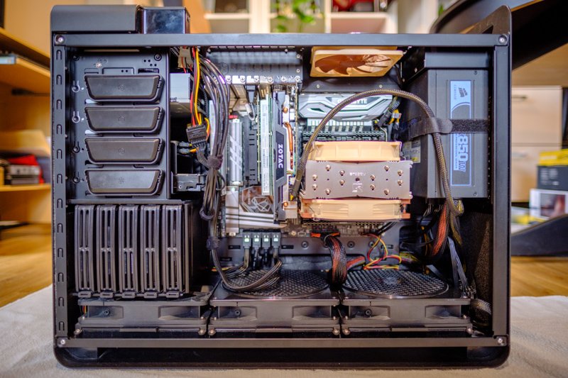

After a few months of researching, prepping my data, persuading she-who-must-be-obeyed, etc. I finally pulled the plug when Amazon finally has my motherboard in stock. I had a i7-5820K (overclocked to 4GHz) and a Xeon E3-1245v5 server (ITX case) but it was more out of necessity since I wasn't able to afford Dual Xeon to merge them and still have sufficient performance. The 2990WX came out at just the right price point that makes the idea possible.
OS at time of building:  6.4.0
OS Current: 6.9.0-beta25 (ich777 build ZFS + Nvidia)
CPU: AMD Ryzen Threadripper 2990WX
Heatsink:  Noctua NH-U14S TR4-SP3 (in push-pull - I nicked a 15mm fan from my old NH-D14 workstation cooler)
Motherboard: Gigabyte X399 Designare EX (F12e BIOS)
RAM: 64GB Corsair Vengeance LPX 2666MHz + 32GB GSkill Ripjaw 4 2800MHz (nicked from the old workstation)
Case: Silverstone Fortress FT02 (old workstation case)
Drive Cage:  Evercool Dual (2x5.25 -> 3x3.5 with 80mm fan) - need this to mount 4x2.5" drives
Power Supply: Corsair HX850 (10+ years old!)

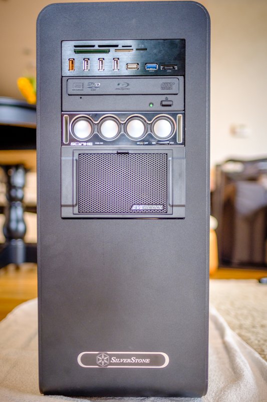

GPU: Zotac GTX 1070 Mini for main VM, Zotac GT 710 PCIe x1 for unRAID, Nvidia Quadro P2000 for unRAID + transcoding
Parity Drive: None because I trust the cloud
Array: Samsung 970 EVO 2TB
Pool 1: 2x 1.2TB Intel 750 NVMe
Pool 2: 3x 4TB Samsung 860 Evo
Pool 3: 4x 7.68TB Kingston DC500R
VM-only: 2x Intel Optane 905p 960GB (U.2 2.5"), Intel Optane 905p 380GB (M.2 22110) + 3x Samsung PM983 3.84TB (via Asus Hyper M.2 X16 card + split PCIe to x4,x4,x4,x4)
Flash backup: Samsung FIT Plus 64GB (for rapid recovery in case main stick fails)
Unassigned offline backup / decommissioned: 10TB Seagate Ironwolf NAS, 8TB Seagate Ironwolf NAS, 8TB Hitachi HE8, 5TB Seagate BarraCuda 2.5" SMR, 2TB Samsung 850 Evo, 2050GB Crucial MX300, 512GB Samsung SM951 M.2 (AHCI variety)
Primary Use: Main video/photo editing workstation + various unRAID stuff that people do on unRAID
Likes: Pretty much take anything thrown at it and spit it output in my face.
Dislikes: It's heavy AF!
Future Plans: Move to a smaller case (Raijintek Thetis?) for a more compact built.

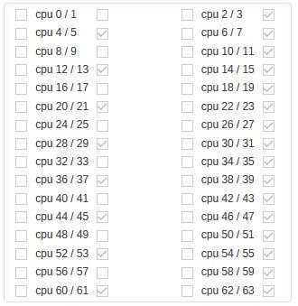

  • Windows isn't yet optimised for too many threads/cores. My testing shows anything more than 32 processes leads to a DROP in performance. The diminishing return also means going beyond 24-28 processes leads to almost no improvement in real-world performance. (a process = 1 thread/core e.g. 24 processes = 12 cores in SMT or 24 cores without SMT).
  • Due to Ryzen design (essentially gluing 2x4-core units into a die and then gluing 2/4 dies into a CPU), 24-core config performs better than 28-core, at least with my workload on Windows. 32-core no-SMT is fastest but only in barebone.
    • Perhaps placebo but I found spreading the cores out evenly seems to improve performance. I guess every 8 logical cores = 1 unit so if you have an 8-core VM for example, have 1 core in each unit.

nice rig, just curios why do you still have a cd-rom, in the age of usb images
Cuz it costs me more to get rid of it than to keep it 😆 and every now and then it does come in handy e.g. not everyone uploads wedding vid to Youtube
12 minutes ago, testdasi said:
😆 not everyone uploads wedding vid to Youtube
Neanderthals

3 Windows VM: 1 main workstation and 2 remote-only VMs.
2 Ubuntu servers as VPN gateways.
Half of the cores and RAM go to the workstation (these cores are all isolated). That's my main daily driver.
The rest of the VM has 2 cores each and some share with unRAID dockers.
I'm currently testing a weird-and-wonderful config. TR2 logical numbering is a bit different: 0+1 logical cores are both on the same physical core.
  • I assigned 24 odd (logical) cores to my workstation + the remaining 8 odd ones as emulator pin. The emulator cores are shared with the other various VMs (which don't really do much).
  • The remaining 32 logical cores - the even numbers - are distributed and shared among dockers and usual unRAID stuff.
So there's no (physical) core that is exclusively used by anything and I rely on SMT to schedule the tasks appropriately. We'll see how it goes.
1 hour ago, gridrunner said:
Nice build. :)
Thanks. :D
Innnnnteresting.
So here is a quick summary of my test results.
I use barebone SMT-off as the base (since it's fastest). The % below is slower than base so lower is better.
All tests done on Windows barebone / VM. SMT is on for VM. Nothing else is running while doing the tests (except for (8))
  1. Barebone SMT on: 52% <-- yes SLOWER!
  2. VM 1-7, 17-23, 33-39, 49-55 (28 logical cores): 33%
  3. VM all odd numbers except 1, 17, 33, 49 (28 logical cores): 36%
  4. VM first 32 except 0, 8, 16, 24 (28 logical cores): 29%
  5. VM all odd numbers (32 logical cores): 30%
  6. VM last 32 (32 logical cores): 34%
  7. VM all odd numbers except 1, 9, 17, 25, 33, 41, 49, 57 (24 logical cores): 20%
  8. VM same as 7 but with 3 simultaneous transcodes on the even logical cores using dockers (24 logical cores): 56%
My conclusions:
  • (1), (7) and (8) says Windows is badly optimised for Threadripper 2 but Linux is much better.
  • (3) - (7) seems to confirm what I was guessing. Each 8 logical cores represent 4 physical cores and thus 1 CCX. Spreading things evenly across more CCX improves performance. 3-3-3-3-3-3-3-3 is faster than 3-4-3-4-3-4-3-4!
Linux is actually great with SMT optimisation so I'll stick to my weird-and-wonderful config moving forward. :D

Below are my core assignments for the main workstation VM. I tested a lot of configs and this is the best one. The idea is to divide the CPU into 4 NUMA nodes, each node has 2 CCX, each CCX has 4 pairs of HT logical cores. So you can see for each CCX, I assign 3 non-linked logical cores to my workstation VM.
Based on my testing, you want to spread the core assignments across as few nodes as possible but as evenly across as many CCX as possible and always leave core 0 not used by anything. So for instance, if you assign 6 cores to a VM, best config is to assign 3 to each CCX with both CCX on the same numa node. The side effect of that is an odd number of cores on a node, at least based on my workload, performs worse than having 1 fewer core assigned but spread evenly.
You also might want to watch SpaceInvaderOne video on how to identify which PCIe slot is assigned to which numa node + how your cores are displayed. Mine shows 0 + 1 as a HT pair but I remember someone on the forum reported Asus mobo reports 0 + 32 as a pair. For gaming VM, you want to assign only the cores linked to your PCIe slot which has the GPU. That will minimise latency when playing (although I don't see any diff b/w gaming VM and my workstation VM, but then I use Process Lasso (to pin cores WITHIN a VM for a certain process) so that may be why).
And everything turbo to 3.8GHz automatically (all cores) and drop to about 1.7 GHz when idle.
  <cputune>
    <vcpupin vcpu='0' cpuset='3'/>
    <vcpupin vcpu='1' cpuset='5'/>
    <vcpupin vcpu='2' cpuset='7'/>
    <vcpupin vcpu='3' cpuset='11'/>
    <vcpupin vcpu='4' cpuset='13'/>
    <vcpupin vcpu='5' cpuset='15'/>
    <vcpupin vcpu='6' cpuset='19'/>
    <vcpupin vcpu='7' cpuset='21'/>
    <vcpupin vcpu='8' cpuset='23'/>
    <vcpupin vcpu='9' cpuset='27'/>
    <vcpupin vcpu='10' cpuset='29'/>
    <vcpupin vcpu='11' cpuset='31'/>
    <vcpupin vcpu='12' cpuset='35'/>
    <vcpupin vcpu='13' cpuset='37'/>
    <vcpupin vcpu='14' cpuset='39'/>
    <vcpupin vcpu='15' cpuset='43'/>
    <vcpupin vcpu='16' cpuset='45'/>
    <vcpupin vcpu='17' cpuset='47'/>
    <vcpupin vcpu='18' cpuset='51'/>
    <vcpupin vcpu='19' cpuset='53'/>
    <vcpupin vcpu='20' cpuset='55'/>
    <vcpupin vcpu='21' cpuset='59'/>
    <vcpupin vcpu='22' cpuset='61'/>
    <vcpupin vcpu='23' cpuset='63'/>
    <emulatorpin cpuset='9,25'/>
  </cputune>
